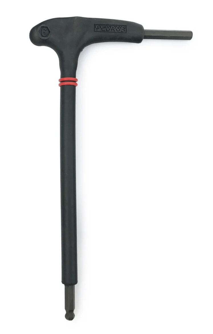

I’ve got a Pedros Pro TL II P-handle hex wrench for my thru axles. It’s about $15 USD right now.

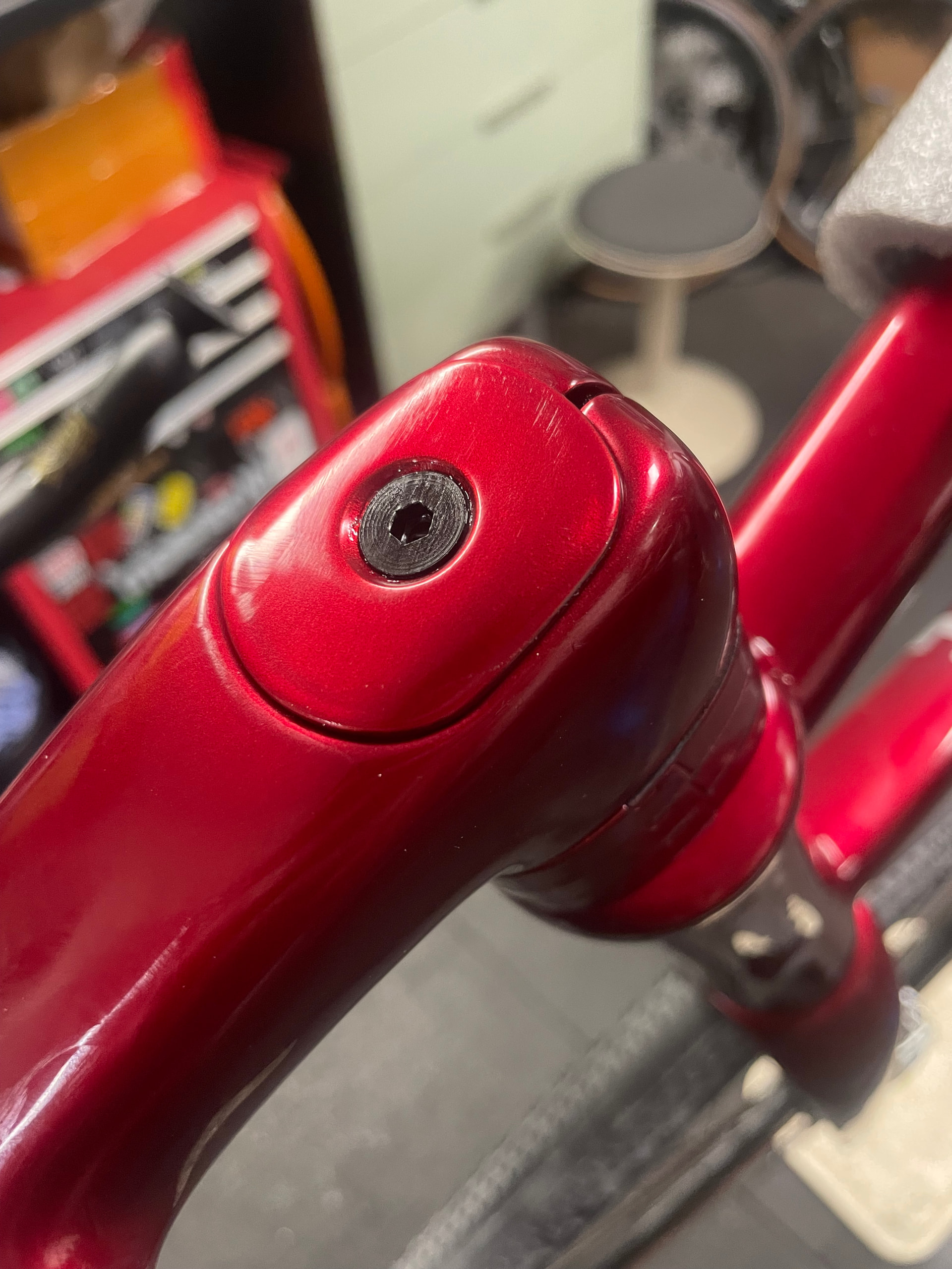

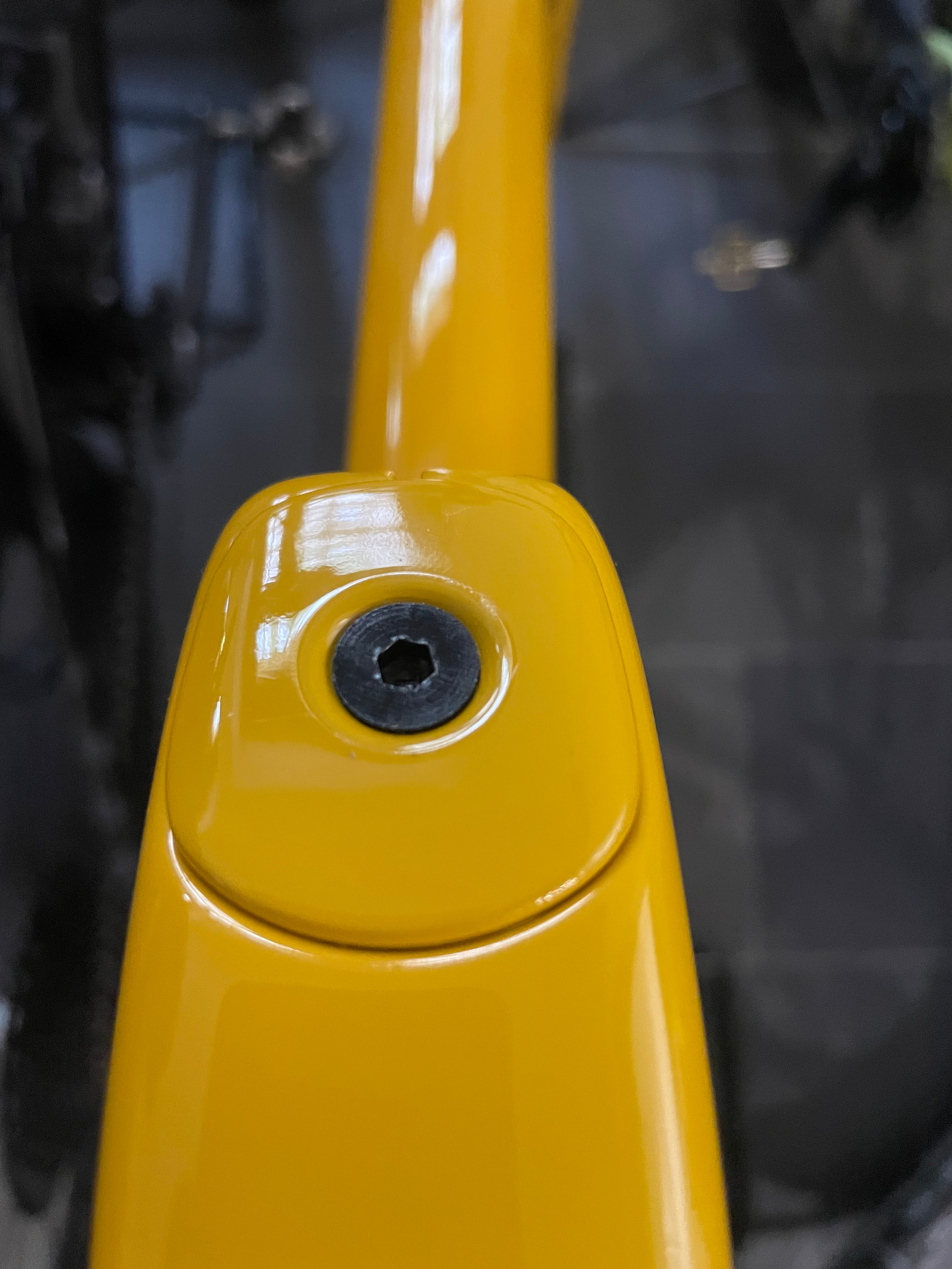

This topic coinciding with yet another build on which my Wera P-handle chewed the butter bolt in enve topcap in a single use convinced me to look into PB Swiss. I just got the P handles today and I’m surprisingly underwhelmed.

update after few weeks: I got used to the PB handles, the hex profile is indeed superior, very nice to work with. It even passed the enve top cap butter bolt test .)

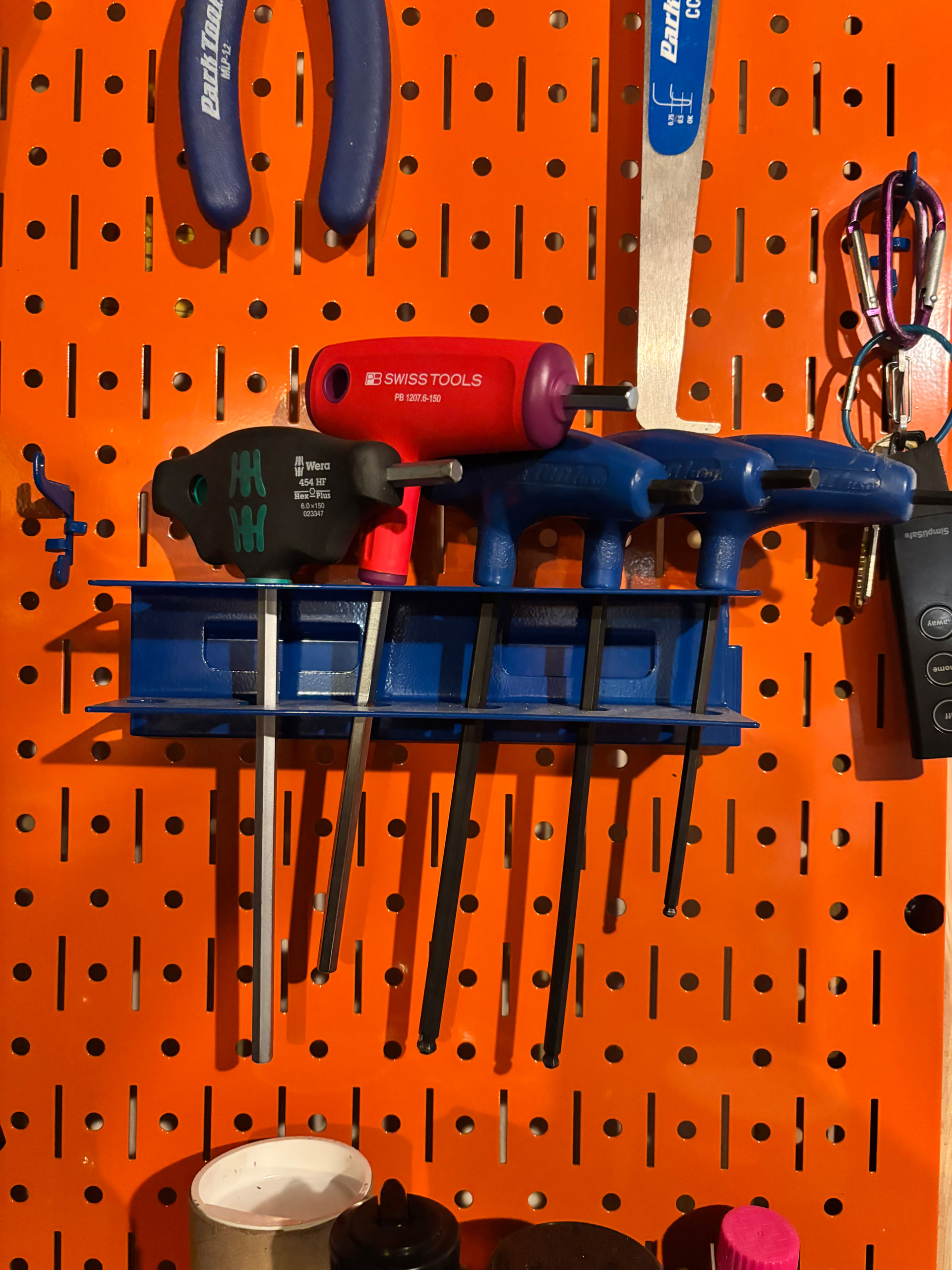

Holding them in the hand, I would say the Wera and PB Swiss are both head and shoulders above my old Park Tool hex keys (seen here). The PT has hard plastic with molding edges that would cause hot spots if used all day. The main difference in ergonomics is whether you prefer a grip with the long shaft exiting between your middle and ring fingers, which the more symmetrical Wera favors, or between your index and middle finger, which is easier to do with the PB Swiss. Only time will tell whose soft plastic handle stands up to wear. Important thing is the PB Swiss fits snugly into the new bike’s thru-axle. I’ll keep the Wera for changing pedals, when I want the hex to really bite and not slip.

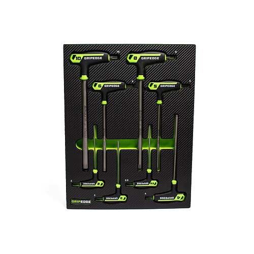

I wonder if the Grip Edge hex wrenches are a happy sweetspot between the normally shaped PB Swiss and the hex-plus shape of the Wera?
Dave Rome - you have experience with Grip-Edge. What do you think?
