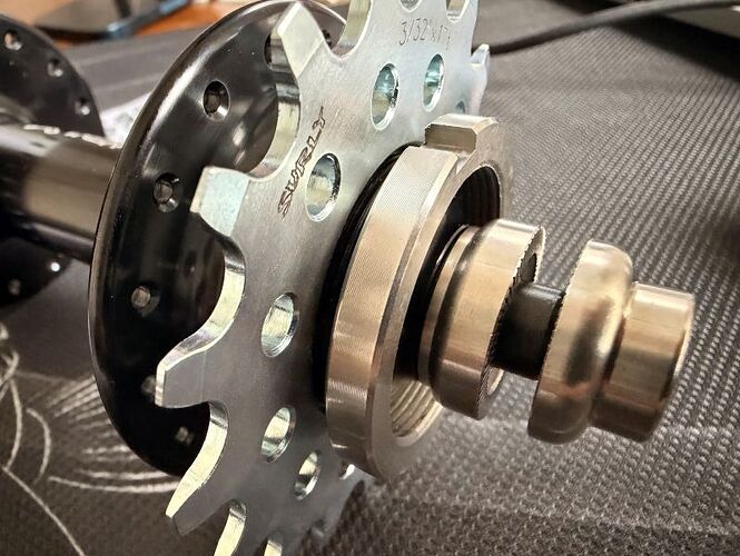

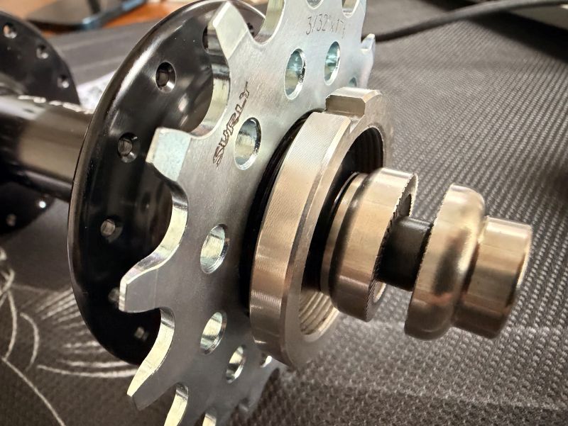

I am trying to build a fixed wheel to use for tracklocross. I’m going to put it in my Surly Cross-check with 132.5mm wide axle spacing, so I chose the Surly Ultra New Fixed/Free hub in 135mm spacing. I also bought a Surly 17t track cog, and a Surly track lockring.
This is my first fixed wheel so I have no idea what I am doing. The 17t cog threads onto the hub just fine, but the lockring doesn’t seem to fit. It threads on for about a quarter of a turn (in the opposite direction of the cog) before binding up. It seems like the lockring is either a fraction of a millimeter too small in diameter, or the thread pitch is different from the hub? What am I missing? Are there different size track lockrings?

Thanks! I was looking for documentation on Surly’s site but didn’t find this. It seems like I’m doing everything right per their instructions, but the lockring has more resistance than I’m comfortable with. I went ahead and sent an e-mail to Surly to see what they say about the situation.

Update: I went to the LBS and we tried threading on a random lockring from their parts bin. It went on just fine. I also contacted Surly support. They are going to send me a replacement lockring.
