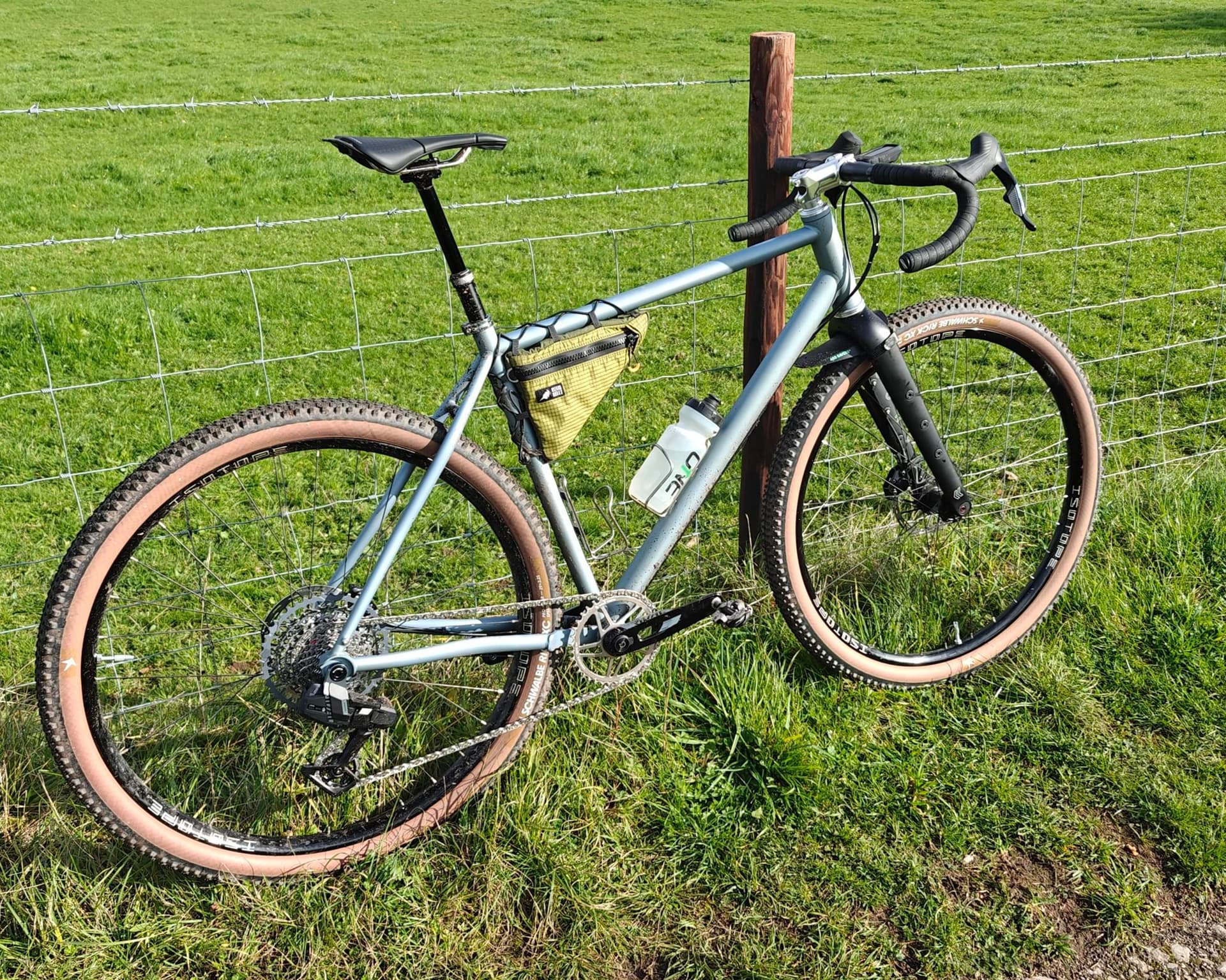

I’ve recently been through a very similar search - where I live tends to be a lot of short sections of singletrack and rough gravel mixed in with road and fields to link them up, so it can be rough going on a more road-y gravel bike and a bit uninspiring on a hardtail. Wanted something that would be significantly more capable than my old gravel bike with endurance road geo and 45s, but that I could still get into a roadlike position and push reasonable speeds on tarmac. My findings were that if you’re happy to go boost spacing or suspension corrected forks there’s plenty of stuff out there (Salsa, Cotic, Pipedream for example) but that it was harder to find bikes without those two features. Lauf Seigla and Santa Cruz Stigmata stood out but for one reason or another didn’t fit quite right for me.
Ended up going full custom and getting a Ti frame made to my own specs to get everything I wanted, but it’s loosely based on the Stigmata geometry. Have had it a few weeks now and it’s the best underbike ever! Since I started the process a few new off the shelf bikes have come out that aren’t too dissimilar in vibe - Argon 18 and the new Allied Able being the two most notable candidates, and I’d definitely consider a Stigmata based on how I find my bike with similar geo.
Here it be:
I don’t know how tall you are (I’m around 6 feet) but I’d love to see what numbers you settled on if you’d be open to sharing the geo and other details like if it’s boost or not.

6’3 or thereabouts, not boost just regular 100/142mm spacing. Fits 2.4” with some room for guards.
630 stack, 430 reach, 440m chainstay, 80mm BB drop, 70 degree HT and 46mm offset fork to give 82mm trail. Bikegeocalc was a really helpful tool to let me keep the fit I wanted from my old bike whilst moving the geo around to get the handling I was after.
Sorry to bother, but I’m wondering what handlebars those are. They seem shallow and the drops look like they extend farther back than other bars. Maybe it’s an optical illusion?
Killer bike. Might be cool to get a full run down of parts if you have the time and energy. Thanks!
No worries, they’re PNW Coasts in a 44cm. Still early days but I really rate the shape.
Might do a wee post at some point with more details but probably best left to it’s own topic! Wasn’t there some kind of Escape/CT readers rides features once?
