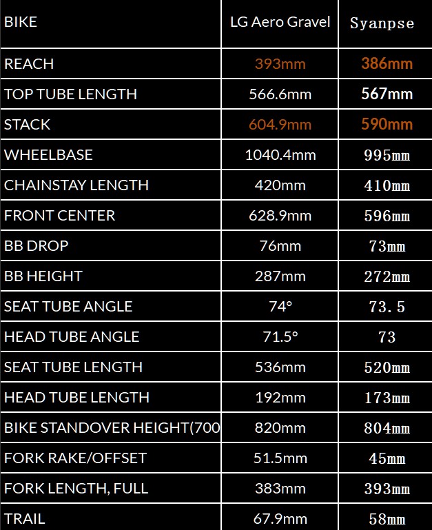

I’d love to tap into the collective wisdom here and see if we can design the ultimate endurance/training bike for under $3k.
For context, I race on a Dogma F. It’s phenomenal when I want to go fast, but after long rides I definitely feel more beaten up than I’d like. My goal is to build a bike that I can comfortably ride all day.
I found the 2019 Cannondale Synapse (40mm spacers) to be a bike that I could ride all day pain free so I’m using that geometry as my benchmark.
At the moment I’m leaning toward the unreleased LightCarbon Aero Gravel frame. Geometry-wise it seems to be the closest match to the Synapse (with 20mm less spacers), and I like the idea of having the option to throw on wider tires if I ever feel like it hitting dirt.

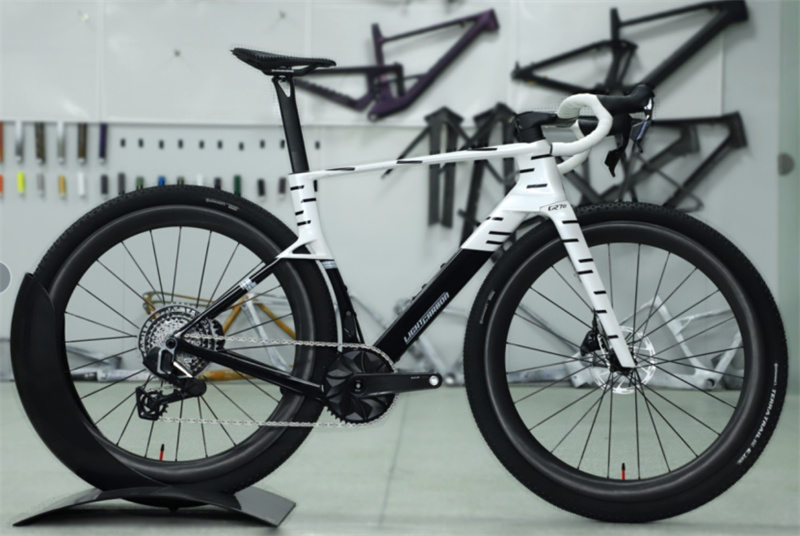

My current build idea is:
  • LightCarbon Aero Gravel frame (pic below)
  • 105/Ultegra Di2 compact groupset
  • 35 mm Continental 5000 TR tires
  • Optimized 50mm Chinese carbon wheels (looking for suggestions here, ID of 25mm+?)
Am I thinking about this the right way, or is there a flaw in my logic? Are there other frames I should be considering around this price point (sub $US1000)? And if you’ve built up one of the newer Chinese carbon frames, I’d love to hear about your experience, especially wheel recommendations.

NB. The 26’ Synapse is even closer in line with the geometry of the LG than the 2019 listed below.

Fit-wise, you need a shorter stem for the LC. https://www.bikegeo.net/ is your friend. Mind that this tool does not take handlebar reach into account.
Handling-wise, these frames are quite different, I think.
Fwiw, when it comes to Chinese brand wheels, I’m really happy with my set of LightBicycle wheels. (I think the Falcon WR series with 25mm id has in the mean time been superseeded by new rim models, though.)
Is it just the geo that lets you ride pain free all day? Or is frame compliance a part of that too? A gravel frame may be less compliant than an endurance road frame (ime) because the wide tires can do a lot. I’ve never ridden a Synapse but I think it’s noted for being quite a comfortable frame.
This, but with my point being your geo chart takes no account of stem, seatpost, and where the seat angle puts the saddle in relation to the front of the frame. The frame reach, stack, seat angle etc are important, but only in how they can play into ‘actual’ reach, stack and saddle to hoods distance.
Have you measured the position on the Pinarello and Cannondale, using the bottom bracket as the fixed point that you measure from? It’s not impossible that the position on the two are just slightly different -maybe not enough to notice initially, but enough to cause the issues you mention.
If you can, draw a wireframe type diagrams of each frame with seatpost, saddle, bar and stem, to scale - or find an online tool that will do that for you - and overlay to compare.

Good advice thanks. I’m struggling to find a Chinese endurance frame that has the kind of stack I’m looking for. It’s the only reason I thought this gravel frame would be a good fit. Might have to keep looking.
The lack of stack on the Chinese frames is frustrating. It seems like there are some pretty nice frames now but none of them have stack that would work for me either
I was looking at the Light Carbon Endurance Frame, it’s higher than the rest of the frames coming out of that market. Alas it’s still about 5mm lower than I’d like (with spacers) hence why I was looking at their gravel frame which is 15mm higher than their endurance frame.
Thanks for the wheel reco. Re bike fits, I’m well versed at this point at tweaking geometry. I sized up on the dogma to get the extra stack and run a shorter stem. Was planning on doing the same with the Light Carbon, or whatever frame I settle on.
Really?? I seem to have the opposite problem, I can’t find anything with enough reach that I can still stand over.
I wonder whether you will like the slower steering character of that LightCarbon, which after all is a gravel bike, be it of the more racy kind.
If I f.i. look at the geo of the 2026 Canyon Endurace CF, then you get a bike that’s very close to that Synapse, but with the stack that you want.
