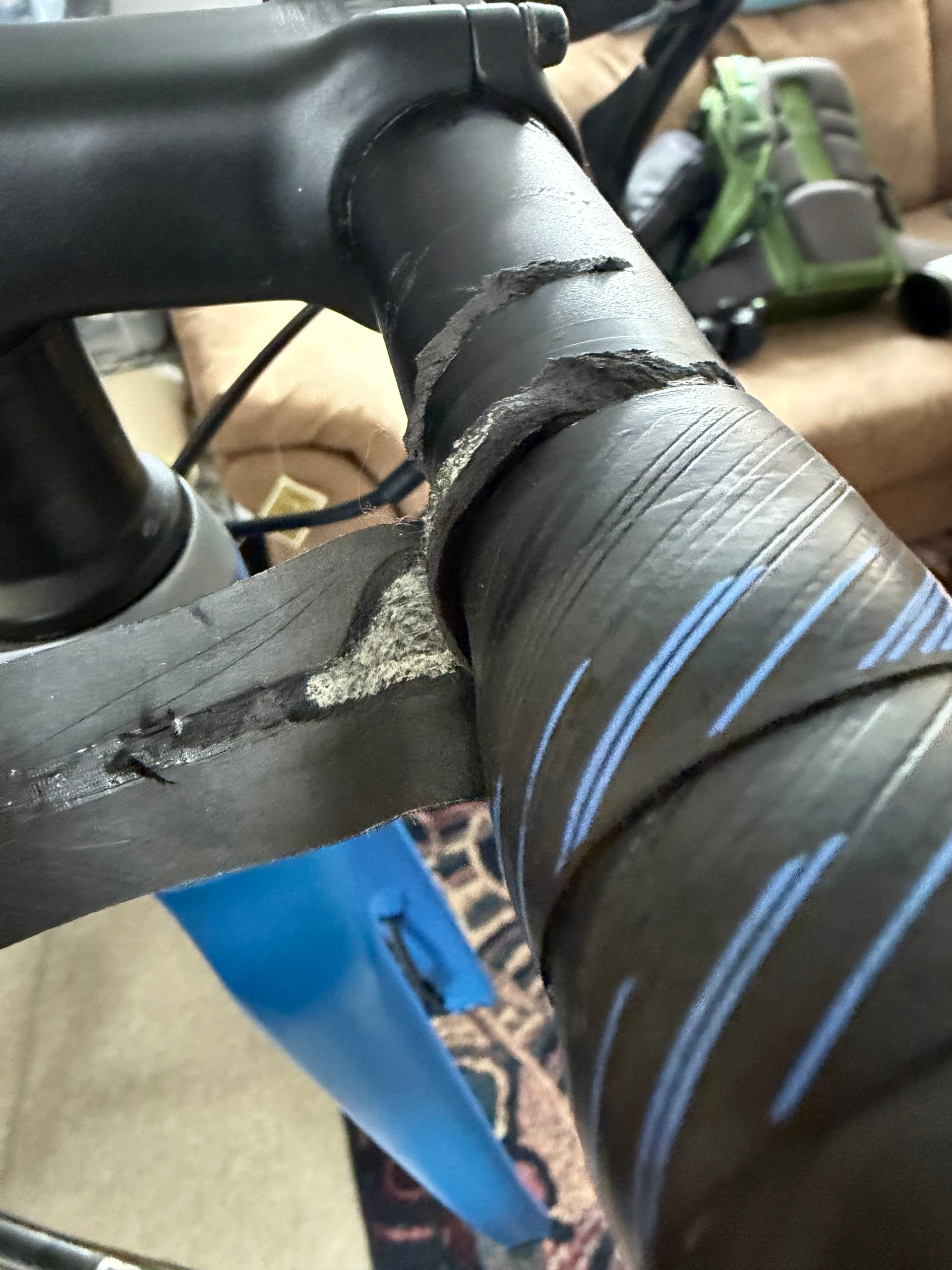

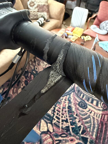

  • Extremely difficult to remove. The backing layer separated when the tape was being removed from the bar. The bits and pieces of backing material left on the bar had to be painfully scraped off and the sticky adhesive residue removed using Goo Gone.
Anecdotal Comments
  • Will not buy again or recommend this tape because of the difficulty in removing it.

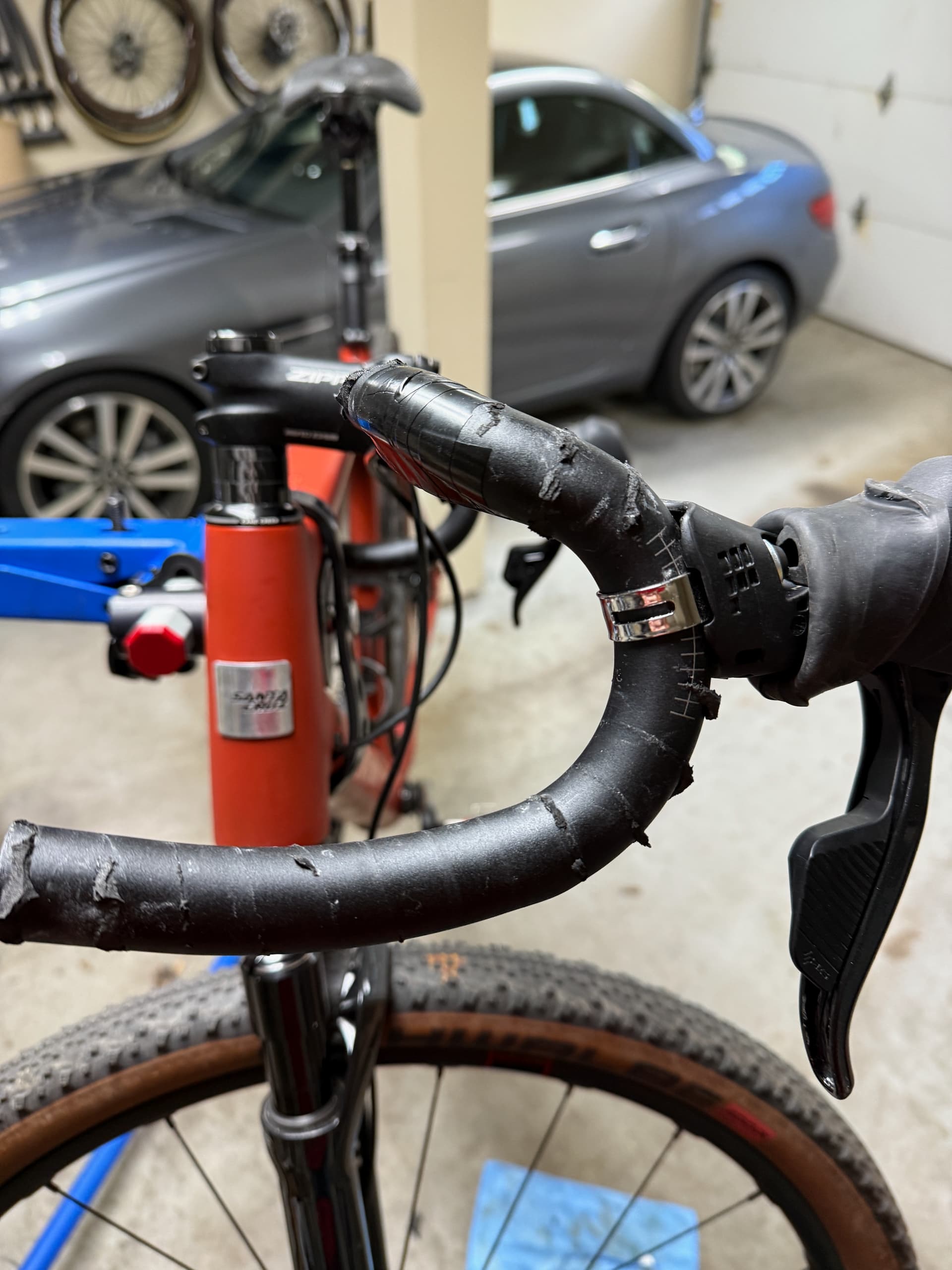

Came to the forum today to look at bar tape options, and I’ve got the exact same complaint about the Silca Nastro Cuscino 3.75. Purchased October 2024 direct from Silca, used for ~1.5 years, and the process of removing it was awful.

The remaining tape comes off pretty easily with any sort of solvent remover (like ipa) or Silca gear wipes

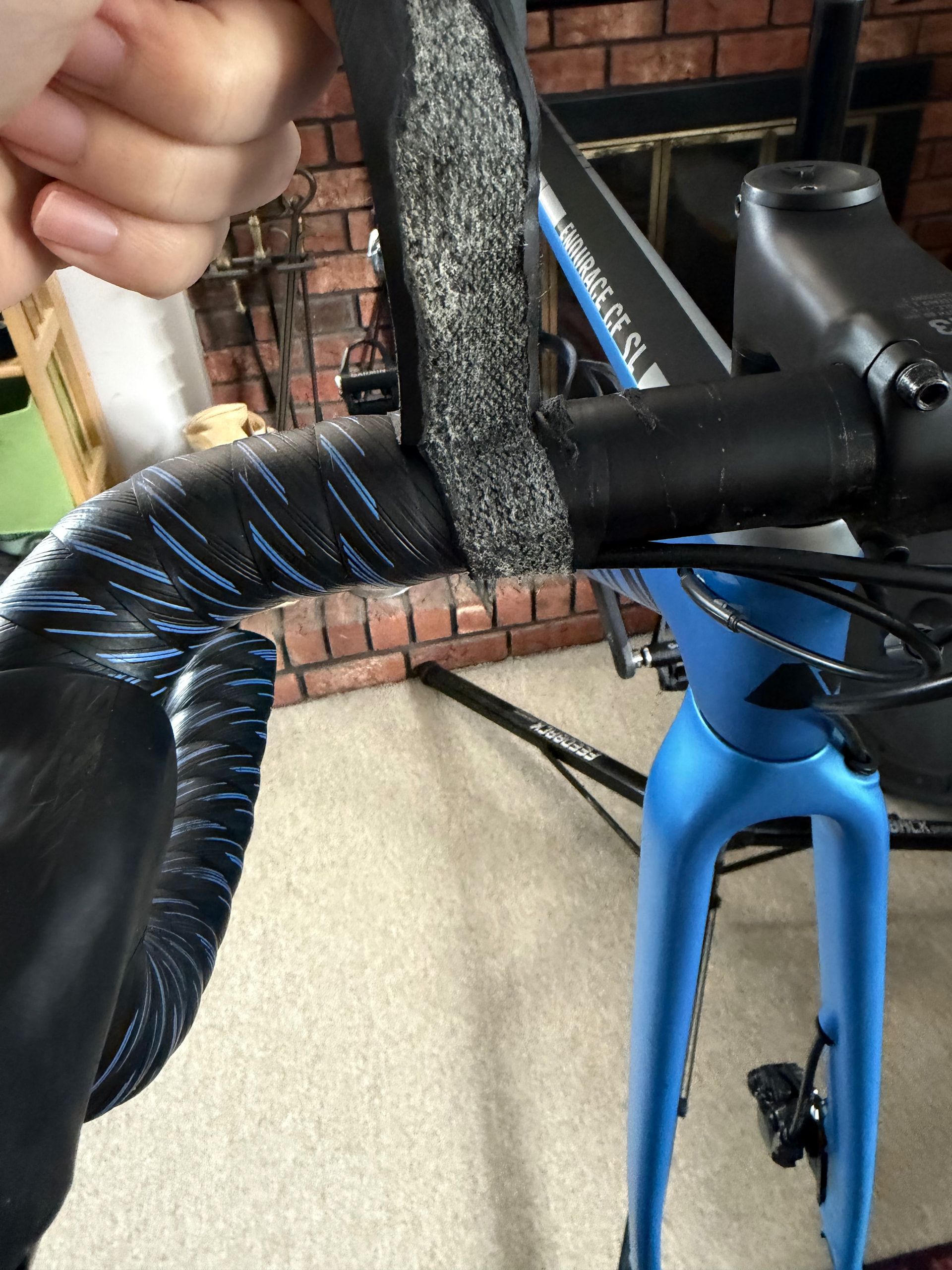

On a geek warning episode they mentioned that the Burgh tape completely disintegrates when removed. About to remove mine so will update if so.
If the Silca tape is still in decent condition, I’d keep it on the bar as long as I possibly can :laughing:. Keeping the Silca tape was not an option for me because I was swapping the Force D1 shifters to the Red E1 shifters. Initially I naively thought there was a chance I could re-use the tape if I just peel it off the bar very carefully. I knew within the first few seconds after I started pulling the tape off the bar that it was a gone case. The chunky stuff left on the bar was scraped off using an old credit card while the sticky adhesive was removed with Goo Gone after spending about 45 minutes and a lot of elbow grease.
