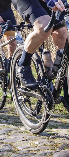

I forgot to turn mine on for the Roubaix sportive last year and had zero issues. Here’s a photo of my chain doing wild things during the Arenberg.
In short, I wouldn’t bother unless you think you’d keep it on permanently. Edit: I bet you could get the 36t cassette to work problem free on your current setup. Shimano are pretty conservative with that stuff.
