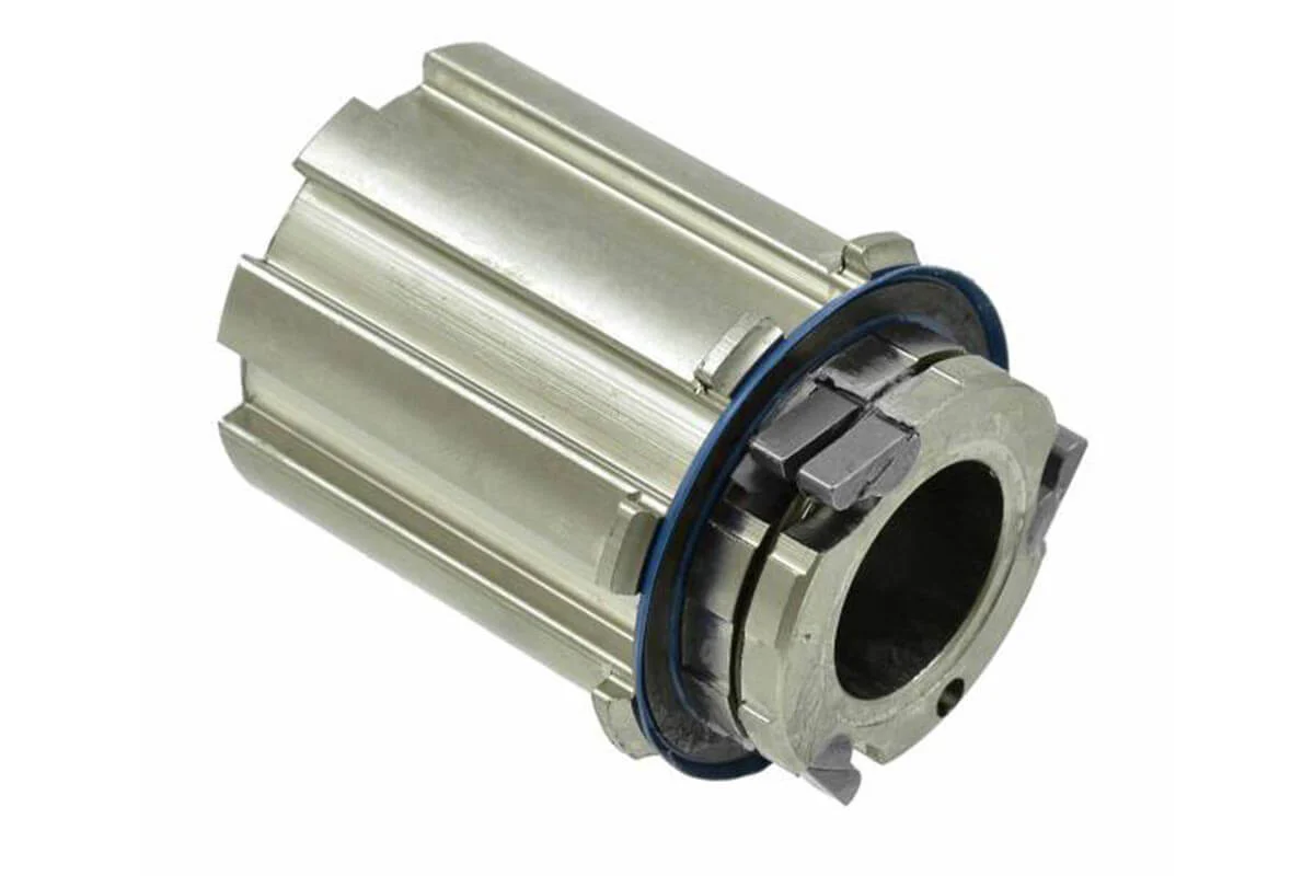

Hi all,
got a controversial question: should one grease the freehub body before putting on the cassette? Specifically Shimano HG-L freehub body. I was thought no to do so, but an experienced mechanic in my shop stands by it, saying it prevents dirt ingress and stops/delays the bite marks from the cassette digging into the freehub body.
With sram’s XDR freehub body i give it a good smear of motorex 2000 and am quite happy with the results.
Thoughts?
