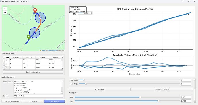

Oh, I’m measuring the aero differences between them too… kinda part of the protocol to get the diff aero values to solve really clean for rolling resistance.

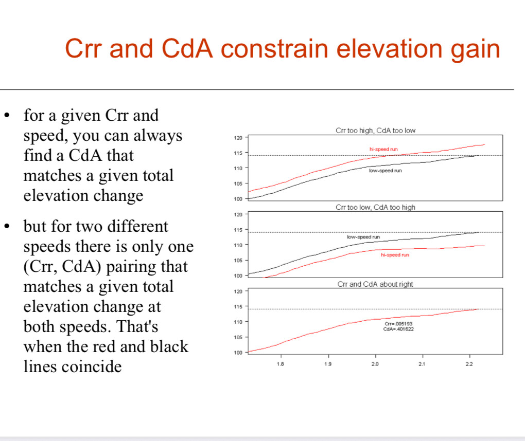

It’s not super impractical, but there is some extra care needed while testing to get it done. @Robert_Chung discusses this in his white paper… example here:
Ah good to know, thanks for the correction. In layman’s terms, as long as speed is varied enough across the run, you can tell the difference in CdA because the rolling resistance is constant?
For the record I can confirm this account is not DJ.

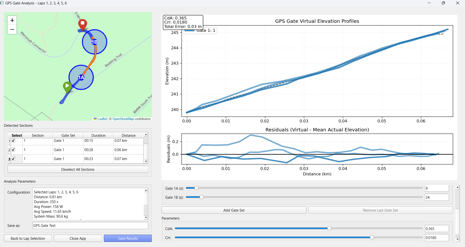

yeah pretty much. Both should be constant, so then the power and speed variation mainly on uphill parts helps to find a unique pair of both values that matches the repeated efforts to the actual elevation profile (1 meter DEM in tiff files)
this is a good example from a test I did a few weeks ago.
