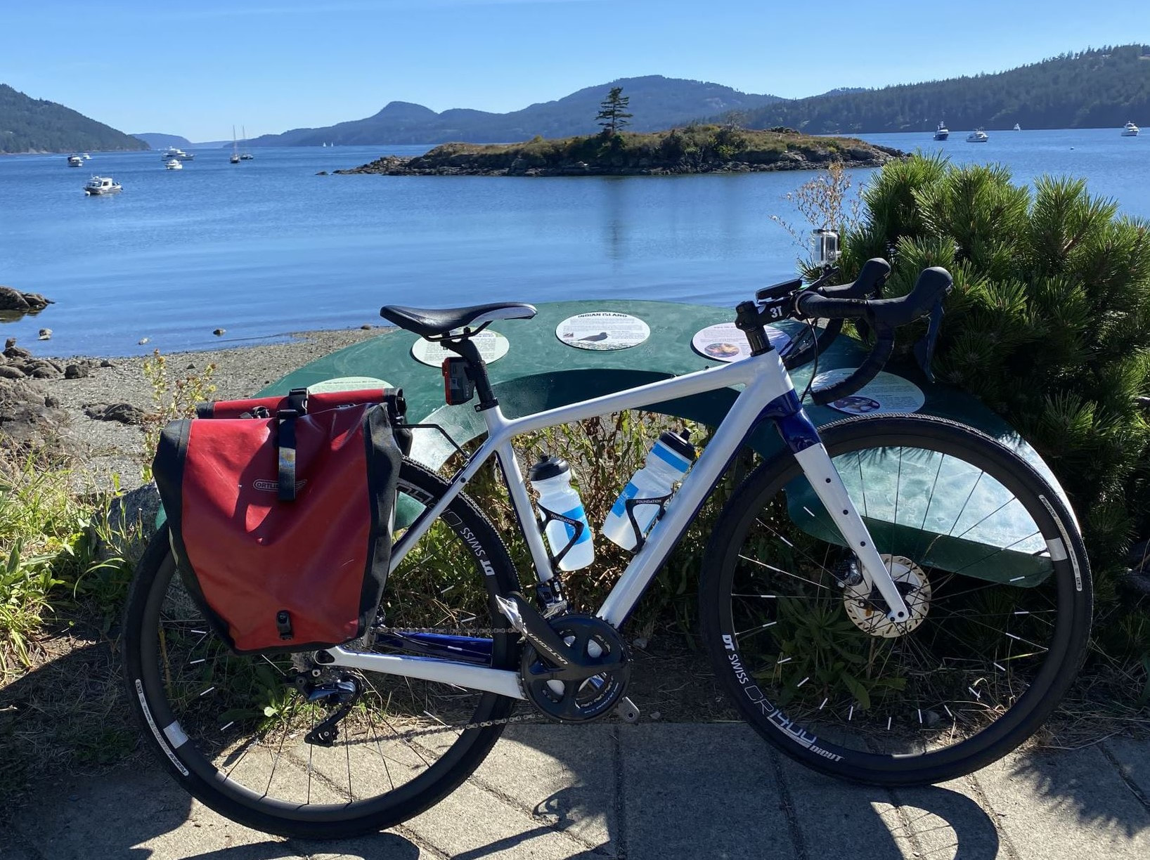

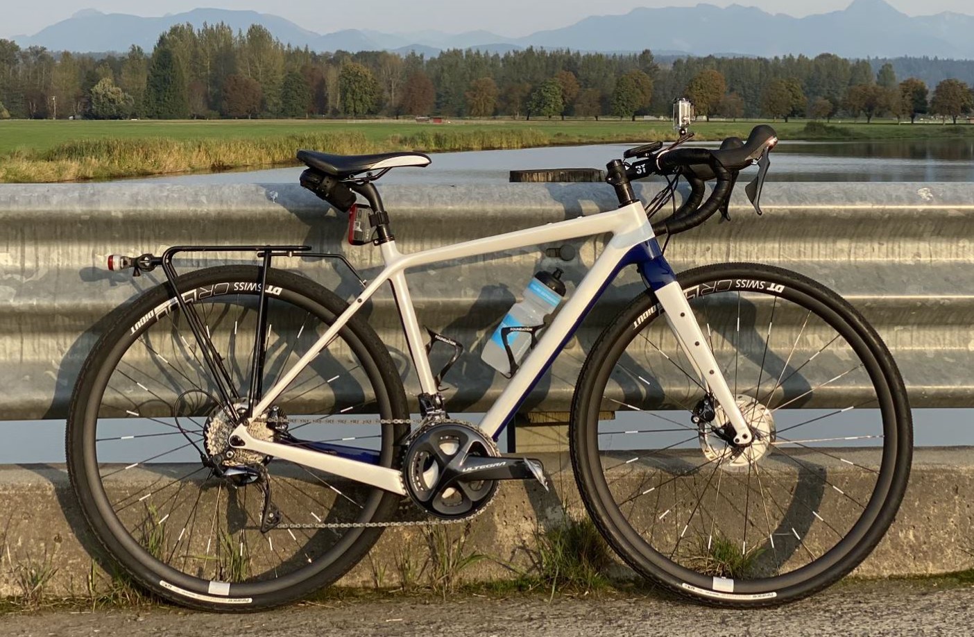

I’m 60, previously only a road rider on a Giant TCR. I took the plunge and got a Specialized Diverge 4 about 3 months ago and I love it. My one has Shimano GRX manual and came with DT Swiss aluminum wheels with 45mm tyres. It’s covered in mounting points for luggage and bottles, and so far has been bulletproof. The future shock front suspension definitely helps on rougher tracks, and the bike is fine for some road riding I do to join up the trails.
Gearing: I’ve got a 2x setup with a 46-11 top gear(roughly equivalent to a 42-10), and the only time I’ve spun out was on a fast group ride. I’d think a wide-range 1x setup would be fine for his intended use.

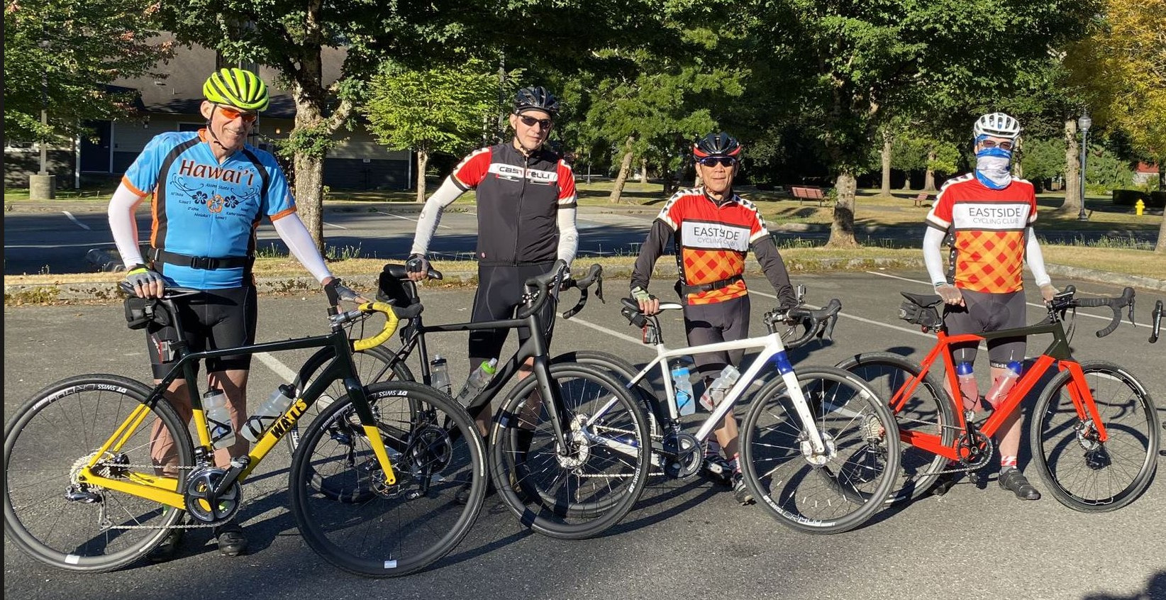

Not to make the choices even broader, but depending on you and your father’s comfort in wrenching your own bikes, there are some nice open mold frames that could enable a bike to be put together exactly the way you’d like and want. As an example, just before COVID, I had seen that the exact frame which companies like Ridley and Ocoee (now Obed) used for their gravel bikes could be ordered direct from the manufacturer in Shenzhen. I actually ended up rounding up 12 of my riding friends to go in on a group purchase, and our original group was happy enough with the result that I helped another 6 guys a year or so later do another group buy. While the cost of the frame direct from China was probably about a third the price of what the brands wanted, I didn’t necessarily save a ton of money - the benefit was more getting the exact bike you want - groupset, contact points, wheels, etc. - rather than what some big brand product manager spec’ed to hit a price point in a lineup. As an example, we all ended up with a range of colorways on our frames - some guys wanted to go stealth with just the clearcoat on the carbon, while others went all out with fancy fades and/or unique branding (one of my friends used the same font as the big S but spelled out “GENERALIZED”).
A subset of the finished bikes from our original group, and my bike below that:
