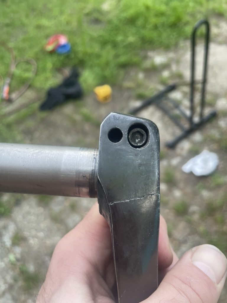

Turns out, I needed a new crank anyway, I hit stairs with my crankarm last Thursday or Friday and this happened:
Hence, my XTR M9000 crank is toast. It was good, because this way I could tell my wife I replaced the crank because the old one was broken — and not because I wanted a power meter on my hardtail and I didn’t like 175 mm cranks and wanted to switch to 165 mm like on my road bike.

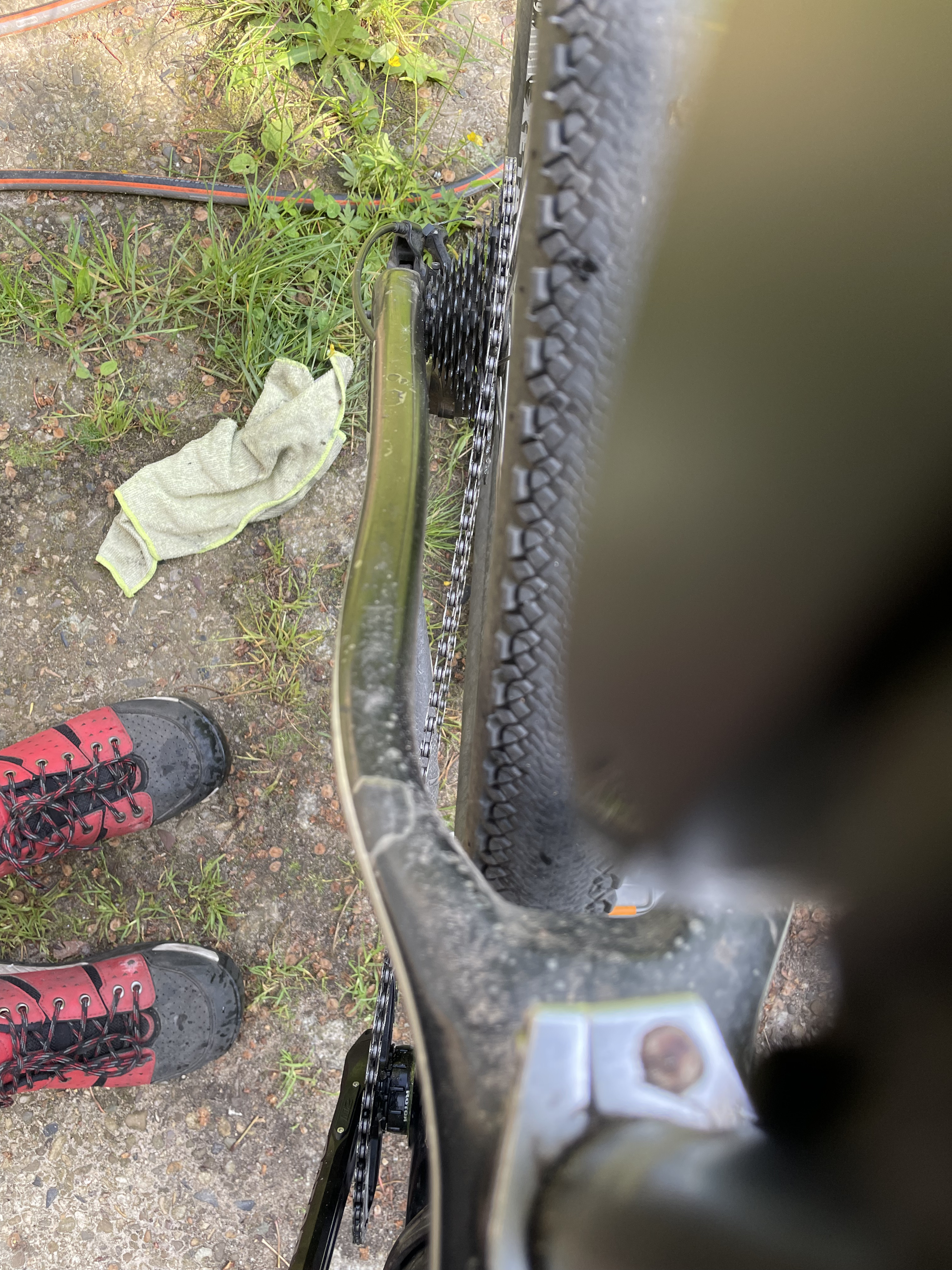

The one strange issue is that the chain line sits much more outboard than with the native XTR cranks:
It gets very noisy and it doesn’t seem, hmmm, whatever the polar opposite of ideal is. Is my chain line too extreme? I cannot remove any spacers on the drive side, I have only included a 0.5 mm plastic washer to protect the BB from rubbing against the crank.
What’s going on? The cranks is marketed as being compatible with 11- and 12-speed drivetrains. I have an 11-speed Shimano drivetrain.
