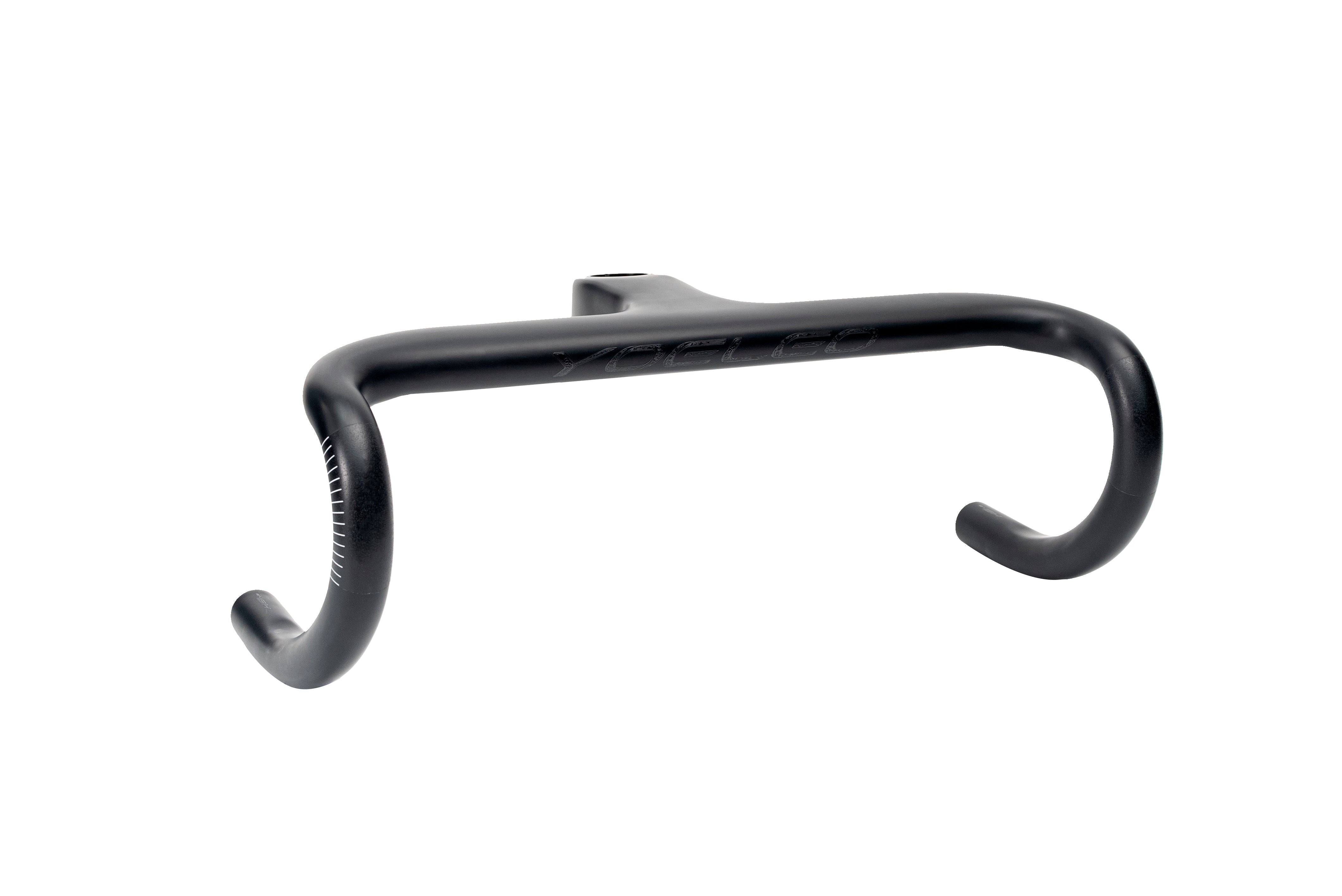

If it’s not the one he already has, maybe look at a Yoeleo H9.
I have one on my bike (with external cable routing) and it’s been great. Comes in 1.25” steerer version.

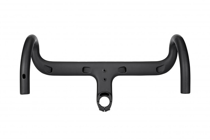

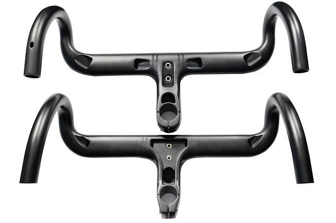

For the Giant, you may be able to run the cables out of the underside (there are two sets of holes, under the stem and under the bar), either might work?
that underside image may be out of date… there’s also this as possibly the current version:
