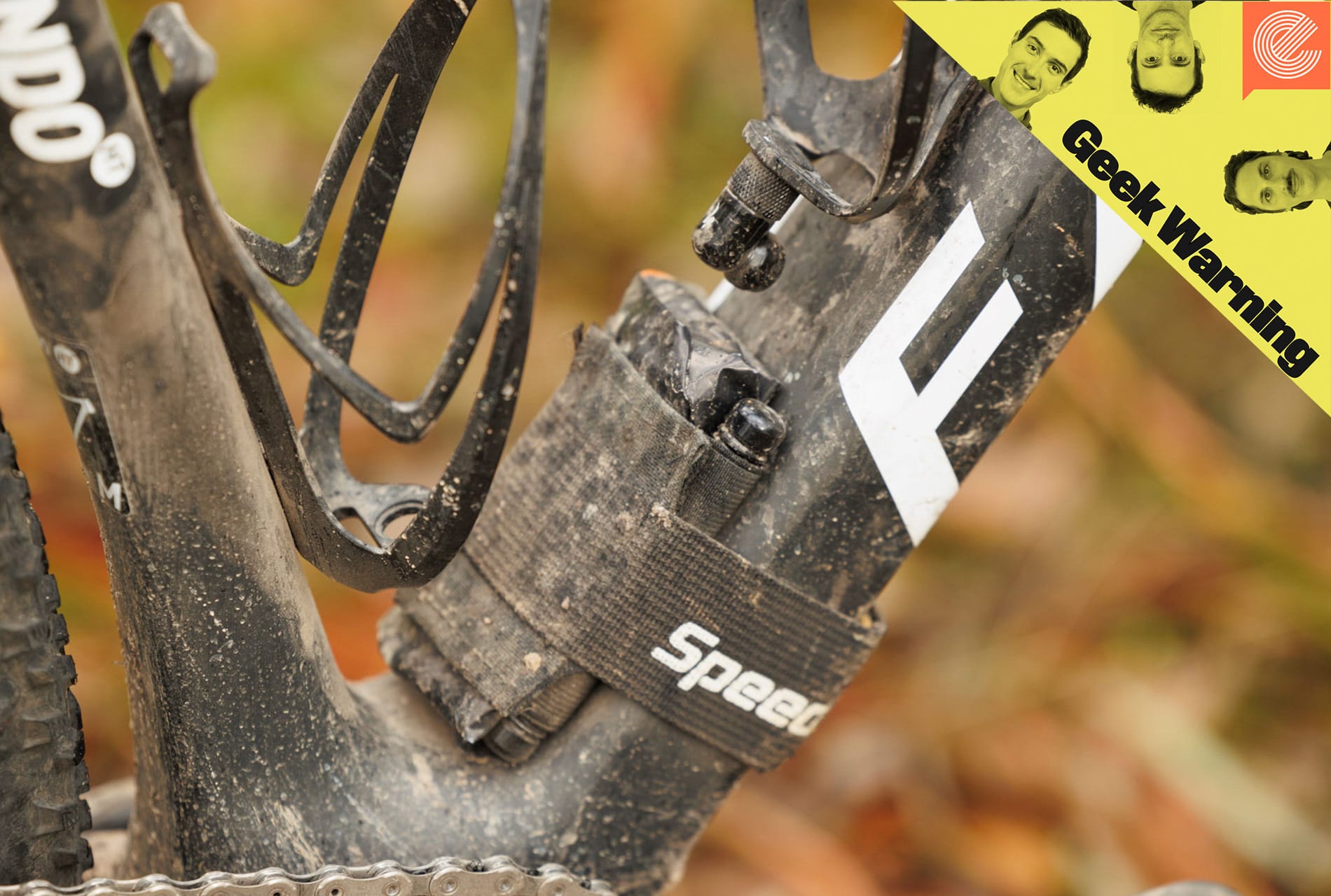

  • Forx ‘Switchback’ frame strap with TPU tube, 1x CO2 canister, and a Bar Fly Air Lever (CO2 chuck & tyre lever in one)

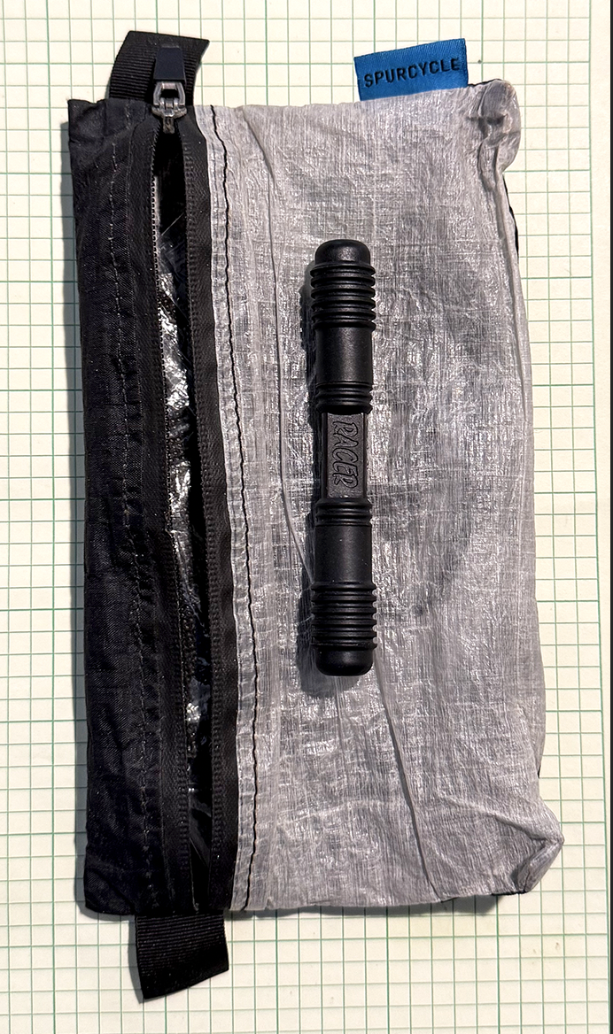

I actually chuck it in a bag in my rear pocket. Spur Cycle used to make a waterproof pouch out of sail cloth in which you could put things like a phone, money, ID, or whatever you wanted. I keep my Dynaplug Racer in that along with my phone, cash, etc. I thought about putting it in my saddle bag, but the saddle bag (Orucase Saddle Bag HC, the smaller version) is a bit smaller than Silca Mattone and is pretty full. Moreover, if I get a puncture not fixed by sealant, it’s easy to get the Dynaplug out. I thought about using the Dynaplug mount, but I wanted to be double plus sure that I wouldn’t forget it or lose it. Plus, given how little I keep in that bag, it’s easy to quickly grab the Dynaplug.
