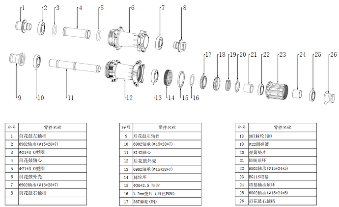

Sounds like you didn’t install the spacer that goes between the bearing and the freehub body. Without it the freehub seizes into the hub body/bearing and makes it seem like a fixie.

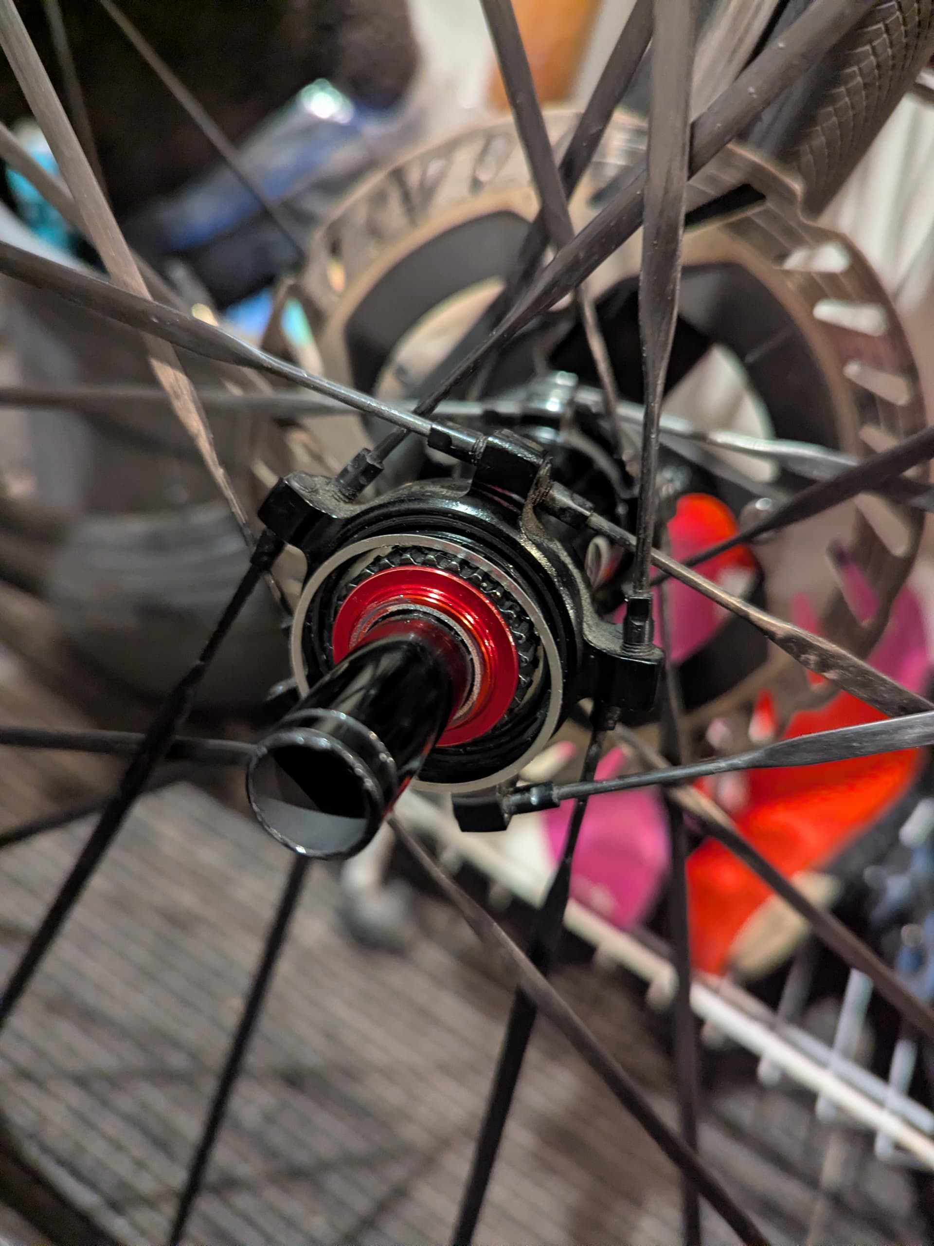

So, the cassette is fine tightened. But when i put it back into the frame and tighten with the thru axle, it stops spinning. I found the silver ring and tried to attach it before i put the free hub back on, but it’s too loose and moves off. I can’t figure where else it goes…
There’s an end cap that goes on the end of the axle after the cassette is installed, before the wheel goes back in the frame. As someone mentioned earlier, are you installing that before putting the wheel back on? Does it go on smoothly and without resistance?
If you’re talking about that silver ring in the picture (the one around the “sleeve”, that should be the spacer that goes over the freehub body first, before you start putting on the largest cogs of your rear cassette.

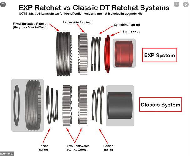

Also, I could be wrong (can’t really scrutinise the components from the angle of the image(, but check that the spring seat is in the correct orientation.

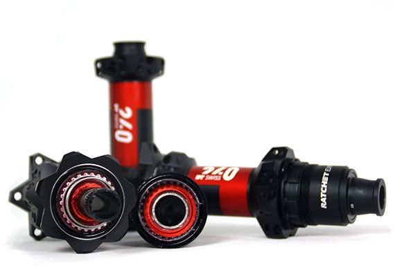

Another shot of the 240 EXP hub…
BINGO! I emailed panda podium for some advice on this wheel and they showed me a diagram. After looking at that, I was suspecting that I put in the spring seat backwards. I haven’t had time to check to see if that is the fix, but I’m sure it is. Thank you everyone!
