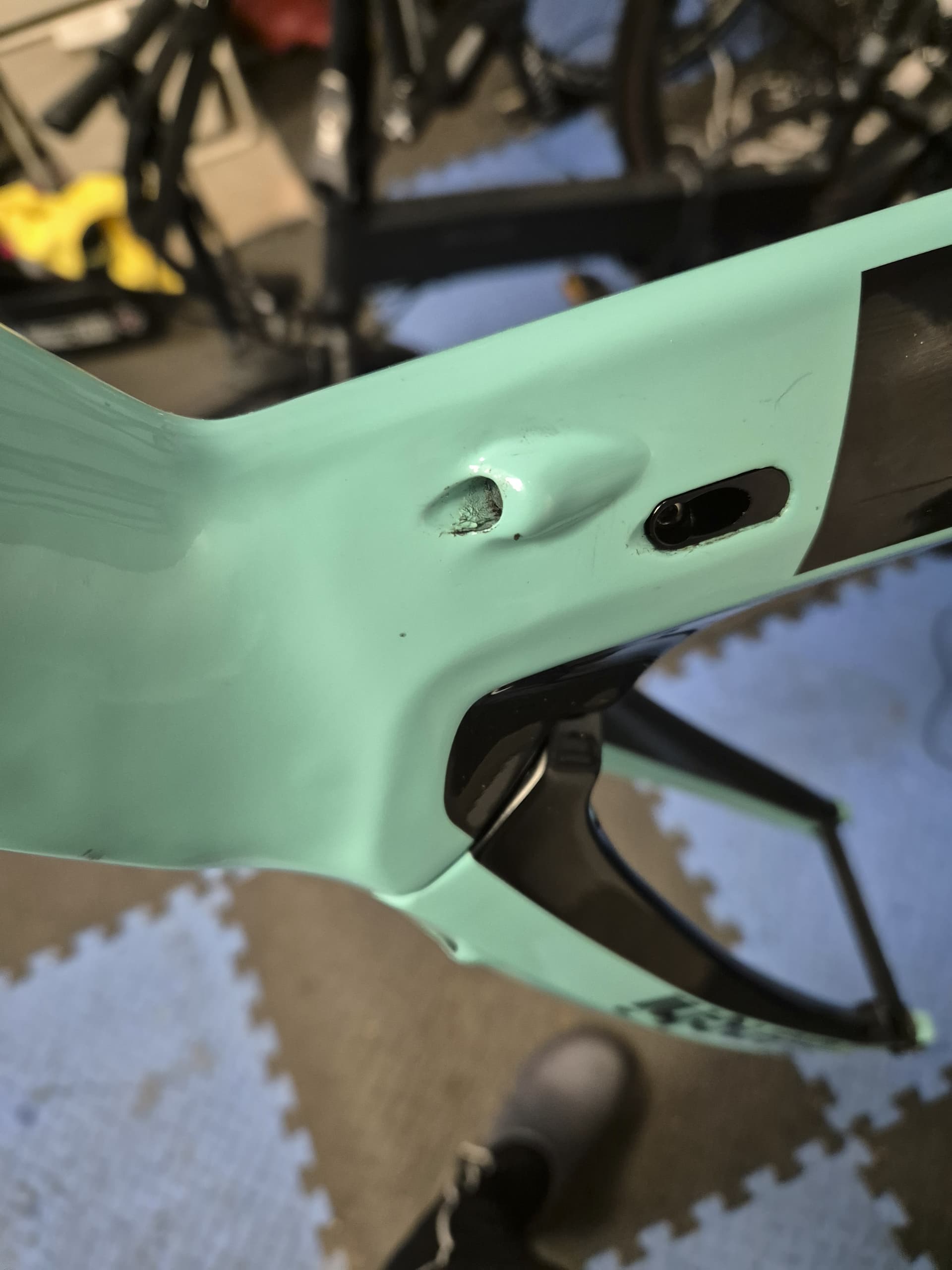

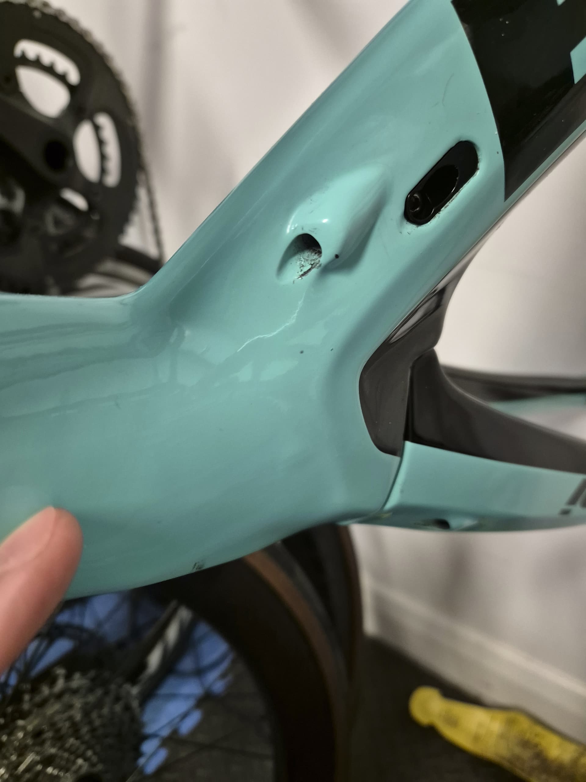

I’m building up a used Bianchi Infinito. The frame didn’t come with grommets for the brake hoses. I’ve reached out to Bianchi about the part I need. I was wondering if anyone knows of a ‘generic’ option for an angled frame port like this. I attempted to measure the diameter of the hole, which is 7-8mm by my best measure. The holes look the same on the downtube, chainstay, and fork.
I would like to think bike shops have a bunch of these spares lying around, from various bikes, and with some trial and error they’d find some that work. May take a couple visits to a couple shops, but I’d guess that’d work. I’ll be curious to hear from shop staff here if that’s indeed the case…
Also wouldn’t be totally surprised if some company like Jagwire sold a kit (to shops) with a bunch of spares of various sizes….
As a last resort, this is definitely something creatable on a 3D printer.

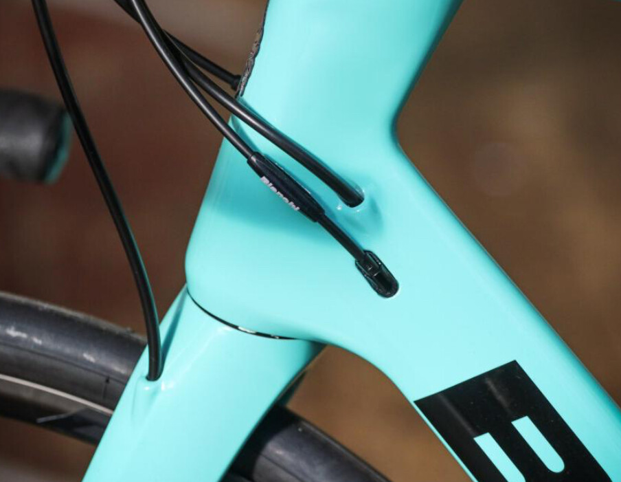

No grommets originally, the hose just passes straight through into the downtube. I’ve no personal experience with the Infinito but had a similar setup on a Scott Addict. Only thing to note is that it’s almost essential to feed some foam tubing over the hose to eliminate annoying rattling inside the tube. Jagwire sell this as Housing Damping Foam.
That would explain why I can’t find any. Thanks for the pic.
