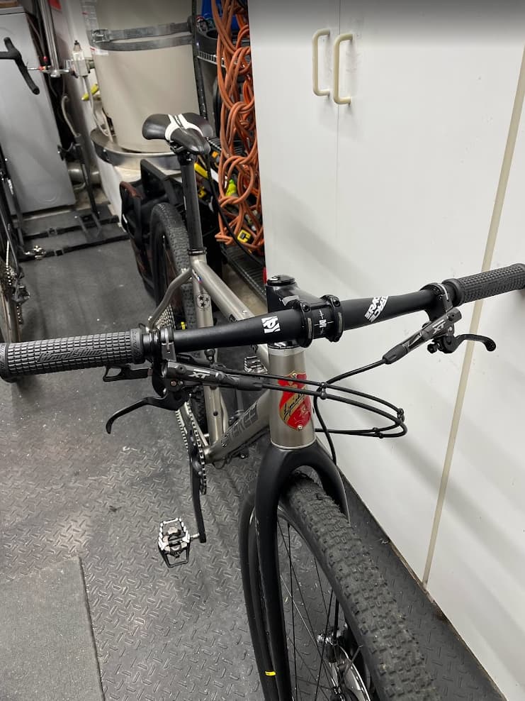

Photo of the topstone in question!

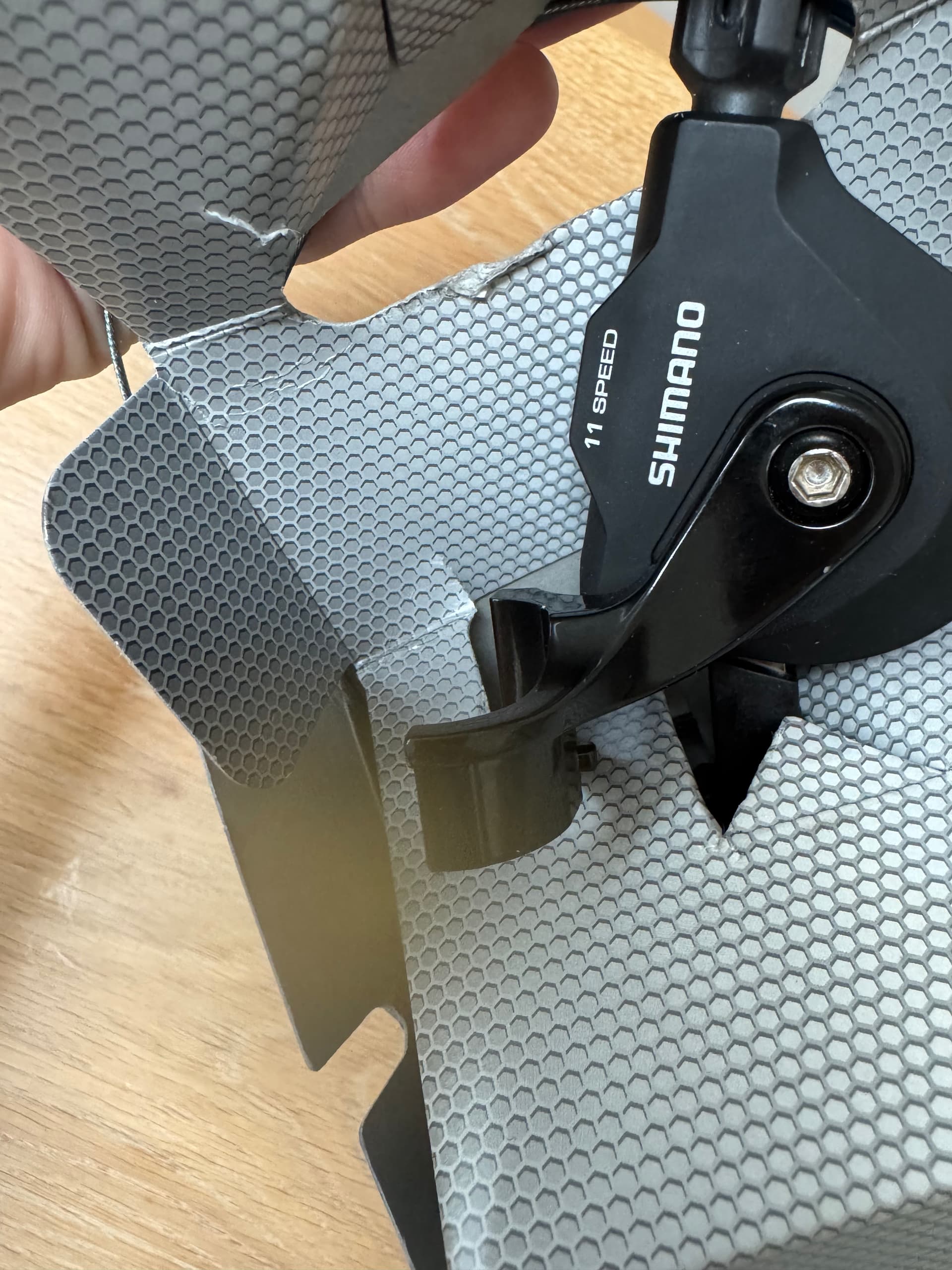

Next problem…. Shifter has turned up and it’s I- spec 2 :roll_eyes: the band on one is out of stock everywhere in the uk.
Will i-spec 2 that looks like this picture be workable with I spec ev deore brake lever?
Shimano won’t say officially that I-Spec A/B/2 are inter compatible with I-Spec EV, but I’ve had luck getting them to mount to EV clamps by using a spare brake rotor bolt, rather than the longer bolt that I-Spec 2 components use.
thanks , yeah what wierds me out is that this is the ‘tuck it under the brake lever clamp’ style of mount rather than the bolt in version that the mtb’s have. :thinking: I will have everything turn up tomorrow and can just test it out! :crossed_fingers:
To follow up, the I spec 2 shifter above is nowhere near compatible with I spec ev deore brake lever. I have successfully installed and bled the brakes but have a Band on shifter being delivered tomorrow before I can finish
