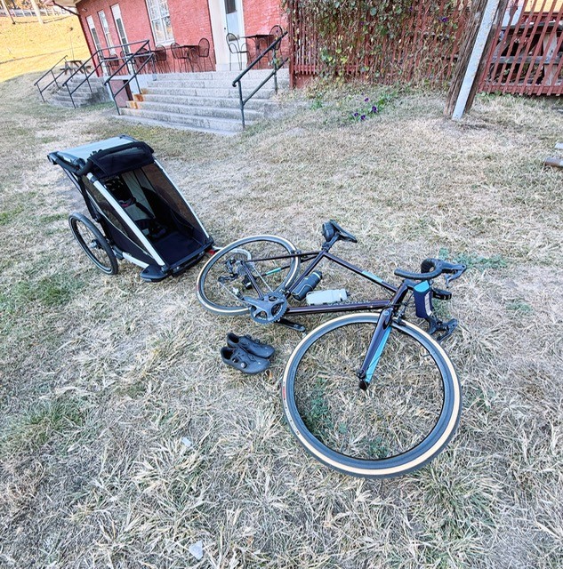

My youngest is about to turn eight, but they all (three kids) spent some time in a Chariot and the youngest also experienced a Shotgun front seat. Chariot was cool for me, and they would fall asleep in it but you can tip it over… so be careful. My youngest still talks about the Shotgun, but it’s heavy going. If you don’t have one already I would suggest an e-bike would make these experiences so much better. I didn’t, but would have ridden with them a lot more if I did.

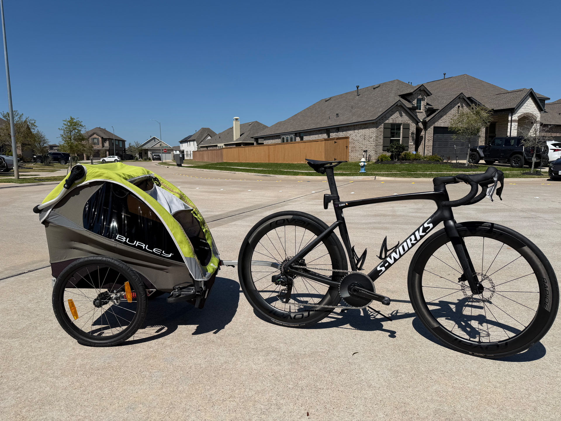

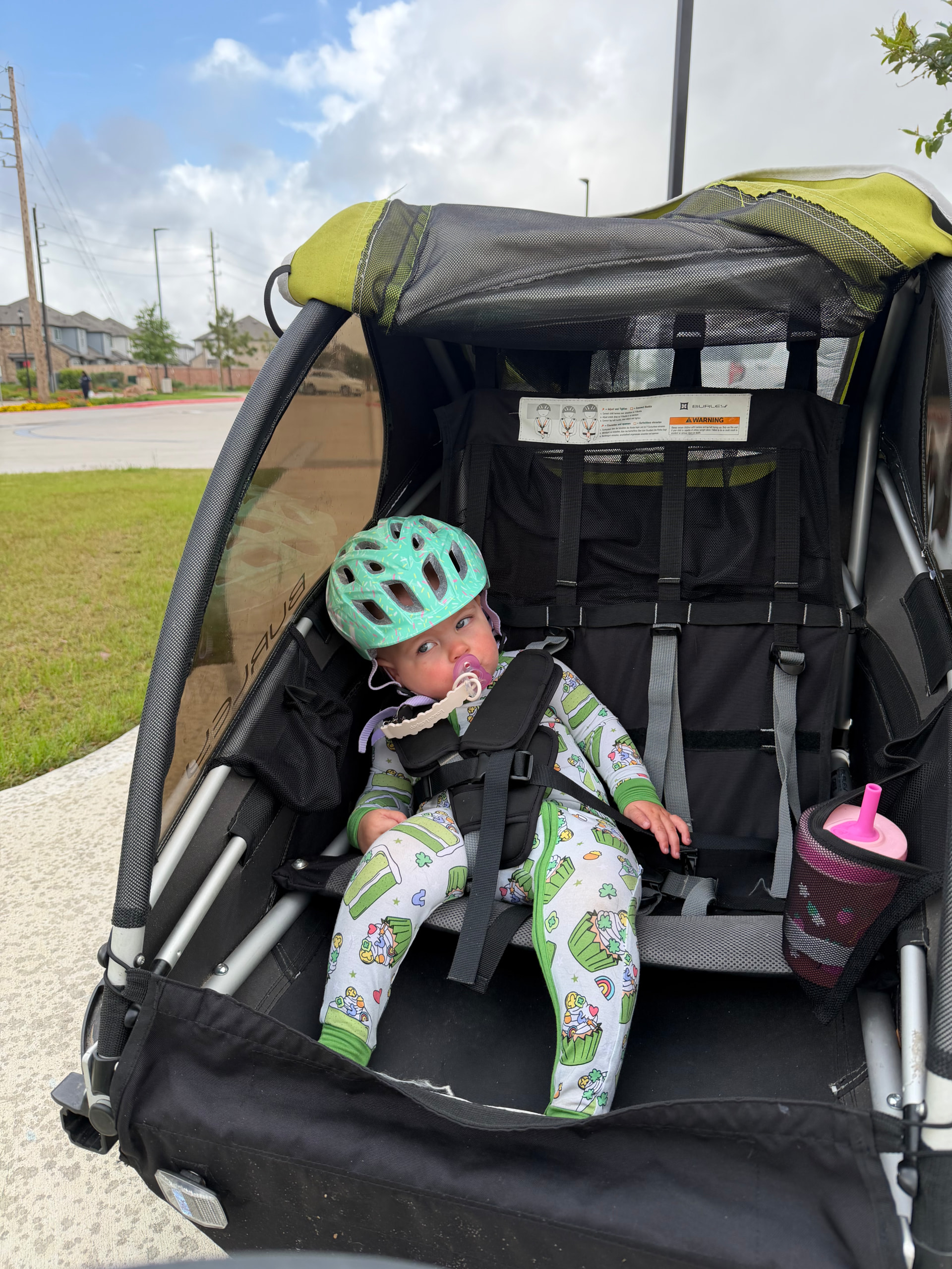

I ended up getting a ~10 year old Burley D’Lite X from a club member for $50 and so far we enjoy it! I can still hear my 15month old while cycling if something isn’t going well or she’s uncomfy. Towing the trailer isn’t too bad but definitely noticeable. I’m not sure if she needs a helmet but better safe than sorry even with the 3 point harness and a lap belt. Looking into a gravel or mtn bike to pair with the road. I would prefer a gravel with a shotgun option when she gets older.
Any fall for a kid in a bike seat carries a heightened risk of injury. They are falling from a higher distance and lack the capabilities to protect themselves.
Trailers are basically roll cages for them and will often stay upright, even if the bike goes over.

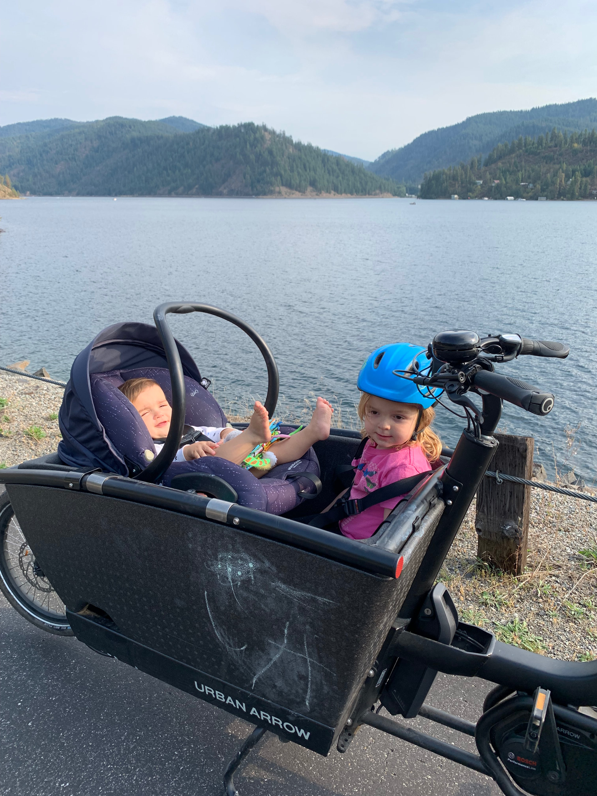

We have the Urban Arrow cargo bike, which is sweet, and I’m currently testing a Tern Quick Haul Long, which has been good now that both kids are a bit older. Chariots are fine but really suck your will to live uphill. The shotgun/macride is my son’s absolute favorite but hurts my knees after a while.
I have an Urban Arrow like Caley and absolutely love it, as do my kids. It’s pretty expensive, but would say it’s the most enjoyable bike I’ve ever bought. I got it when the older one was 2 but the little one started riding in it at 6 months using the car seat adapter. They are 6 and 3 now. I made some DIY attachments to carry their bikes with us places. I did a pull behind my bike for about 6 months before buying this. Having them right in front of me makes it much easier to hear them and talk about the ride and things we see and I also feel like they are a little safer

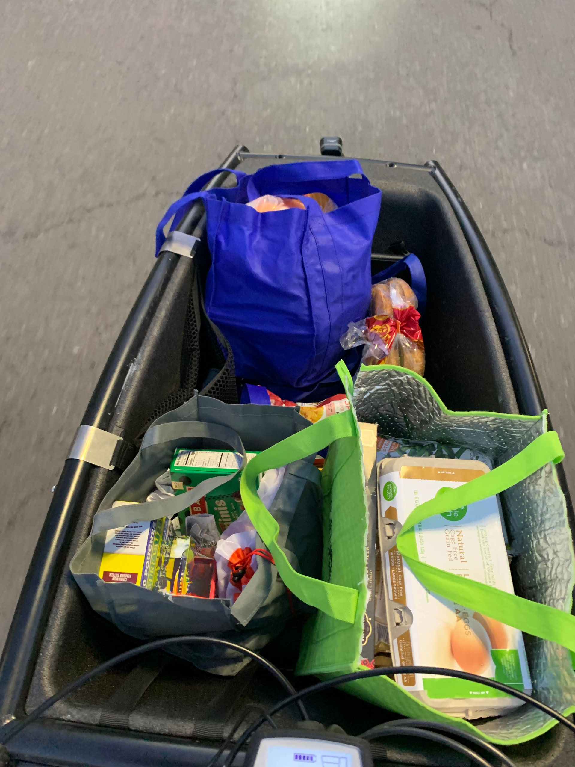

I have a rain cover which helps with rain and wind so I drop the kids off at school most of the year on my way to work (I still drive when it’s snowy or icy as one of my fears is going down with them in it). I can also fit about $300 of groceries in it when it’s just me.
