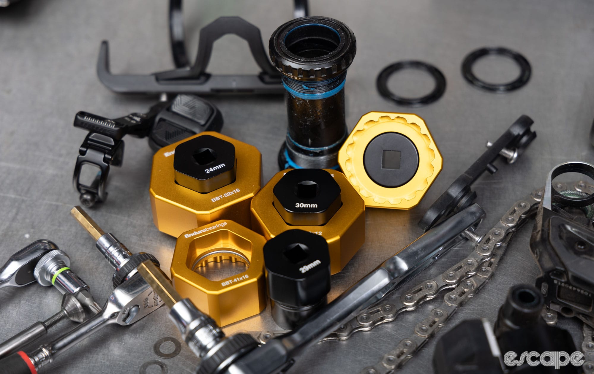

Hi all, looking to upgrade my bearing extraction/installation tools, as an early Christmas present to myself and have been looking at the BRT-040. For reference, I’ve already got the BRT-060.
In the context of smaller bearings, specifically those found in hubs, in various set-ups (i.e. blind, semi-blind, with spacer tubes sandwiched in between 2 bearings, etc), would it be correct to assume that the BRT-040’s collets are meant for removing the relatively larger bearings of a BB, while the drifts from the BRT-060 are meant for removing the hub bearings?

Your understanding of the kit is correct. The BRT-040 has bearing pulling capacity for bottom brackets (24 mm bearing ID and up). The BRT-040 can also be used on hubs for pushing out bearings with shouldered (captured) axles.
Some hub designs will still require further tooling that will allow the pulling of bearings that have blind access, spacer tubes, or open access. Enduro now has the BRT-041 for those applications, but I’d sooner recommend bearing pullers from ALT/ALT or Abbey.
The drifts in your BRT-060 are almost entirely made for installation purposes. The one exception are the few items designed for removing frame pivot bearings (MTB), however, these aren’t intended for use on hubs

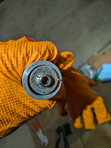

Worked great on this bearing with a tight spacer. Silver puller doesn’t extend past the race. I think it could even be used as a fully blind puller as well if there’s enough clearance behind it for the bit of wedge that extends.

Also - the bearing face depicted in your pic: was that face facing the inside of a Freehub body??!!
Yes, it’s a v2 wind out. Sorry for the confusion on sizing, I mean they offer more sizes. I bought the whole set, which is cheaper than the abbey set. Even cheaper in individuals of course.
The bearing you see is from a suspension pivot, but it was facing internally. Theres sorta a labyrinthine path to the inside, so it seems dirt works it’s way in eventually
