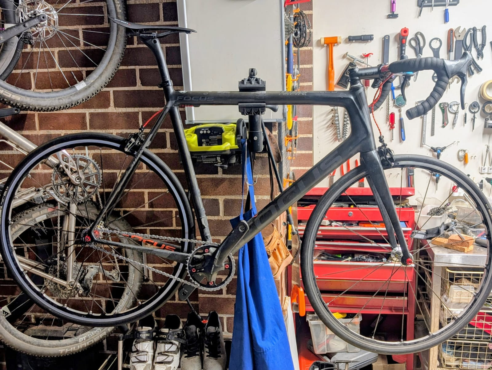

If it’s only for home use maybe think about one of the non-cyling ones, probably from whatever battery ecosystem you’re in for power tools. I’ve got a ryobi inflator mounted on the wall behind my workstand (easily lifts off to do the car etc) with a twin head and clik adapter on it and it’s awesome. You can see it behind the bike in the chaos of this photo.
Battery has lasted 12 months without a recharge, hose is long enough to do both wheels on the stand, much quicker and cheaper than a smaller unit, settling and accuracy are good. The only thing I don’t like compared to my on-bike inflator is that it doesn’t remember the last set pressure.
