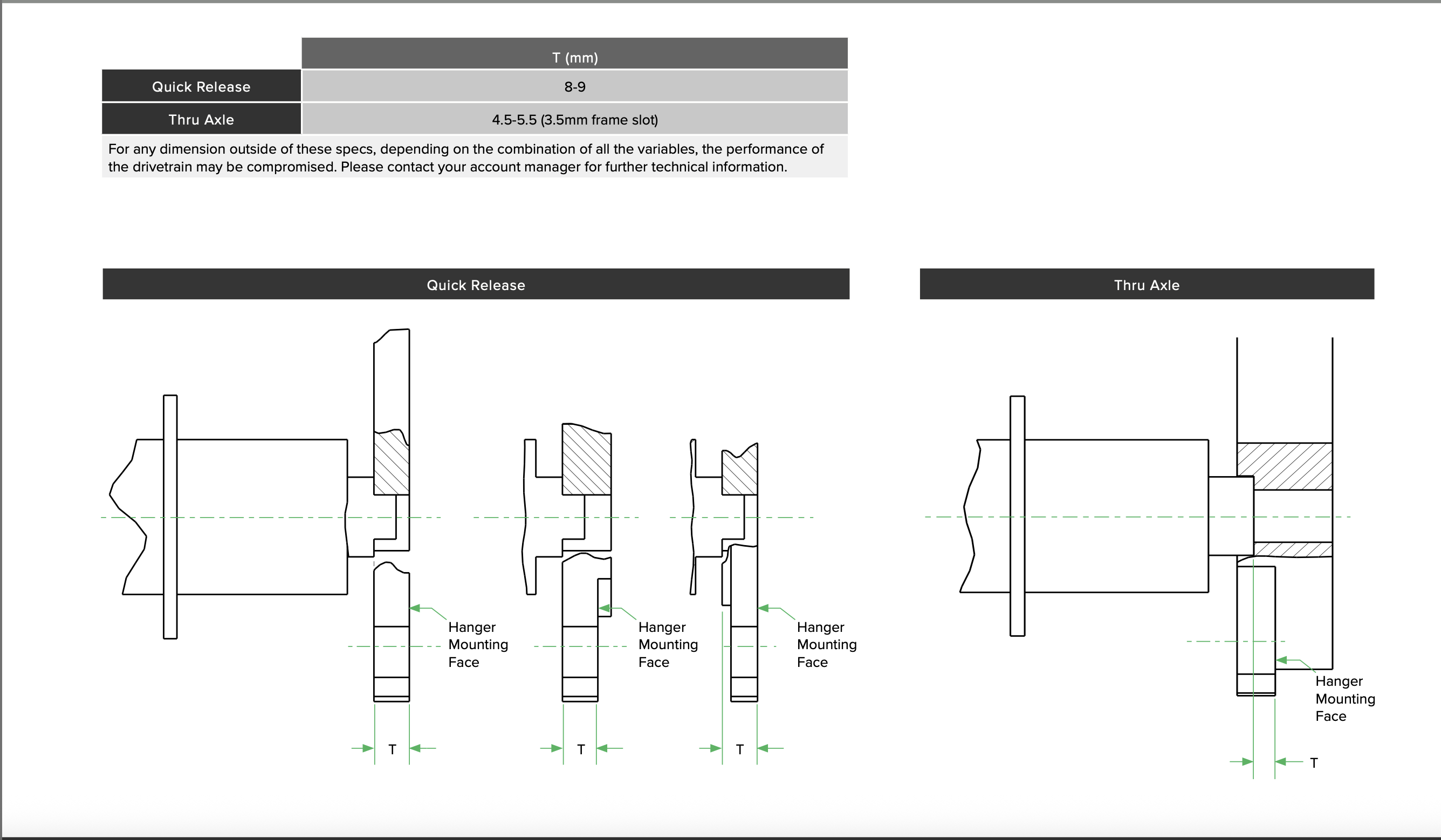

SRAM Eagle XX1 (OG, non-Transmission) AXS derailleur sits too far inboard.
I bolt it on and it’s basically directly underneath the 11T rather than the 10T. I can just about micro adjust it all the way outboard but then there is no scope for adjusting anything else.
Without the upper limit screw set it also just overshifts into the spokes at any microadjust setting that isn’t all the way outboard.
Hanger is fine - checked with a HAG.
Is there any kind of button combo/limit screw ‘hack’ to reset the position of the derailleur?!
It seems like it’s exactly 1-cog off.
B-tension and chain length are fine - but at this point kinda useless anyway because the derailleur isn’t in the right physical place in space.
The hanger is spec’d for SRAM Eagle rear derailleur?
Had no idea about this. It looks to be about 1mm too narrow… so that’s probably why.
It’s kinda working ok-ish with the microadjust maxed out so that’ll have to do I guess.
Add a 10mm OD 1mm thick washer
