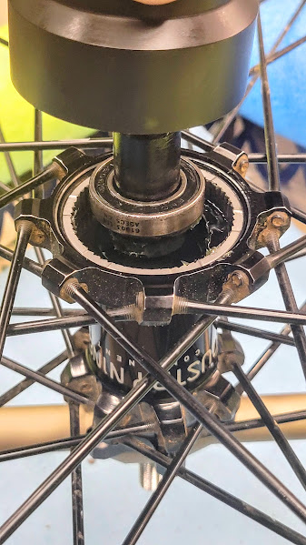

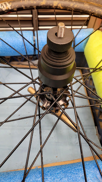

I replaced the bearings on a DT rear hub yesterday, here is a breakdown of the tools I used.
End cap removal - pair of Knipex pliers wrench. I do have a 3d printed end cap remover from BSC Tools but find the Knipex pliers work perfectly and leave no marks on the end caps.

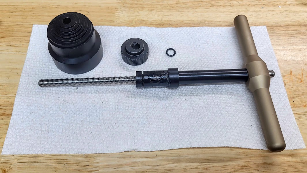

Bearing removal and Installation - Wheels Manufacturing hub bearing press essential kit (the rod and handles), their hub bearing press kit, and a 3d printed part I use as an over axle part.
I used the Wheels kit and my 3d printed part to press out the axle and the bearing from the hub, pushing out one side first, then flipping the axle around to press out the other bearing.
On hubs and freehub where I cant use the axle to push out the bearing, I use a set of Nobel (now Abbey Bike Tools) bearing extractors to pull the bearings out.
Bearings are pressed back into the hub/freehub with the Wheels tools. Depending on the hub type, I’ve a couple of additional 3d printed over axle drifts to make that part easier.

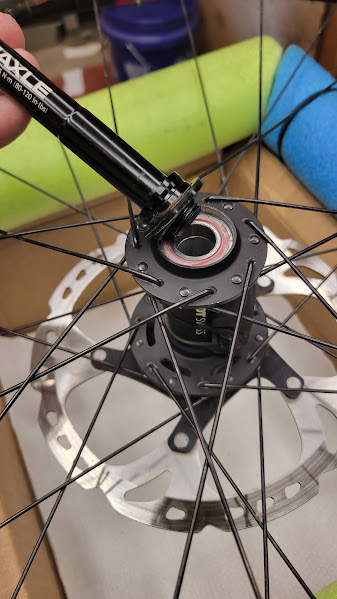

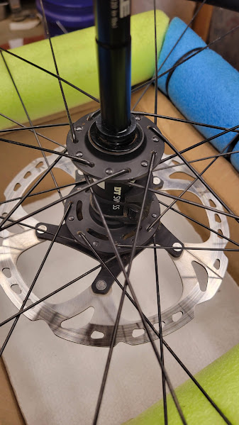

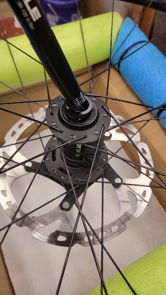

You have the only tool that you need to remove end caps and it’s the thru axle.
Just gently slip the axle into the end cap, but not too deep or this won’t work. Usually with a few axle threads showing. Just a shallow insert and gently tilt the axle and pop-off the end cap.

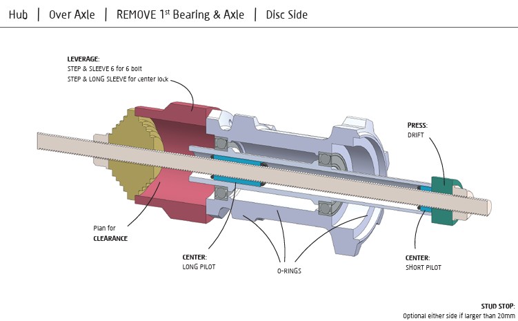

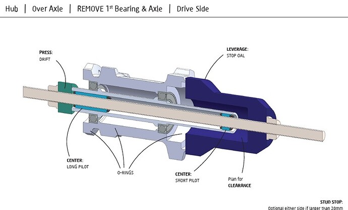

The 350 & 240’s are a captive axle or over axle hubs. Meaning that you have an axle that is captive between the two outboard bearings. In order to remove the axle, you must remove a bearing. In order to remove a bearing, you must remove the axle.
You have two options to remove the DT bearings. You can do as suggested earlier and pound out the bearings with a hammer by using the captive axle to drive the 1st & 2nd bearings out. It is tool-free and you need nothing additional to remove the bearings. Or, my preferred execution on all bearings is to wind them out. Smooth, gentle and impact free. You are leveraging the captive axle to remove the opposite bearing.
I do not have photos of a DT 350 Bearing removal, but these are I-9 hubs with a captive axle and they are the same in principle to the 350’s.

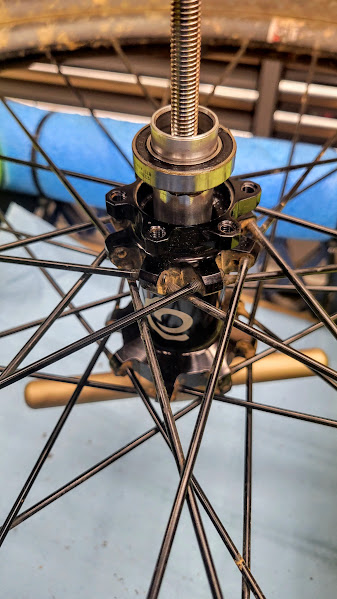

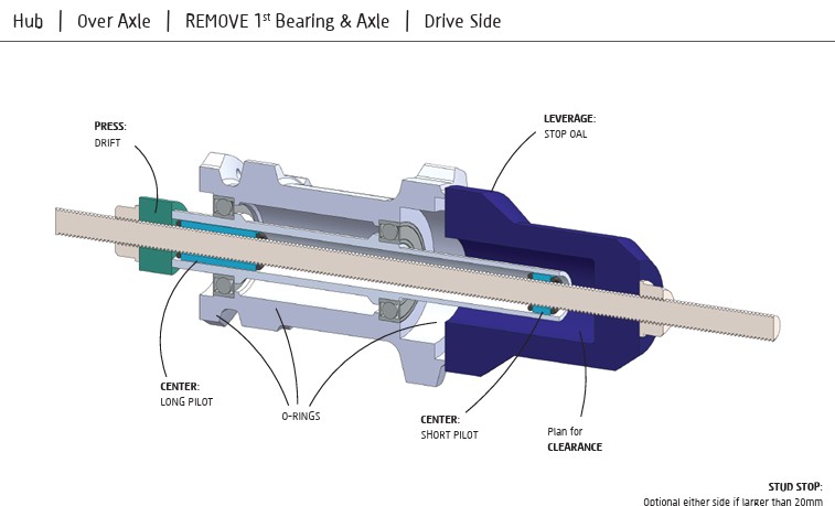

Hammer-Free, Wind-Out Bearing removal with Captive Axle Hub followed by adding sleeves, pilots and drift to wind-out Disc-side bearing by pressing on DS captive axle that winds-out the NDS bearing.
With sleeve and stopper in place, attach stud stop and carefully wind out 1st NDS Bearing. No hammer needed.

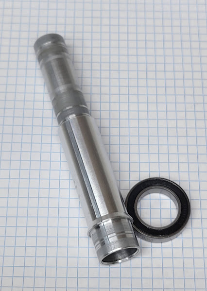

Captive Axle and 1st NDS Bearing removed.

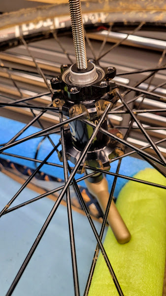

Winding-out the remaining drive side bearing is basically a repeat of removing the NDS Bearing with a few minor changes. Again, NO Hammering anything out. Like the other bearing, Pilot, drift, spacer, sleeve and stopper assembled and ready to Wind-Out the DS bearing. Insert assembled stud and hand with sleeve, stopper and stud-stop and turn the handle to gently extract the last remaining bearing.
Again, this is a I-9 hub, but the principle of bearing removal is the same.
