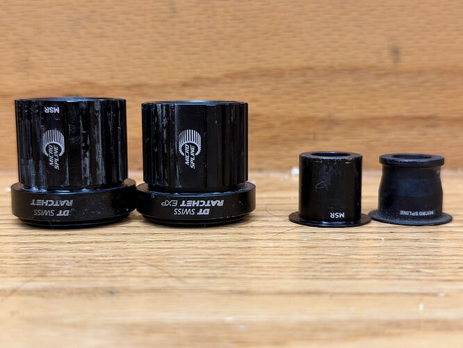

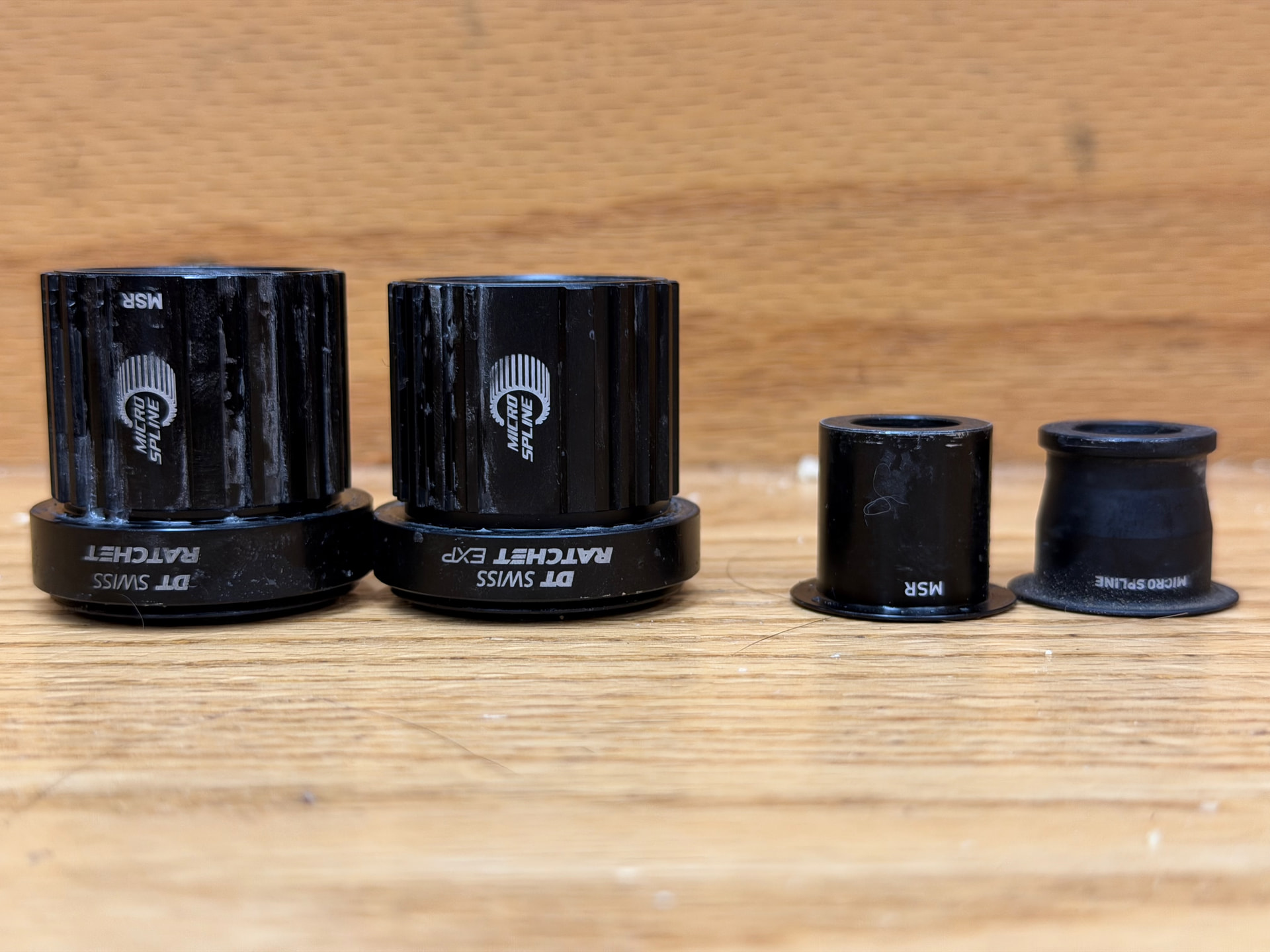

I had to do a fair amount of internet digging to figure this one out, so thought I would add to this helpful thread in case anyone stumbles on it trying to understand MS vs MSR in the future. Here is a picture of what they look like for DT EXP hubs.
Key points:
  • The 1 mm-ish of extra space on MSR is primarily from the flat shelf the cassette sits on (essentially a built in spacer).
  • The spline sections are identical in length on both.
  • The end cap is also about 1 mm longer but also sits a bit deeper in the free hub body.
  • Unlike the XD vs XDR you DO NOT need a spacer behind the cassette despite what some inter-web posts say. The cogs will actually not seat properly on the splines if you do try using a spacer. The SRAM XD vs XDR spacer thing is addressing a different issue with different road vs MTB cassette widths which doesn’t exist here.
Like the OP, I did not understand the MS vs MSR differences in the beginning, and didn’t even know the MSR existed until I was trying to improve noise in the large cog for my 1 x road XTR install. For my application anyway, the MS worked, but changing to the MSR quieted things down in the larger cogs and shifting quality improved slightly likely due to a more optimal chain line. Plus not having to close the extra mm on the rear with more torque on the through axle and unknown impact to the stays being pressed in a bit tighter.
