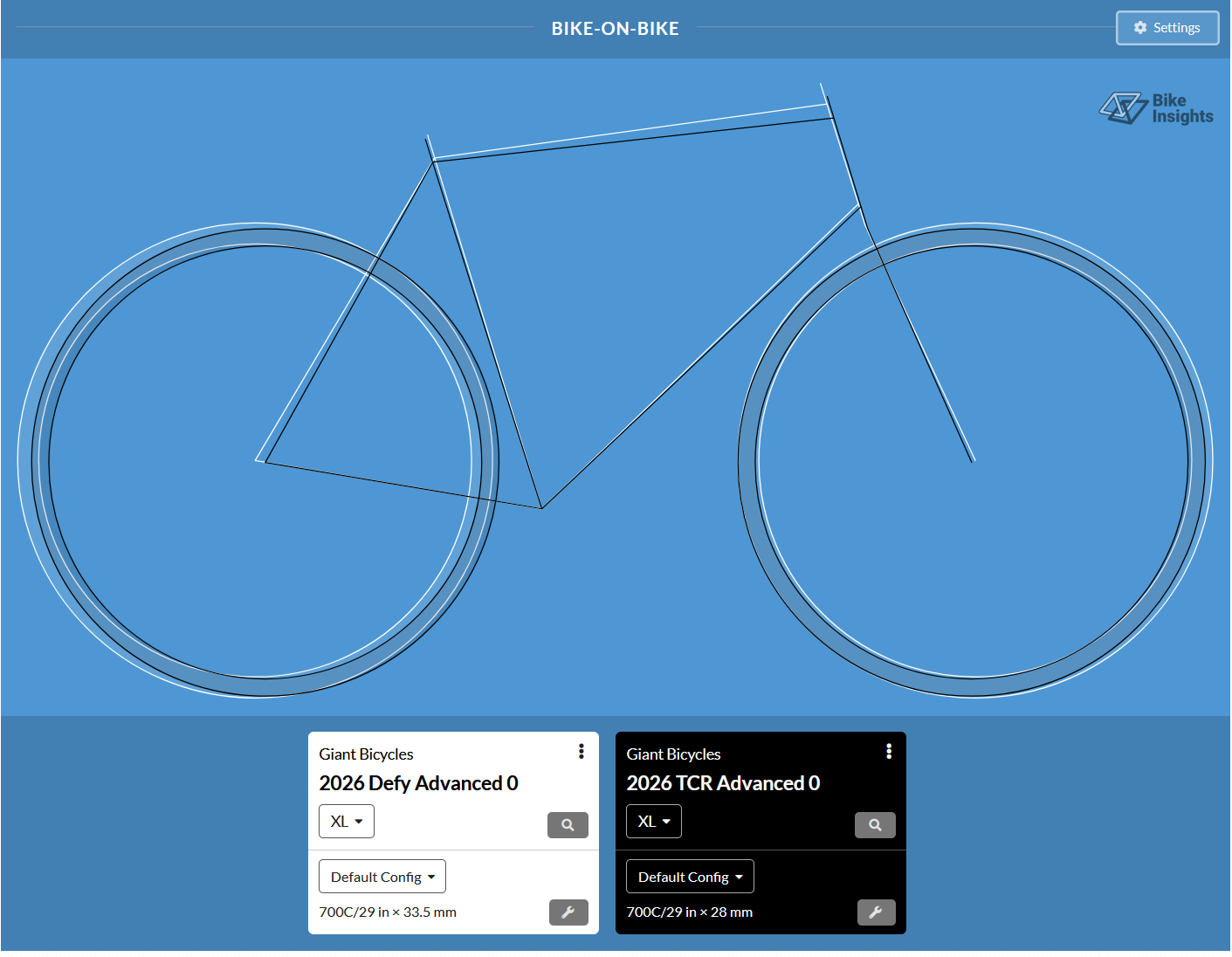

Picture of e.g. Giant Defy and Giant TCR in comparison:
Review: 2024 Giant Defy Advanced stays the course with steady refinements
The position is aggressive for an endurance bike. A Defy XL’s stack/reach is 615/402 compared to a Tarmac 61 at 612/408.

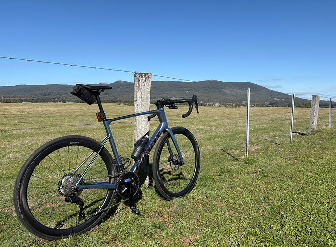

I’m riding a defy advanced pro 0 (2024) - moved from sunny Australia to Netherlands, so the integrated fender option was the biggest selling feature at first​:wink:. It is an outstanding bike.
The fit is a tiny tiny tiny bit more relaxed than the extreme race positions I’ve ridden for the past 30 something years, but as another poster wrote : it still is a racy endurance bike. I haven’t felt any speed deficiency in quick bunch rides and sportives - maybe being comfortable is faster?!!? The primary benefit for your friend may likely be that he will be able to log significant saddle time in relative comfort - a key requirement if he is taking early steps in training towards an Ironman event.
