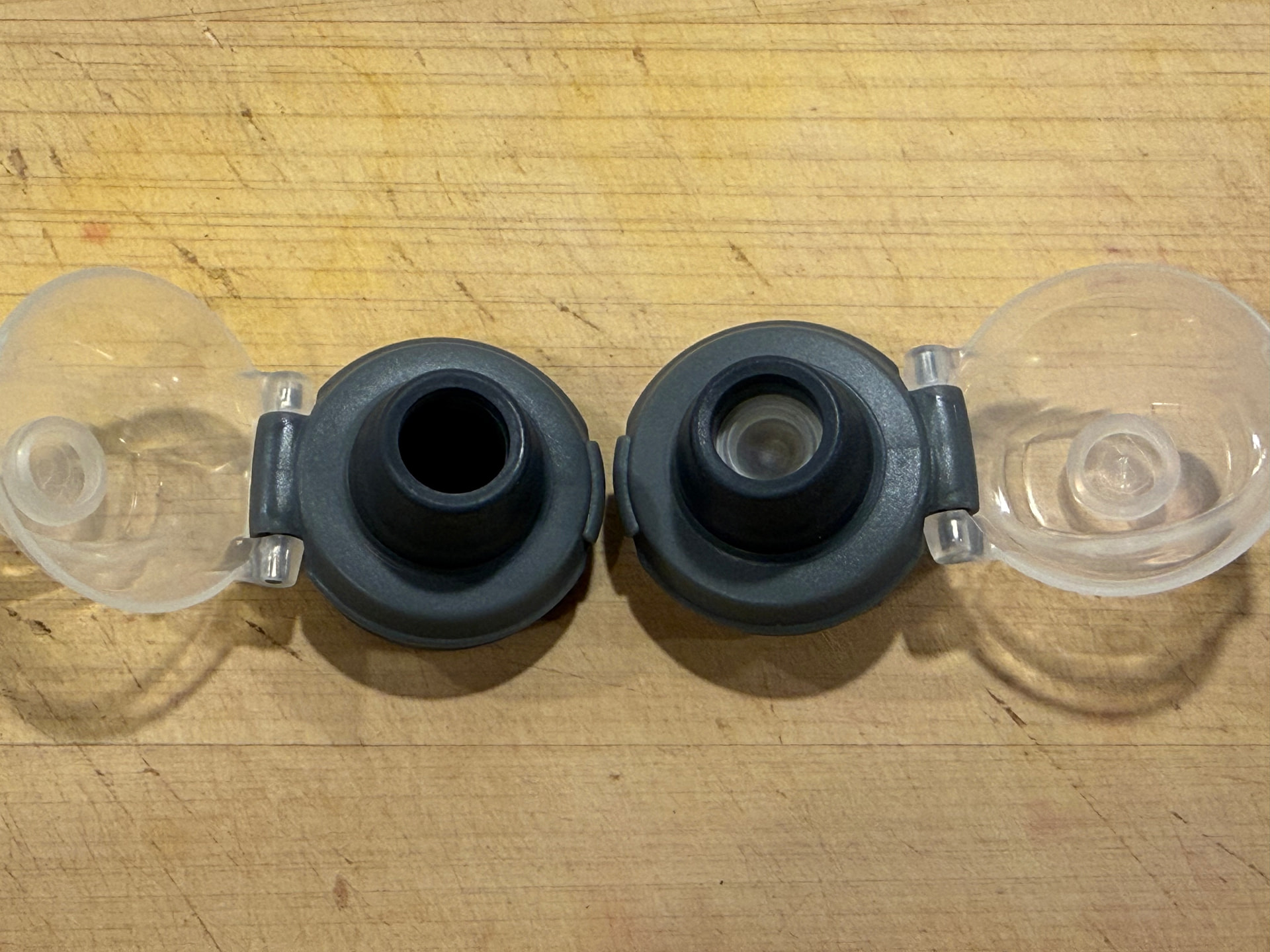

I haven’t tried the gel nozzle yet, but it looks like it wouldn’t be as easy to clean as the flip cap. This flask should have it: HydraPak Softflask 250ml
From the side, it looks just like the version without the silicone valve. The difference is that liquids don’t run out if you hold it upside down with the cap flipped open.

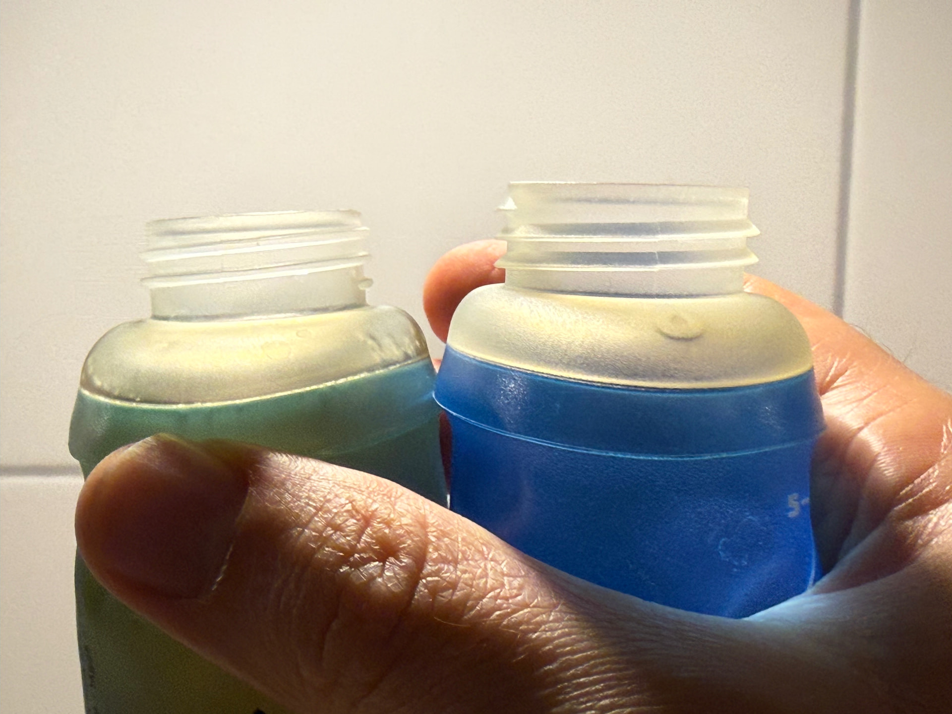

BTW here’s a close-up of the flask threads. Hydrapak on the left, Salomon (made by Hydrapak) on the right.
Hydrapak caps with and without silicone valve

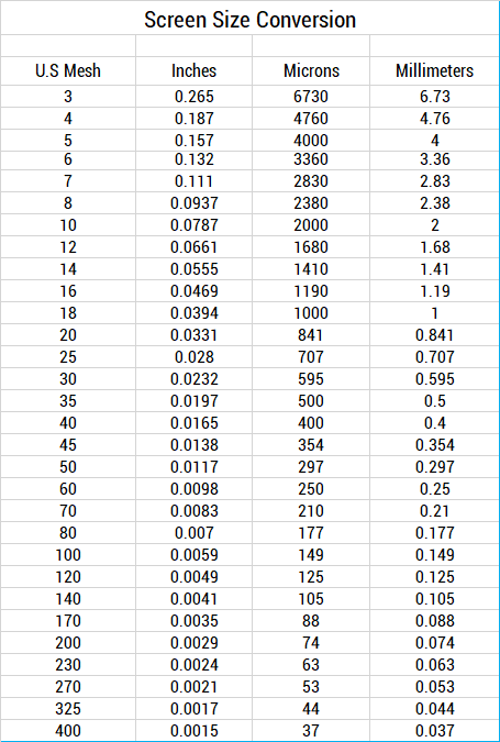

Someone upthread mentioned their maltodextrin was extremely fine. One tip when looking at any of these ingredients in powder form would be to identify the mesh size - it’s a standard which correlates directly with particle size and can be useful to keep track of if you’re trying to troubleshoot a formula or achieve a specific texture in mixing. 100 to 200 mesh is pretty common for this type of powder.
