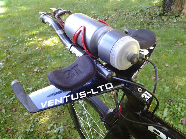

I did this mod on my P2: (not my website I just did the same thing)
but caveat empotato.
There ya go - I’m not the only loony out there!
