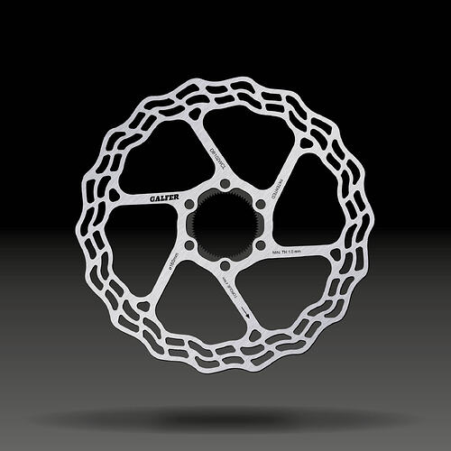

Disappointed by Galfer Wave discs
Got them because I thought they looked cool, but they’ve let me down. Very squealy very quickly (on dry rides!) and uneven brake performance (even got a kind of “stick-slip” feeling during a recent ride: shortly lost the stopping power during a steep descent, and then didn’t really trust them for the rest of the ride).
Switched back to the new Shimano 105 discs (with the same pads, same wheels, same brakes…) who’ve been working as decently and trustworthy as always.
Has anyone else had disappointing experience with the Galfer discs? Or did I maybe not bed them in well? Do they work better with other pads or calipers?
Thanks!

Haven’t had a go at all of the 150mm variants for Centerlock mounts, but the most common ones are the DB102WCL fixed ones, which have been around for quite a while.
