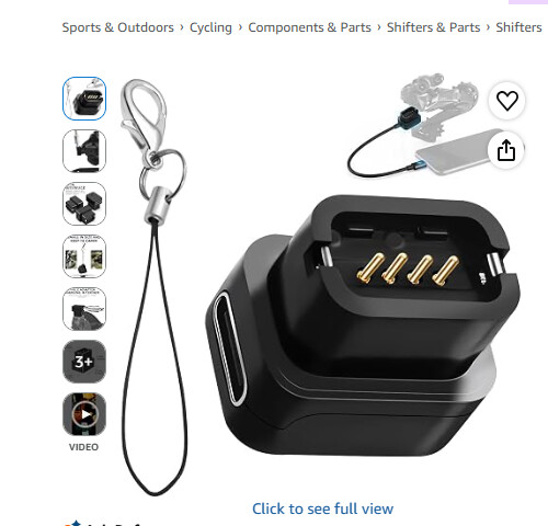

There are little USB C to 12 speed DI2 chargers for pretty cheap. I keep one in my saddle bag just in case.

Given that there are so many rubbish solutions, could you be so kind and provide me with the pecific brand name for the reliable adapter?
It was the first one that came up on Amazon :man_shrugging:
I think those are really all the same. I can’t say if one is better than another.

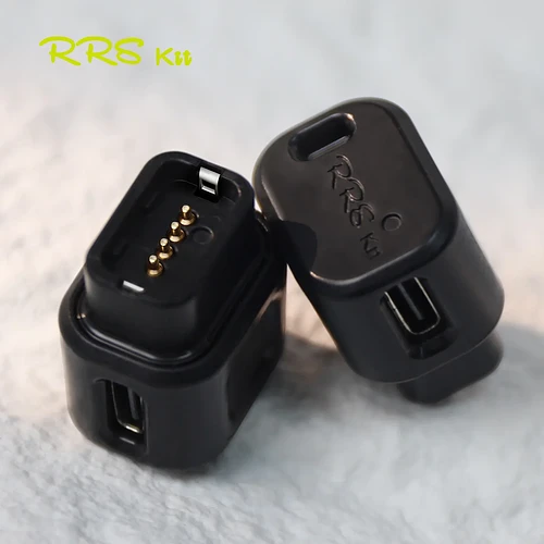

Rrskit is the one that gets recommended on chinertown forum and it’s the one I have. Some of the cheaper versions are supposedly 3D printed and fragile.
Not sure if the forum allows links - this is a straight link to the item on AliExpress not some affiliate referral spam.
