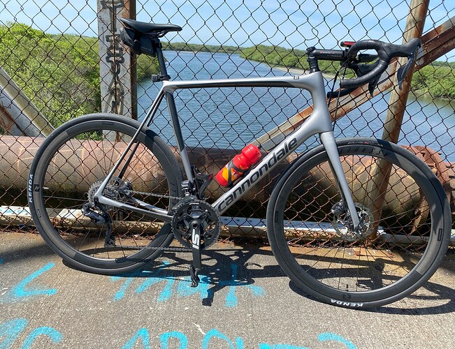

I have a 2018 Cannondale Synapse Di2 and wish to update the crankset (or chainset) to something more aesthetically pleasing. I am looking at the Praxis Zayante (175mm and 34/50 rings) but will entertain other reasonably priced alternatives. The Cannondale uses an asymmetric BB30a bottom bracket shell, which makes the choice somewhat limited, I believe. Suggestions?
