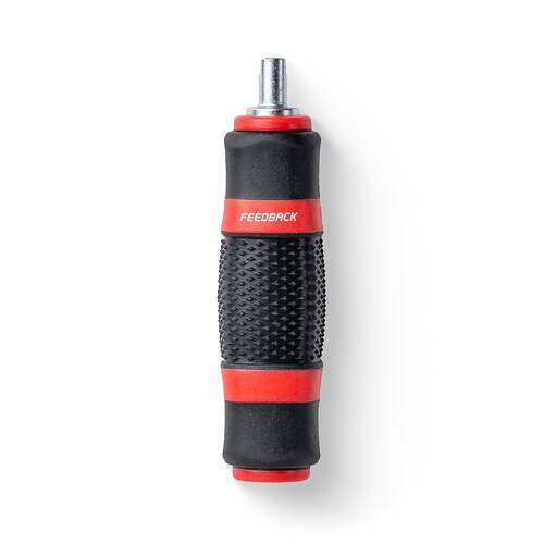

Edit: If you have the Park tool valve core remover, the little notch in the side of it works for removing Clik valves
Thats a good looking tool, but at the bottom of the listing they specifically call out it not being compatible with Clik
