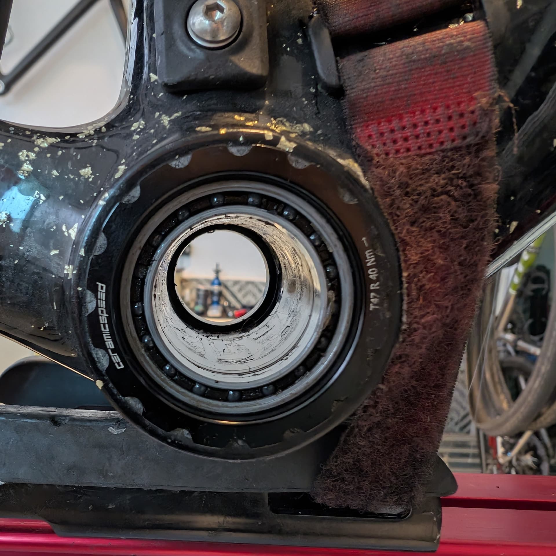

What coated Ceramicspeed Bearings look like after an estimated 2 - 3,000kms of neglect, in tropical rain, and whatever the tyres kick up. Completely dry of grease and prior to cleaning, with liberal dousing of isopropyl alcohol and scrubbing with a toothbrush. Don’t neglect your bearings.
We do regular checks on client bikes and strip, clean and repack bearings every 2,000kms or so, often less, and rarely have issues with worn bearings for way more than that 8,000km figure. Any issues we encounter are usually from neglect (from new clients), crushed headset bearings, etc.
Bottom line is to get on top of your bearing servicing routine, and you should be fine. Do note that some bottom brackets, like Shimano’s BBR60, weren’t meant to be serviceable, and are largely a consumable item.

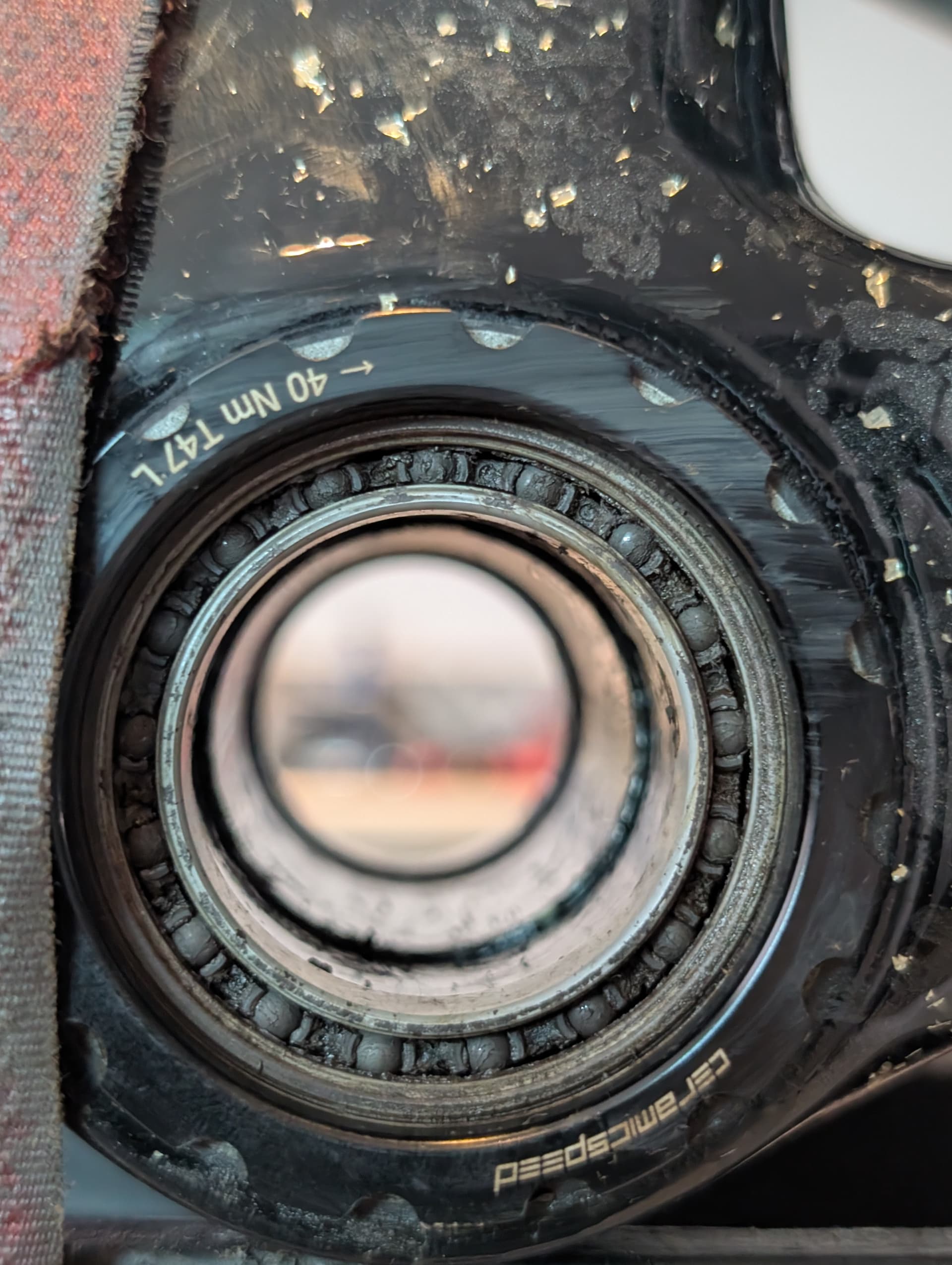

In (more) extreme cases, like the BB above, we;
  1. Used a dull pick to (first) remove the bulk of the debris that had made its way into the bearing itself, around the races, seats, etc.
  2. Doused the bearing with Isopropyl Alcohol using a spray gun and scrubbed gently with a toothbrush, followed by a wipedown. For the BB above, we had to repeat this step a few times to get it to a fairly clean state. The BB still ran a little rough though, presumably due to the higher levels of wear.
  3. Repack with grease. I personally tend to lay a ring of grease (CeramicSpeed’s All Round Grease, for this BB), right over the bearings itself, and somewhere between the inner and outer races. I also tend to pack a little more than needed to ensure that there is sufficient grease to fully coat the bearings, and internal faces of the races, after the seals are laid, but not too much that it “floods” the bearings.
NB: the image in my earlier message above shows the “before” shot of the BB before cleaning. Attaching the “after” shot here, with some bits of paper towel that hadn’t been removed. :laughing:
