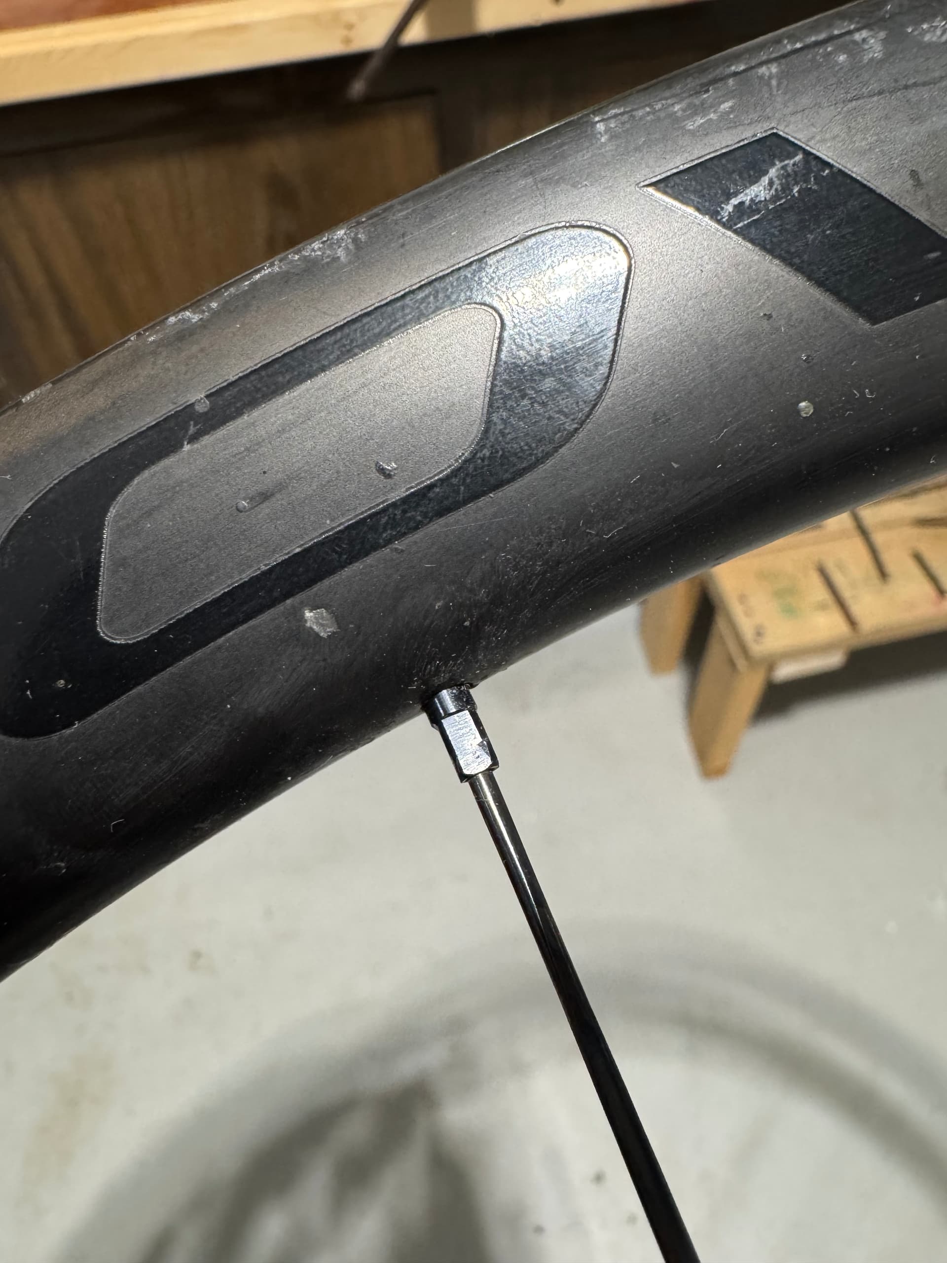

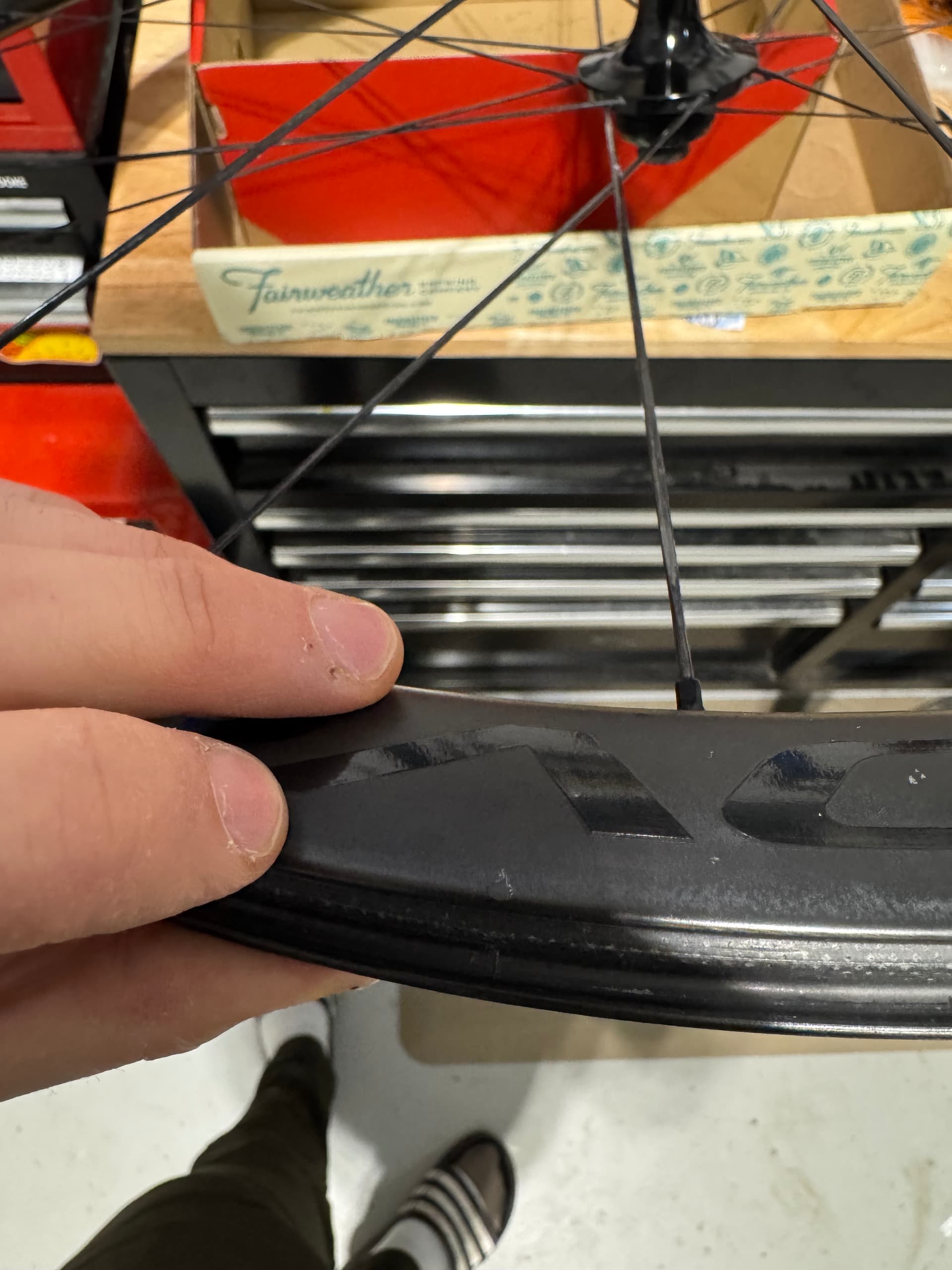

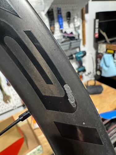

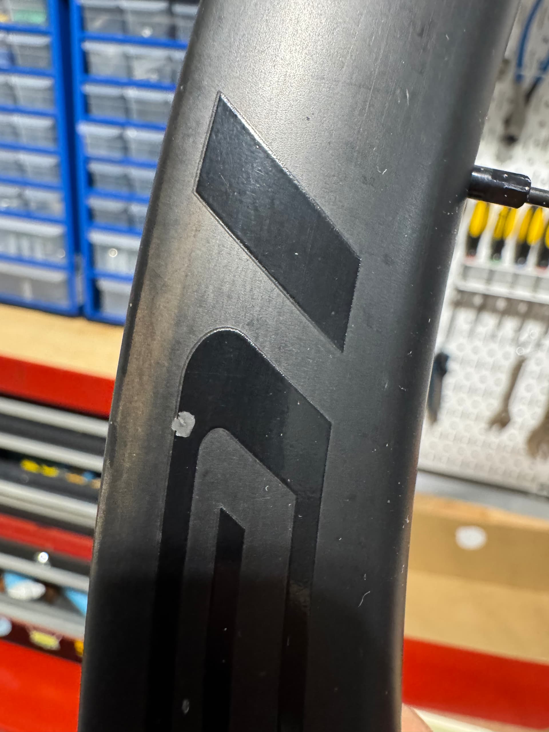

Hi everyone, I’m just wondering whether the wear I’m seeing on my carbon rims is purely cosmetic or whether I need to be concerned. The wheels in question are a set of Roval Terra CLX which were purchased in 2019. They’ve accumulated a fair number of blemishes from normal use on road and gravel over the past five seasons. I’ve attached some photos. Any input would be much appreciated.
If those are disc brake rims, I say ride on…
Just sharing some thoughts for the paranoid (i.e., me). The resin that impregnates carbon fibre can sometimes degrade over time, when exposed to UV, becoming brittle, etc. Not knowing what resin was used in wheels, frames, etc can give me pause, especially when the top coat/lacquer has been removed through wear and tear, or otherwise.
In such circumstances, where the damage/blemishes are not structural, and mostly cosmetic, I’d usually apply a dab of UV-resistant clear coat/varnish with a steady hand, and you should be fine.
Carbon really is talked about like it’s weak and brittle far too much. Unless you’ve crashed them, just cover the blemishes with paint or the method above and ride on.

I see no evidence of damage to the epoxy matrix; UV damage to epoxy usually shows as reduced transparency and increased colour (towards orange), for reasons interesting only to chemistry geeks, see: Effect of Ultraviolet Aging on Properties of Epoxy Resin and Its Pultruded Fiber-Reinforced Composite - PMC
IMO the advice above to simply repair the damaged topcoat with something UV resistant is sound. Plenty of them available for cars etc.
