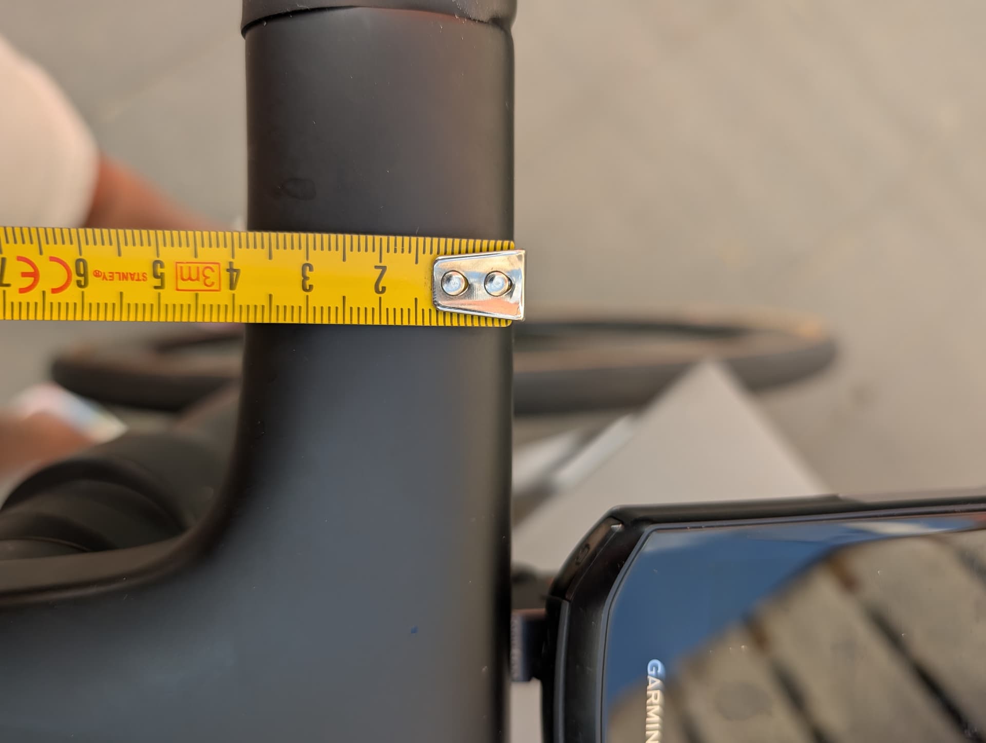

I have a Canyon Endurace CFR in size L with the CP0018 cockpit. I swapped the T-bar for a 80mm stem length. Now I want to order a aero plug, they ask for the size of the bike. And here it becomes interesting. I have the idea the measurements of a smaller size T-bar are a little bit different compared to my original, however I don’t have the original anymore.
Is there anyone with a Endurace or Ultimate in size L or higher with the CP0018 handlebars that can measure something for me? I want to triple check if there is a difference compared to the roughly 4 cm in the picture.

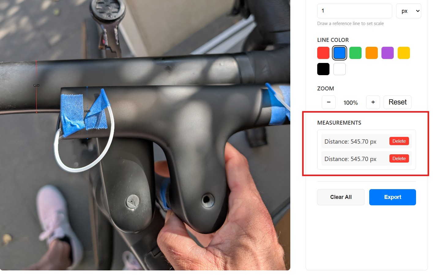

I realized at some point I made a picture when the order arrived, to show the difference in the stem length. This also allowed me also to check the other dimensions. I used an online measurement tool, which in this case simply shows the number of pixels in the picture. Which is ideal for this scenario as I have a reference.
Turns out they appear to be exactly the same.
