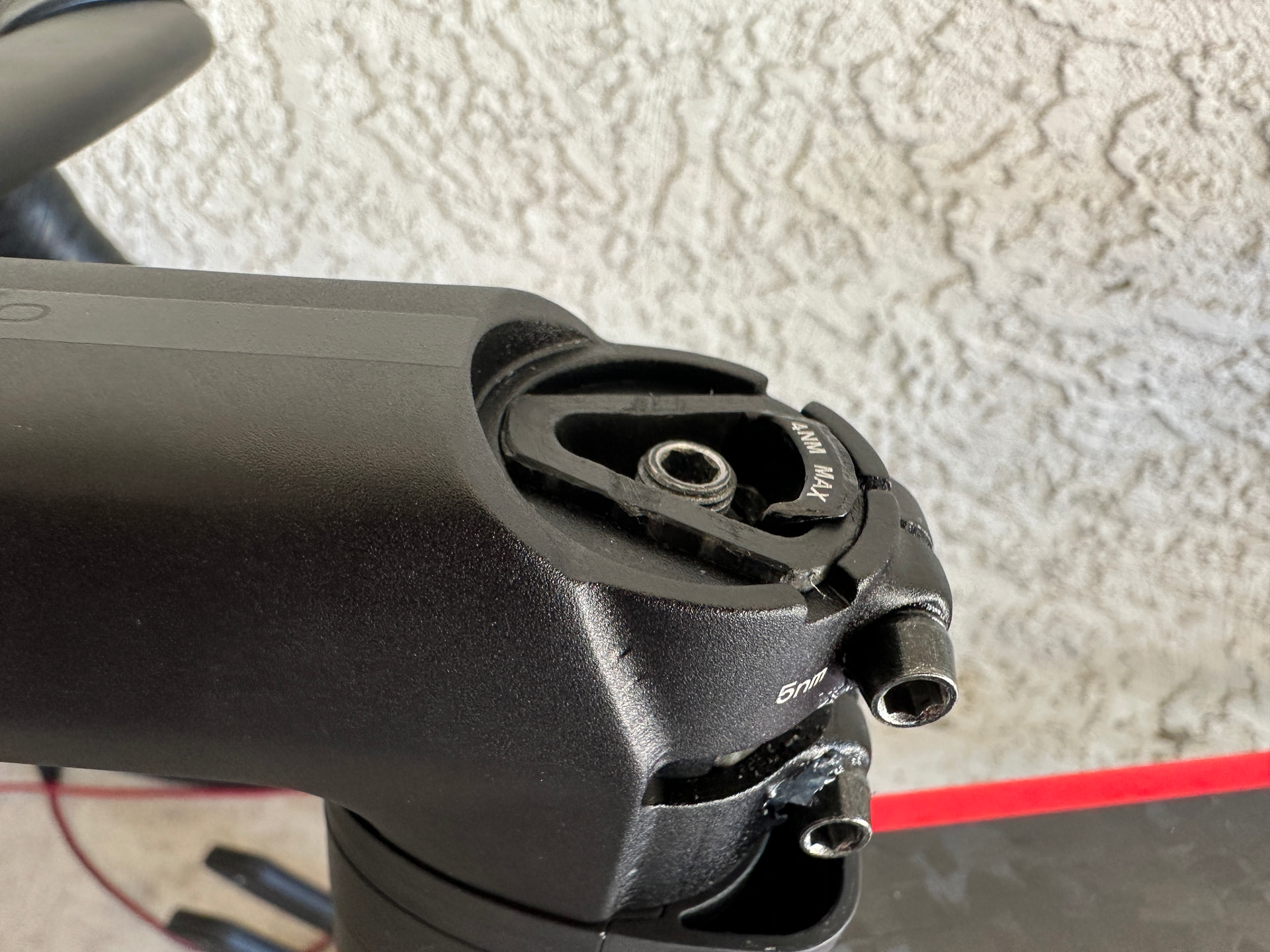

I actually had that same issue initially but the steerer tube is now level with the stem clamp although the filler is lower. When I took this photo, I put some pressure on the stem and got the same tick without the cap on.
