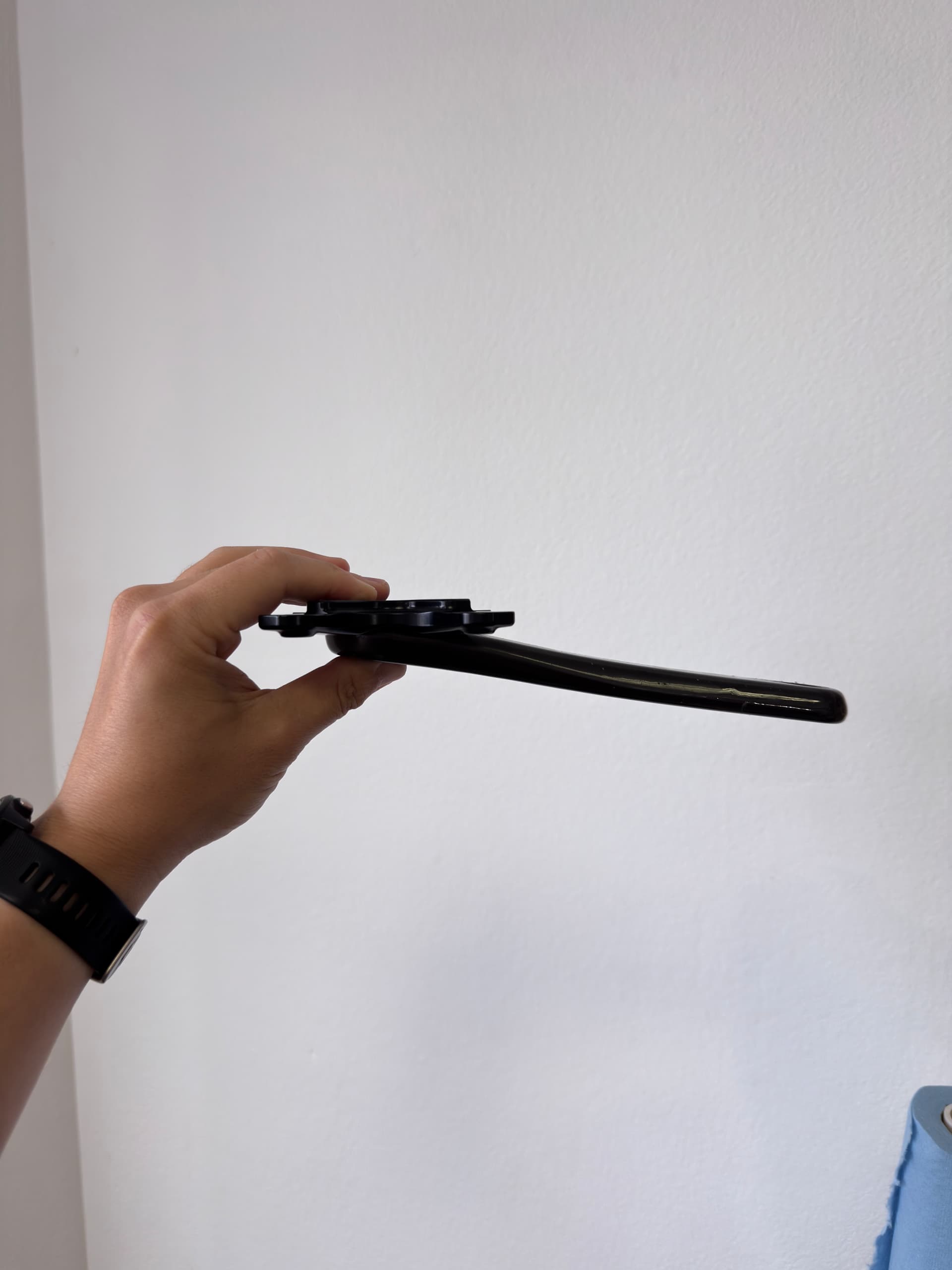

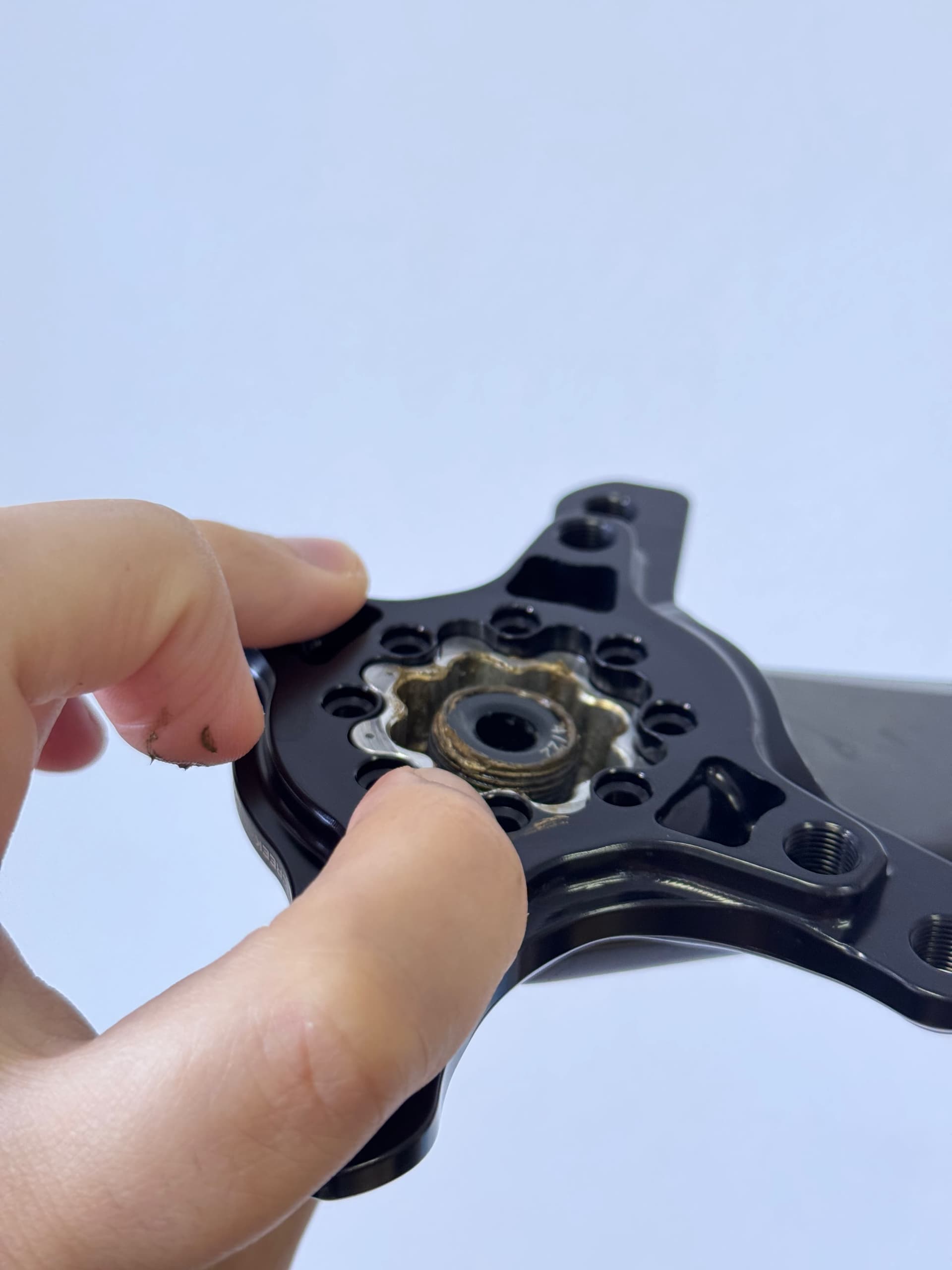

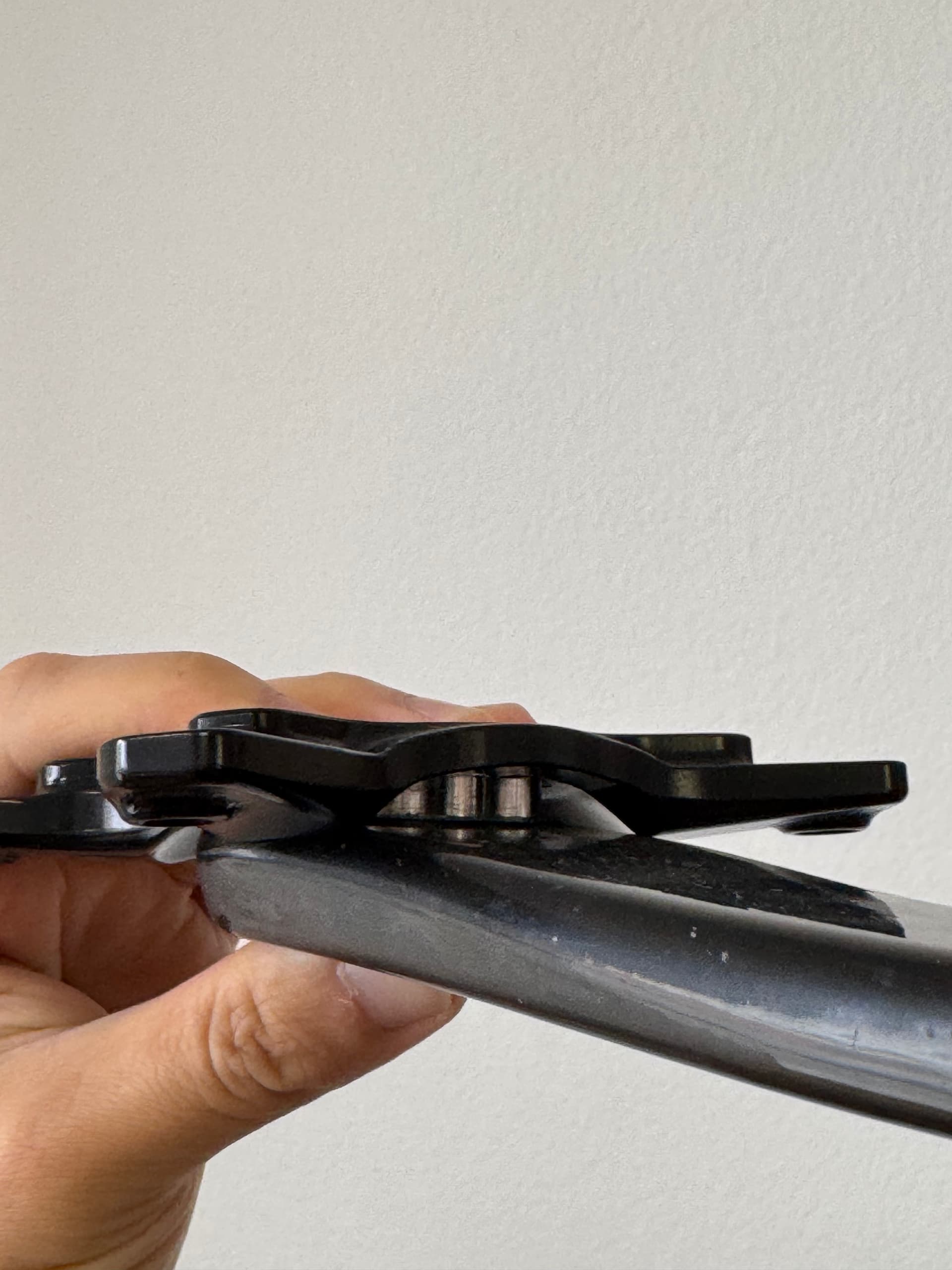

I tried it on the Croder arms and Rival arms I had on hand. They don’t fit. They made it to explicitly fit Cane Creek arms unfortunately. There’s some interference with the arm itself.
I haven’t returned the spider yet, so I’ll try to take some photos tomorrow if I remember.

SRAM Red D1 arms with CC GRX spider is a no go

Wow. Thanks everyone. Could an answer be any better than those photos! Membership paid for by avoiding an expensive mistake. Back to the drawing board! Thanks for the tips on Rotor. I’ve had some poor experiences with their stuff so was hoping to avoid but it seems like it might be the only option.
