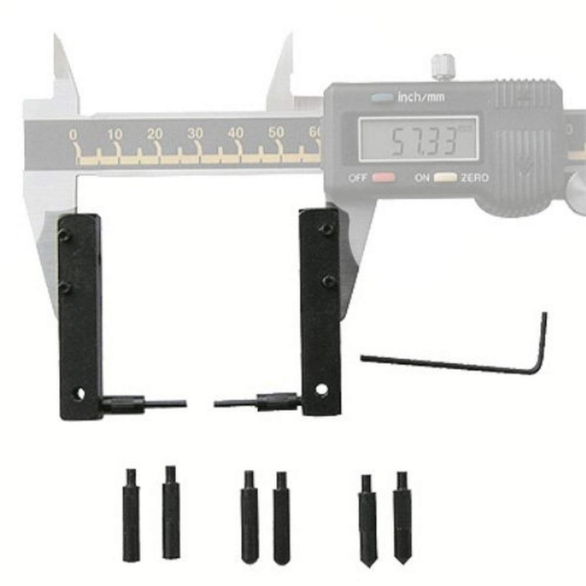

These might be interesting caliper accessories
These are the ones I use.
DCA-1 Digital Caliper Accessory | Park Tool
Have you used these. Probably the cheapest option but has terrible reviews for them cracking when tightening the set screw by multiple people.
https://a.co/d/eT7Us8B Appears more sturdy but similar option
It’s literally the smallest set screw imaginable do don’t know why anyone would do any more than snug it up. The act of using the calipers seats the adapters into position already so the set screw just keeps them from falling off.
Apologies for the snarky response. That’s just me saying that I personally haven’t had any problems with them and you certainly can’t beat the price! I think it’s one of the cheapest things you can buy on the Park Took website.

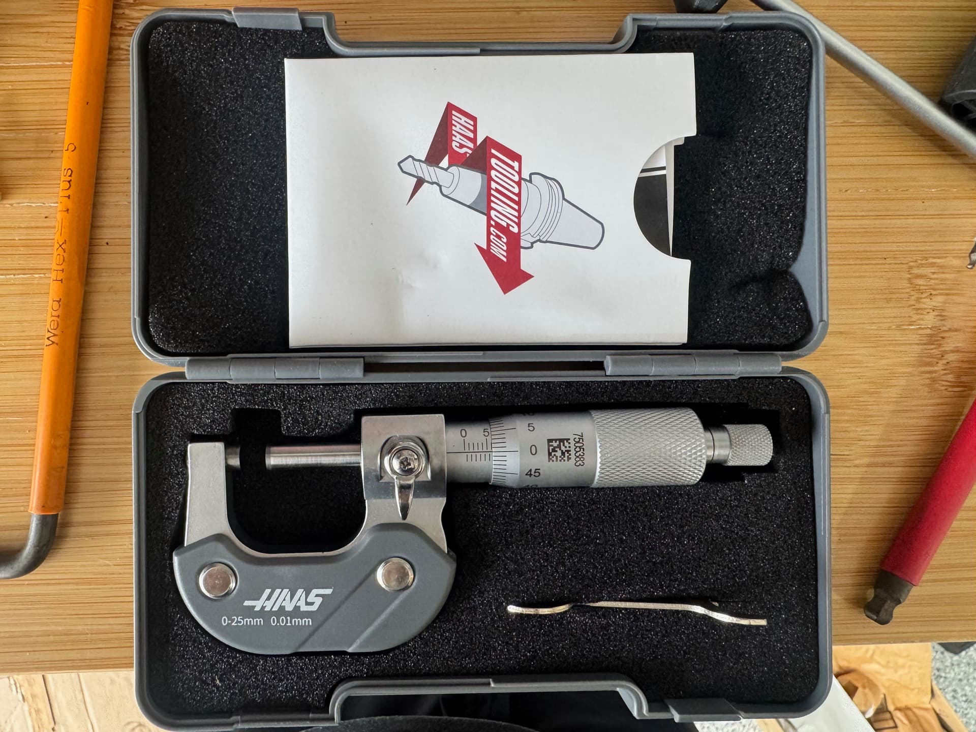

I have just the tool for you! Just bought it as I was sick and tired of my (cheap Amazon) digital micrometer always being out of batteries the few times a year I wanted to use it. So I went analog from Haas - ON SALE for $24.97 - less than the cheap garbage on Amazon. Part #09-0196, see 0-25mm Outside Micrometer, 0.01mm Graduation, Chrome Plated Frame. If you join their “winners circle” for $10 you get free next day air + additional 5% off - a great deal overall. The construction is entirely metal - no plastic bits that will degrade over time.

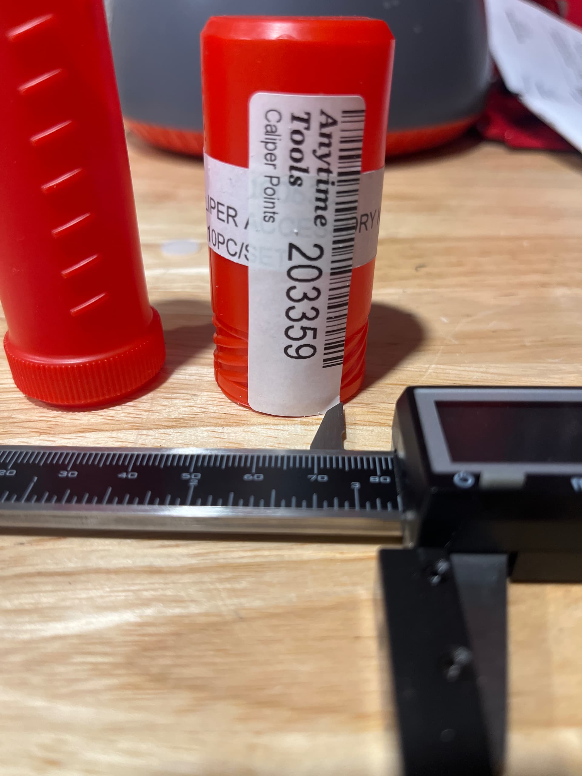

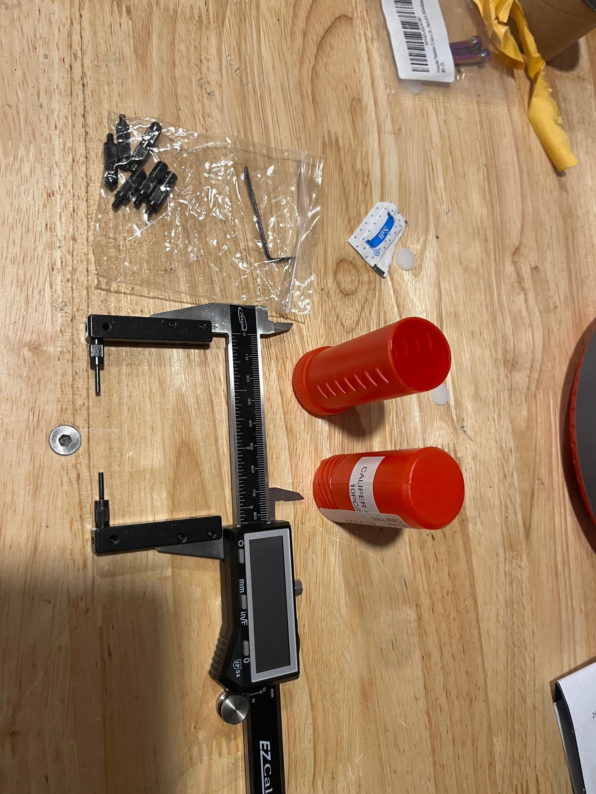

Finally had this set come in from Amazon. Works well.
If the attachments are not permanently affixed to the digital calipers, I am curious if you will be able to repeat the exact same position each time.

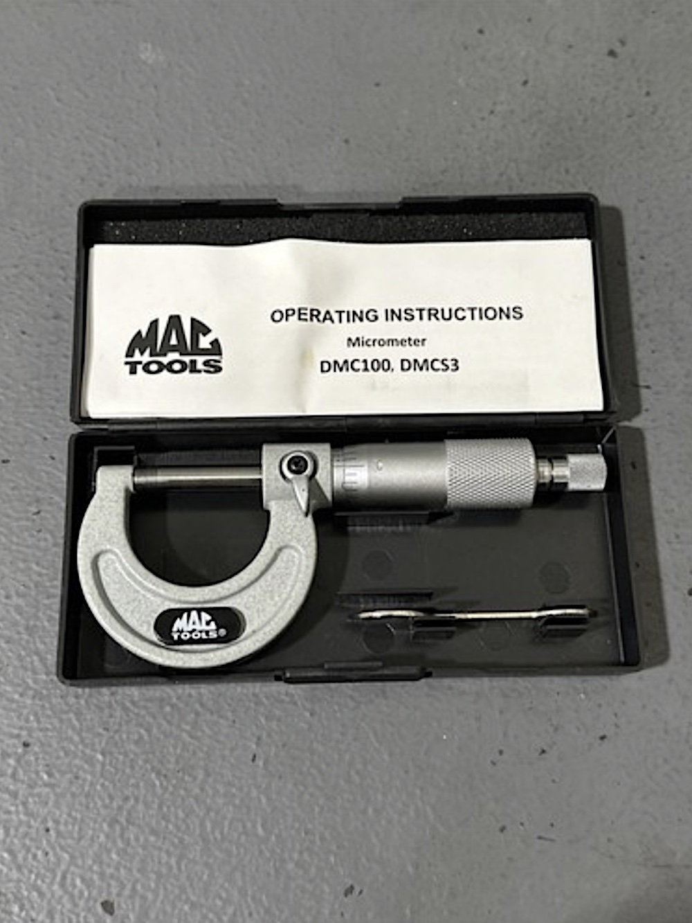

I went to eBay to find a micrometer to measure pads and discs. I found this one from MAC Tools for about $27 USD. The surfaces that contact the thing measured are clean and scratch free, and zero measures to be zero dead on. Everything on it moves smoothly.
It is a used tool, but I have found that eBay can be a decent place find good tools, with the usual caveats, of course. This was $27 USD and change.
