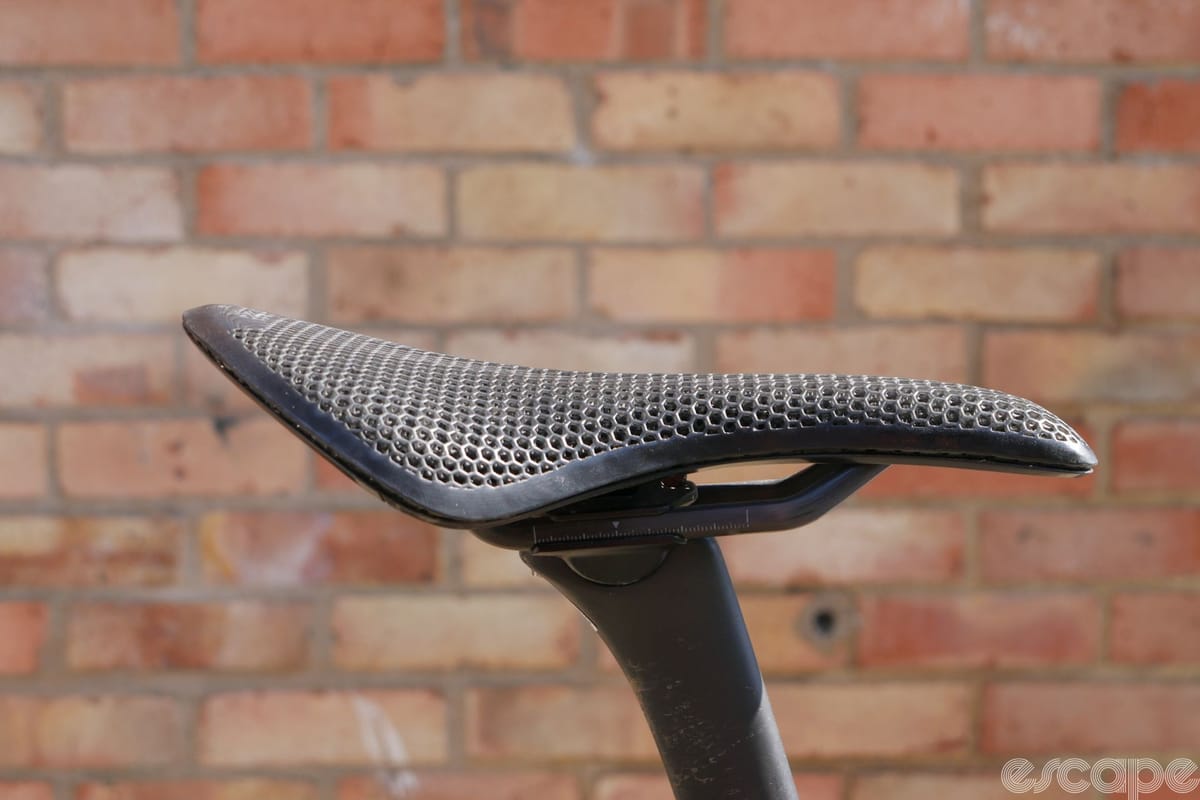

P.S. I was already thinking about a custom 3D printed saddle as a replacement, but this review on Escape Collective seems to show that this will likely just cause the exact same problem:
I suspect you may be able to sand it down - a google search confirms this but with mixed results. Someone else shellac’d theirs too.

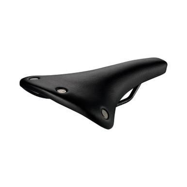

The Regal looks almost the same saddle (but also seems to have the same texture):

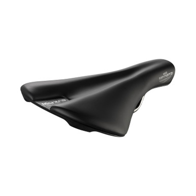

The Mantra looks like a good alternative:
