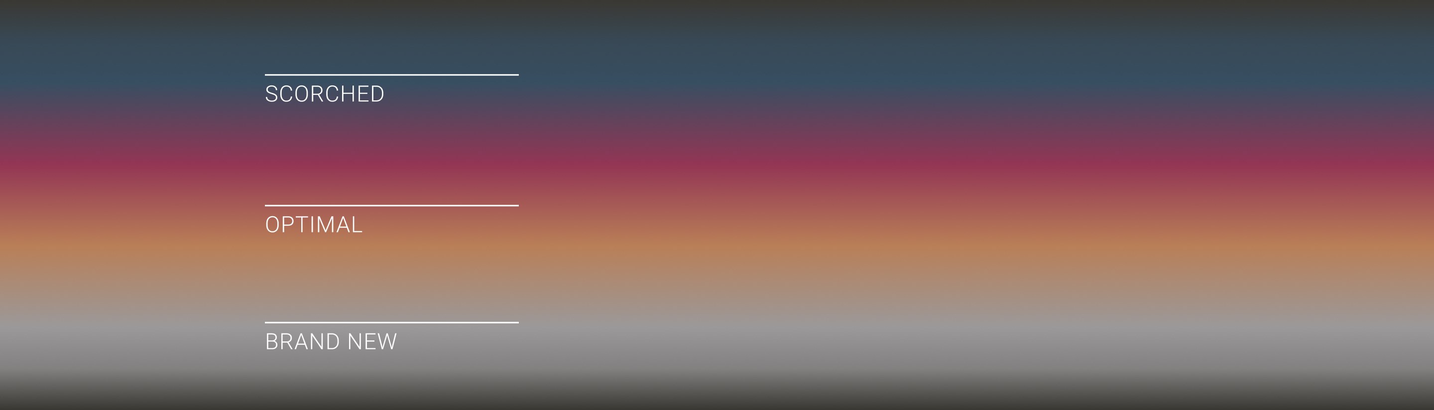

It does look like the front rotor is getting a bit hotter than the rear, rear has the bronze color while the front is more purple but not in the scorched part of the chart yet.
