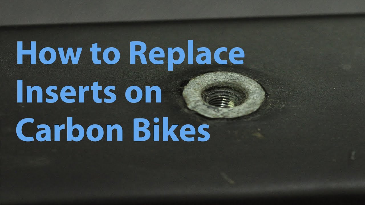

This is typically a straightforward repair. I did a video explaining the process some time ago.
