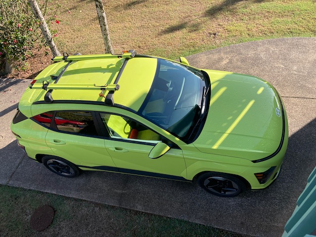

Our new car came with a hitch socket so I have no good excuse not to use it, except I had already matched my new Kuat roof racks to the car’s paint scheme before the car arrived. Who wouldn’t?
Am I in heaven? A rack for my rack!!!
I have 1-Up in 1 tray plus the expansion tray—and I am so copying your invention.
