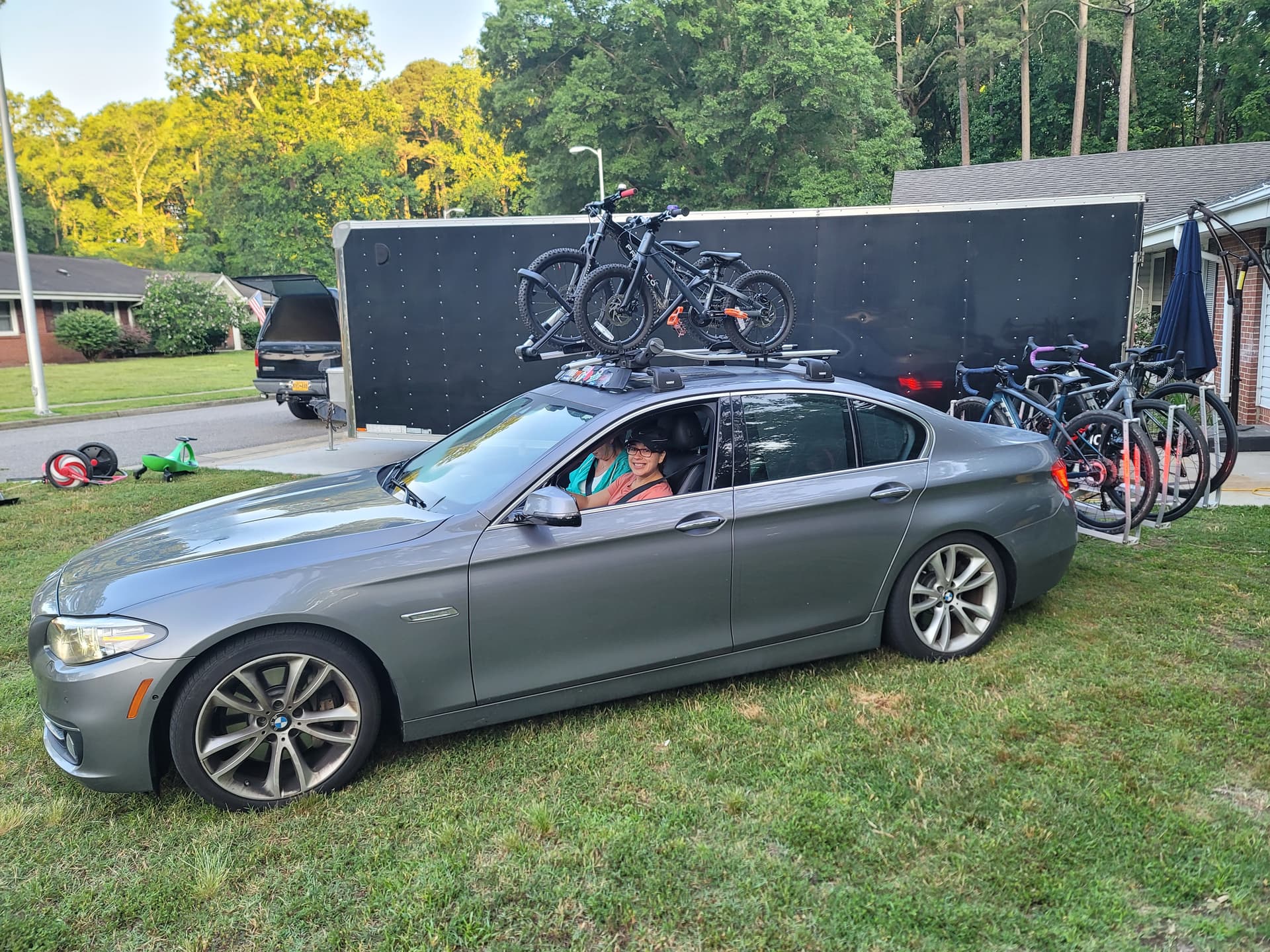

I much prefer the hitch rack. I don’t like putting more than the kids bikes up on the roof. I feel like the full size bikes put way more leverage on the roof racks up there and they move around a lot more than I would like.
I have since retired the roof rack. We now have a single tray 1 up rack and two add-ons. Plus a full vertical style hitch rack (1up recon) for if we are carrying more than 3.
