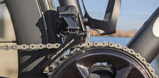

Edit. Here’s a worst case scenario. Sometimes it’s smooth. Sometimes it take one revolution. Sometimes it’s this bad. IMG_5604

How old is your derailleur? Asking because the way the Di2 front mechs should work is that they over shift and then correct themselves. Watching your video it is clear that it moves only a small amount at first then moves the rest of the way to get it up to the big ring.

I agree with Chuck - that shifting behaviour looks odd. My 12 speed (Ultegra) front shifter visibly “overshifts” to complete the shift, then “settles back” once the shift is complete.

The front derailleur’s shifting behavior is dependent on which part of the cassette the chain is on, and also what brand of chainring one is using (due to the difference in relative lateral spacing, Shimano being the widest). The over shift is most noticeable when in the easier gears, as the derailleur cage has to “trim” itself for clearance after the shift has completed. I suspect in the video the OP is in one of the harder gears.
This may be a silly question, but are you sure the derailleur cage is aligned with the chainring? Is the support bolt being utilized?
Also, if this has been happening for an extended period of time, it’s possible that even if the derailleur adjustments are corrected, the damage done to the shifting ramps on the large chainring and to the derailleur’s cage will ensure the symptoms continue.
Not a silly question at all (and honestly I wouldn’t know for sure either way). I just swung by the mechanic on the way home and he lowered the cage a few mm to see if that would help. He also built the bike (and the one before that) and it’s been that way since the beginning.
Never thought of that. I can take close up pics of both later. Not sure it would tell us anything. I always assumed it was the ramps not lining up from the 34t up to the 52t but everyone seems to think it should still shift smoothly or smoother, 100% of the time. Right now I’m at about 1 in the 3 shifts being super clunky.

Front mech adjustment is key, as others have said. Alignment moreso than height: a degree in angle has way more impact than a millimeter in height.
I’d have a look at both the official Shimano manual and Better Shifting guides and see how yours compares.

My mechanic just tweaked the height but not the alignment. By alignment I assume you mean the delrailuer?
Any tips to set up?
Yes, the angle of the mech cage relative to the chainrings. About half way down the page under the*Loosen the fixing screw” subtitle
