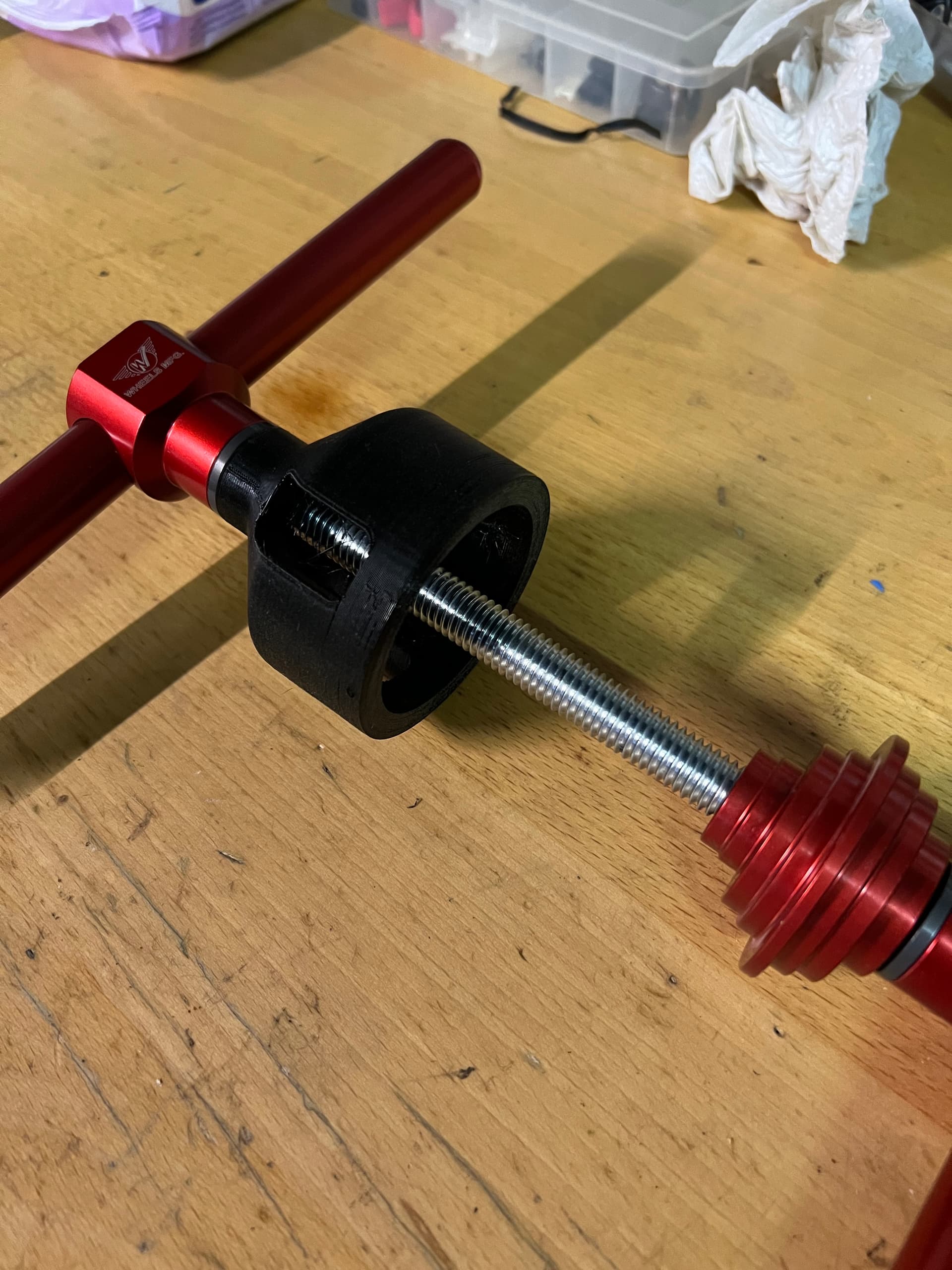

These are great reccomendations! You can 3d print drifts? Is there a design or material that works best to print in?
yes, the ones I’ve printed are mostly over axle drifts but the ones I printed for 18307 bearings are holding up fine after a few uses.
I created the file on Tinkercad and my engineer daughter did the rest. I wanted 100% fill but she said that was overkill. No clue on the material used, it came with the 3d Printer a friend gifted me.
I am very happy with my alt alt set.
After 3d printing some larger centering pucks, I was able to press in a BB just fine with it.

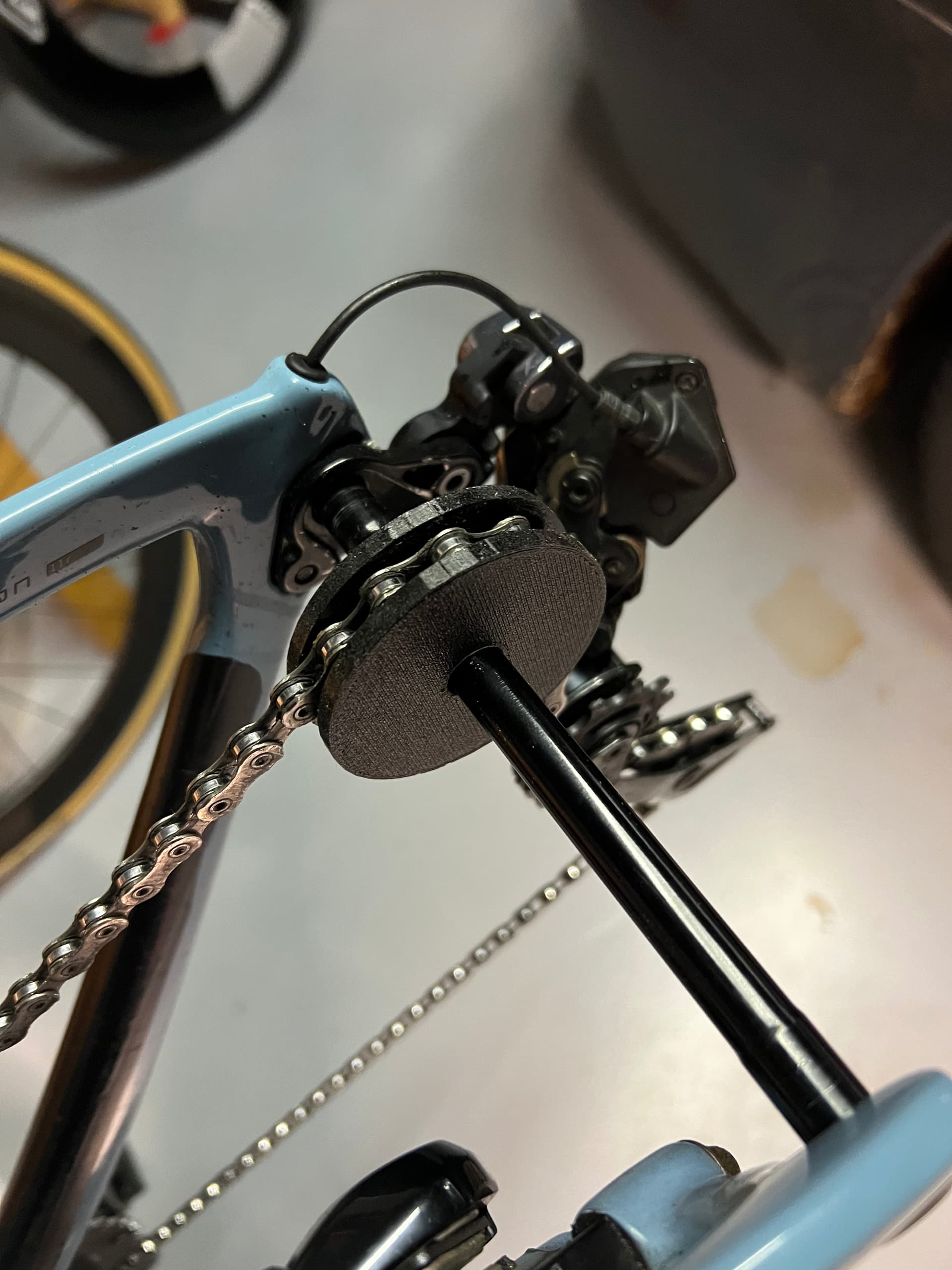

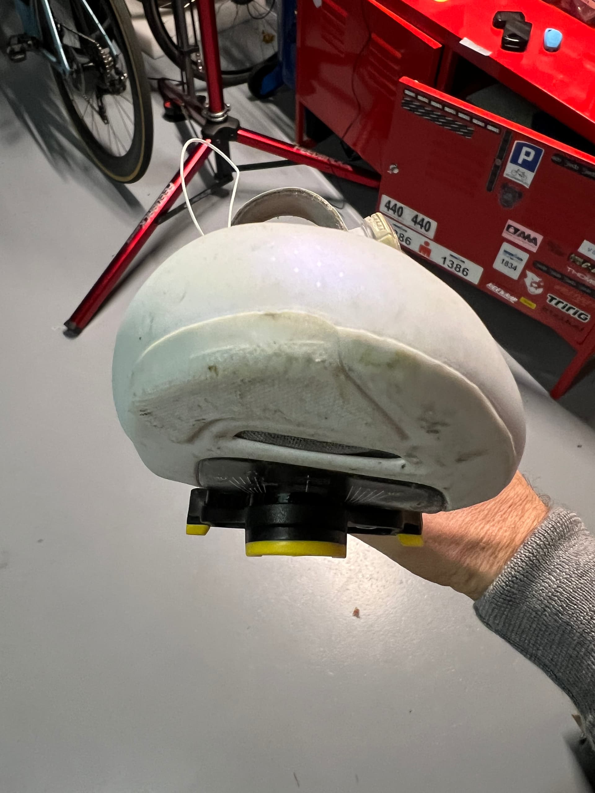

You can make all sorts of things with a 3d printer. Press out cups with windows, cleat wedges, chain rollers, are all easy projects after building a set of drifts.
