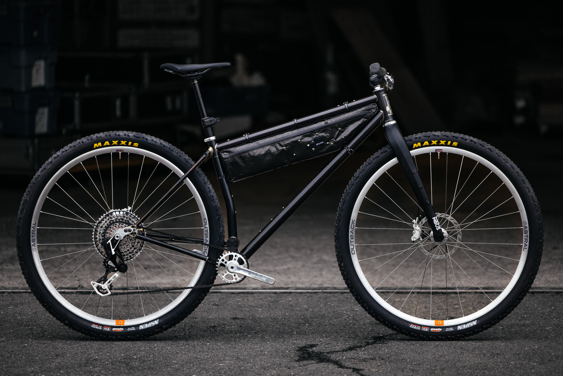

I too have been looking for the Ideal 32” Gravel Fork. The current best and shortest option that fits 32” tires is the Columbus Futura Adventure (MTB) Fork at 470mm Axle to Crown. There are some good images of 32” with this fork in The Radavist Bespoked Coverage.

The only 32” tire worth getting at the moment is the Maxxis Aspen 32x2.4 and it’ll clear that.
I would strongly urge you to design a bike for that tire. I haven’t heard comment or even rumors of 32” gravel tires from any tire brands.
