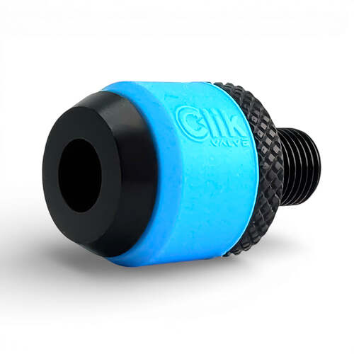

The Clik pump head adapter threads straight into the Prestaflator inflator.

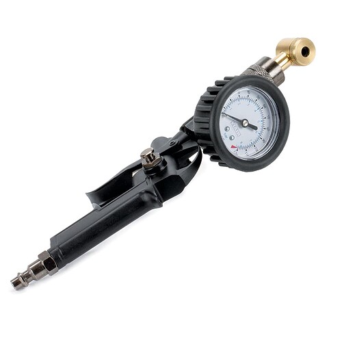

I would second the Prestacycle inflator with the Clik adapter screwed in…works a treat!
Which one did you use?
or
or
Thanks.
The last one is what I had in mind. They do a digital version, too.

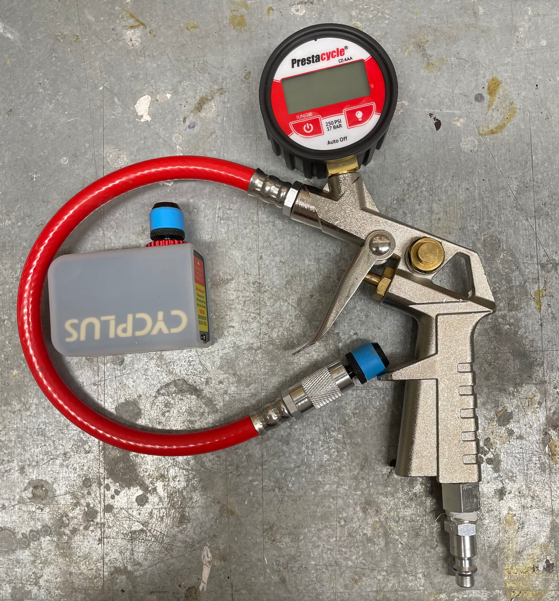

Yes, the last one (with the trigger), with the digital gauge. You can screw the Clik adapter right into it and it’s magical! The digital gauge has increments of 0.1 psi, and it has a bleed valve. So I just pop the Clik cap off, push the Clik adapter on, pull the trigger, the bleed it down to the exact pressure I want. It’s the easiest thing in the world! 10/10 would recommend. You don’t need the Pro Presta head, that’s for presta (but it is a nice pump head for presta).

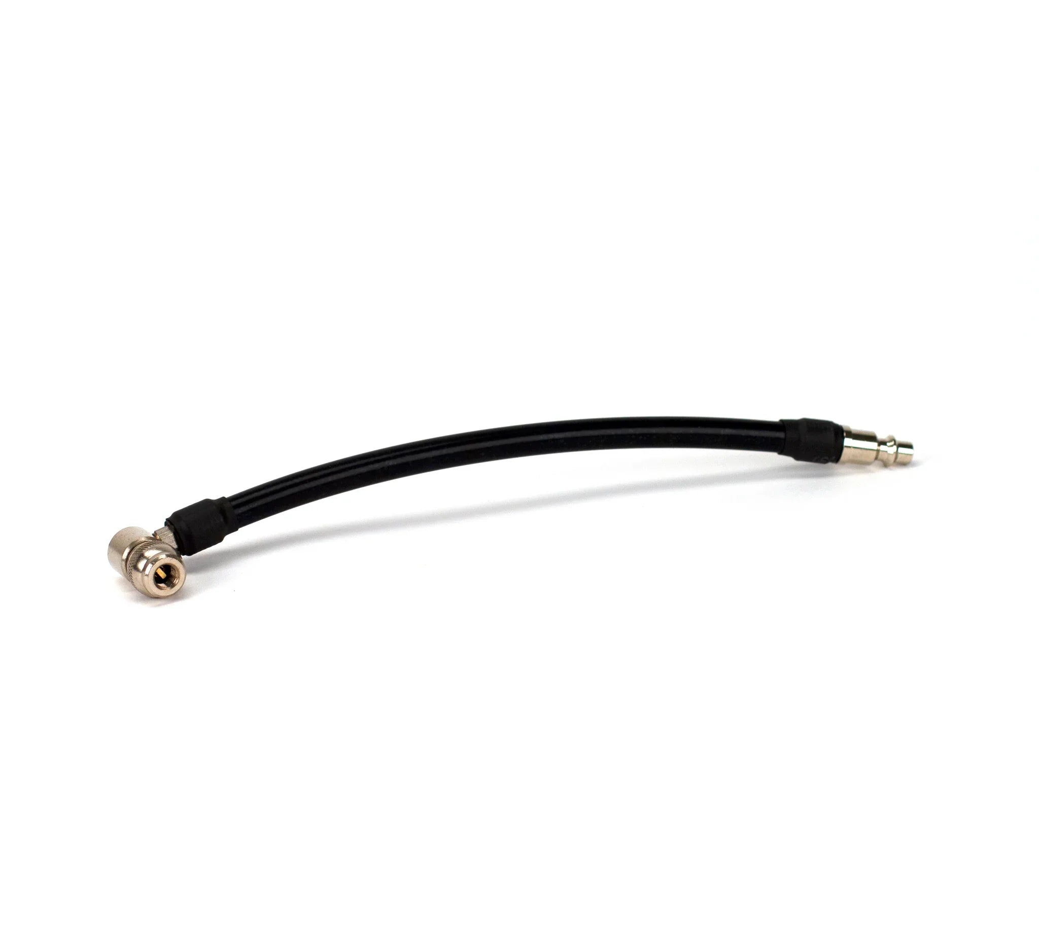

So I ordered the Prestacycle Pro inflator… and I also ordered a ViAir TLC inflator with their schrader attachment.
The ViAir arrived first and the Clik Schrader chuck works perfectly with their attachment. I have converted everything to Clik now and I’m done with Presta. The biggest issue I had of late was the threads on TPU valve stems destroying the gasket in my EVT presta inflator. I was a tubular user until six months ago and would go a year or three between gasket replacements, thanks to the smooth valve stems.
With a Clik setup, the chuck requires such a minimal length of contact that any valve stem threads are no issue.
I got the analog Clik gauge from Clik and it matches up pretty well with the gauge on the ViAir TLC inflator. I’ll still get the Clik digital gauge when it’s available but I’m set for now.
Thanks for the helpful advice, folks.

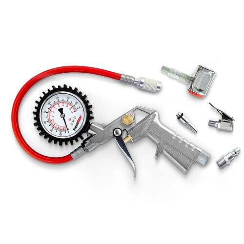

I thought I’d post an update now that I have the Prestaflate Pro inflator.
Well, the Prestaflate is disappointing. It feels cheap. The plunger on the trigger is very sticky and the trigger pull is not at all smooth. And, to top it off, the gauge wasn’t attached to the gun terribly well, since it leaked quite a bit of air when the head was attached to the valve and under pressure. Not at all impressed.
By comparison, the ViAir TLC inflator feels a whole lot better and of much higher quality. It’s the clear winner. Sure, it only has an analog gauge, but I have always used a hand-held gauge to check my tire pressure and will continue to do that with Clik valves. The analog gauge from Clik Valve works really well and there’s very little air loss when disengaging it.
What Schrader chuck are you using with the Viair TLC? I have the same inflator and trying to figure out the best way to convert it.
I’m using Viair’s own Schrader hose, and screwing a Clik head into it. It’s works perfectly.
