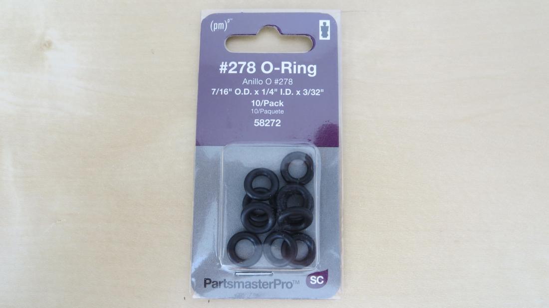

I had this issue as well. The original rubber O-rings that are on the cable couplers are a little too small to provide sufficient “bumperness” (LOL) against the frame, or they degrade like Iain noted. I ended up going to the hardware store (look in the plumbing section) and finding a thicker O-ring that provided better protection and it essentially eliminated the frame/coupler slapping. I do have the clear plastic frame protector stickers on the frame as well, but that does little to dampen any noise.
The O-ring size that worked for me (sorry, freedom units here in the USA):

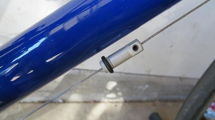

New O-ring installed (rear brake cable, under top tube):

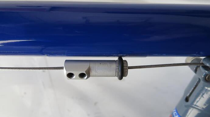

New O-ring installed (derailleur cable, downtube):
The new, larger O-rings are in the grooves designed for the original ones, but I suppose you could also roll one onto the other half of the coupler to provide additional protection from that larger metal part hitting the frame.

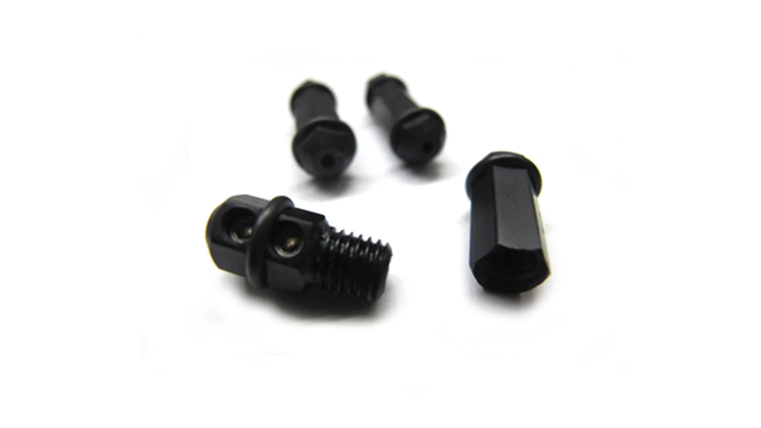

I have a strong preference for The DaVinci cable splitters over the Ritchey brand.
They use double bolts for both the shift and brake cables, whereas Ritchey only uses them for the brake cable. Plus, they come with double o-rings by default, instead of the single o-ring of Ritchey.
