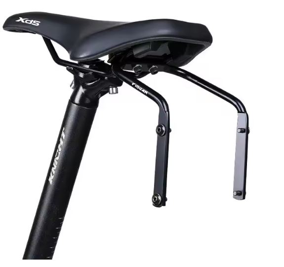

You can buy a Topeak Wishbone to stop the swaying. It’s a metal frame you bolt onto the saddle rails that fits around the bag. Designed for the Topeak Backloader, but my Apidura bag fits as well. Added bonus: you can add bottle cages to the side of the wishbone for extra hydration or storage.

I recently purchased a seatpack stabilizer on Ali and found the experience to be much better, I’d say it’s a total must have if you purchase one of those bags.

Or use an anti-sway device, they’re like 25 euro/dollar
