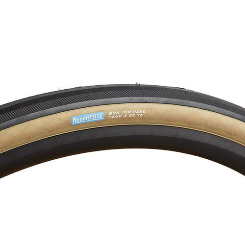

Not sure if this would be a good fit?
I did look at these but the extra light casing version is almost £100 a tire!
