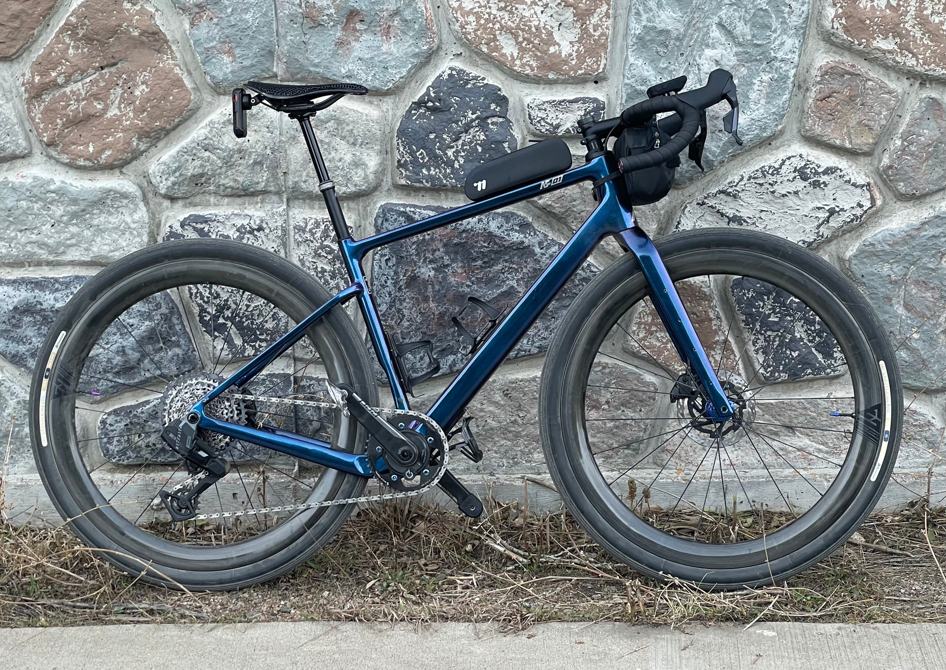

I’m considering (nothing urgent nor firmly decided) adding a dropper post to my seldom-used Canyon Grizl (the previous one with external routing at the headset). The leaf-spring Canyon seat post is very comfortable, but I really feel too high on steep descents. The bike is 1x so the routing port for the front derailleur at the top of the downtube is available to route the dropper’s cable internally.
What would be a no-nonsense, easy to use / maintain and not-too-expensive 27,2 option ?
