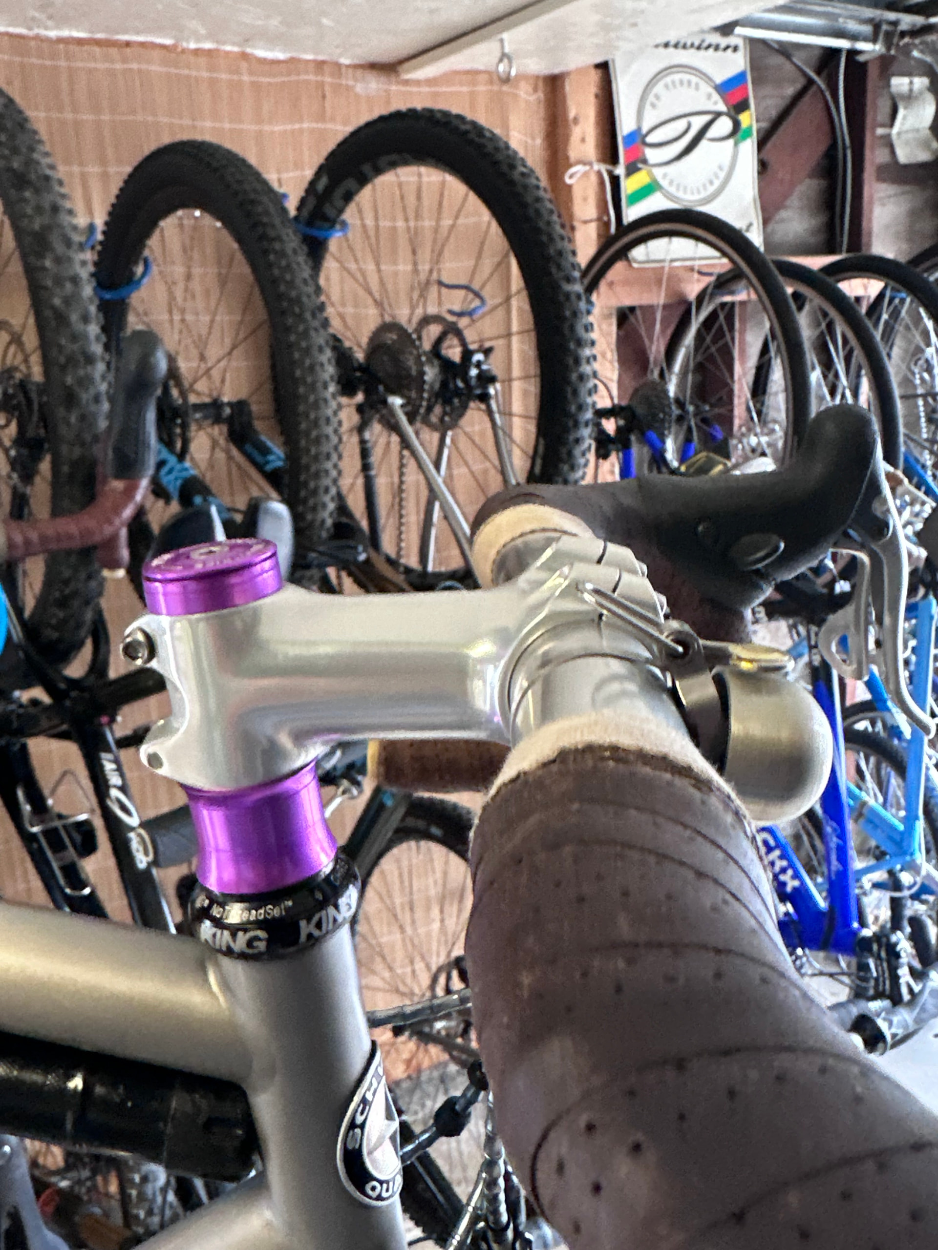

Techies: I replaced the fork on my 2000 Paramount Ti with a Ritchey WCS carbon with aluminum steerer to add a wider tire. Ritchey allows only 90mm above the headset, so I kept to this length including the stem so I can move the stem up or down, and slide in a K-Edge head unit holder in the stack.
The Ritchey stem arrived with a spacer to fit a 1” steerer, so I decided to stack two of these spacers for the length of the exposed steerer, and then use 1 1/8” spacers to fill the space below and above the stem. The two spacers meet at the middle point of the stem clamp.
Question: is this potentially dangerous? Am I putting undue stress on the steerer?

I’d put the oversize spacers above the stem. Once it’s clamped they’re basically for show only.
Hey Scott: they’re all 1 1/8th, but the two on the bottome have a flair that cover the headset top and flow into the base of the stem.
If they’re all the correct inner diameter then it doesn’t matter. Provided they sit flush on the top of the bearing top and stem bottom.
Looks like there is a gap between the top cap and the top spacer. Is it recessing correctly/possibly bottomed out on the steerer or compression plug?
Hi Babs,
The two stacked spacers sitting on the steer tube sit 2mm above the top of the uppermost spacer. The compression plug/steerer plug has plenty of thread left to tighten the whole stack. That added 2mm allows me to run a K-edge head unit mount that acts as a spacer.

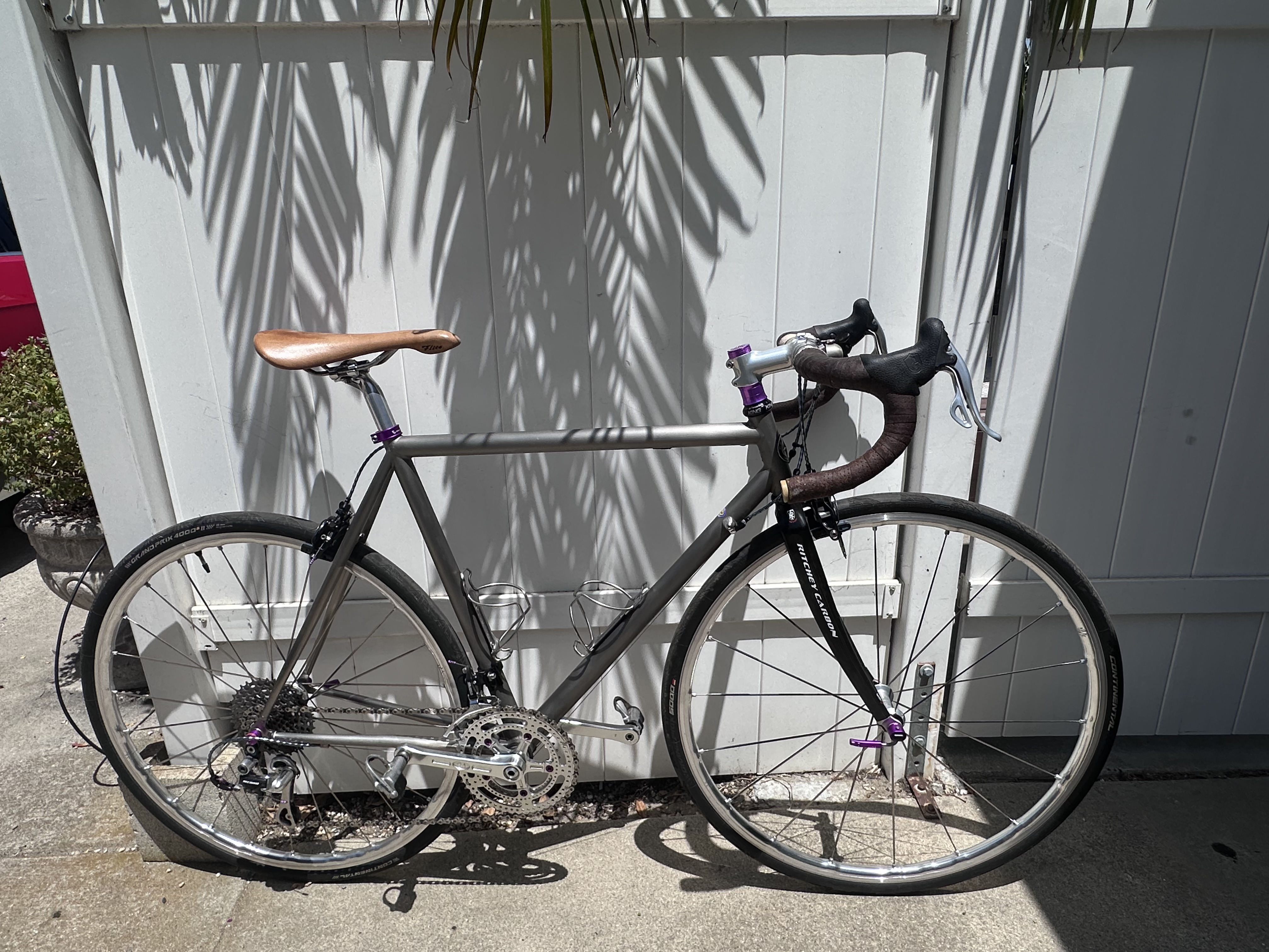

As the original product manager for those bikes, I need to see a full-bike pic, please!!
Did you have the frame stripped down to bare Ti at some point?
VeloBouf! What an awesome project you shepharded through.

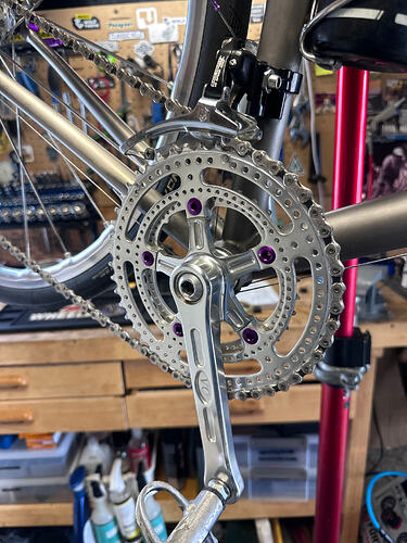

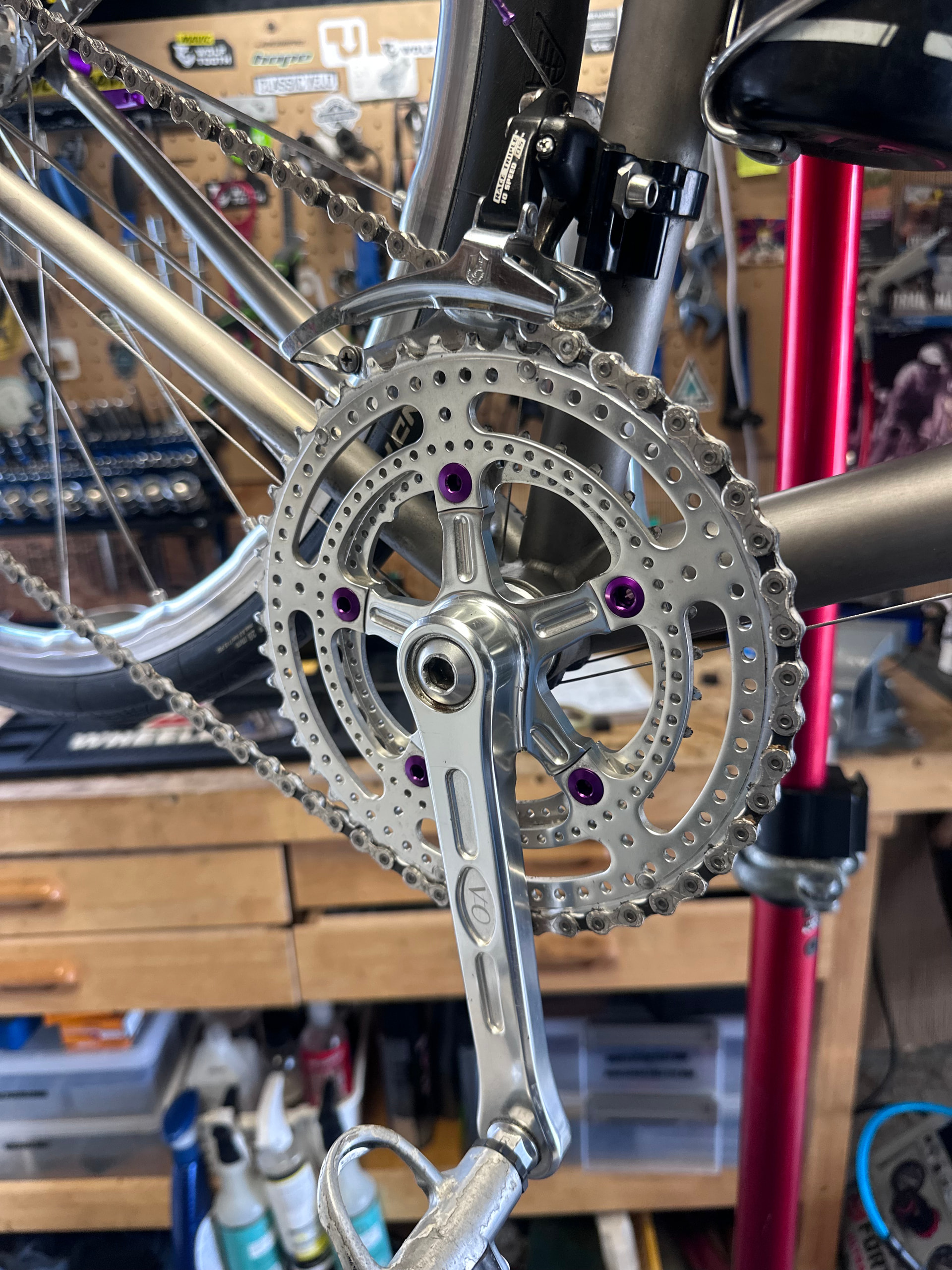

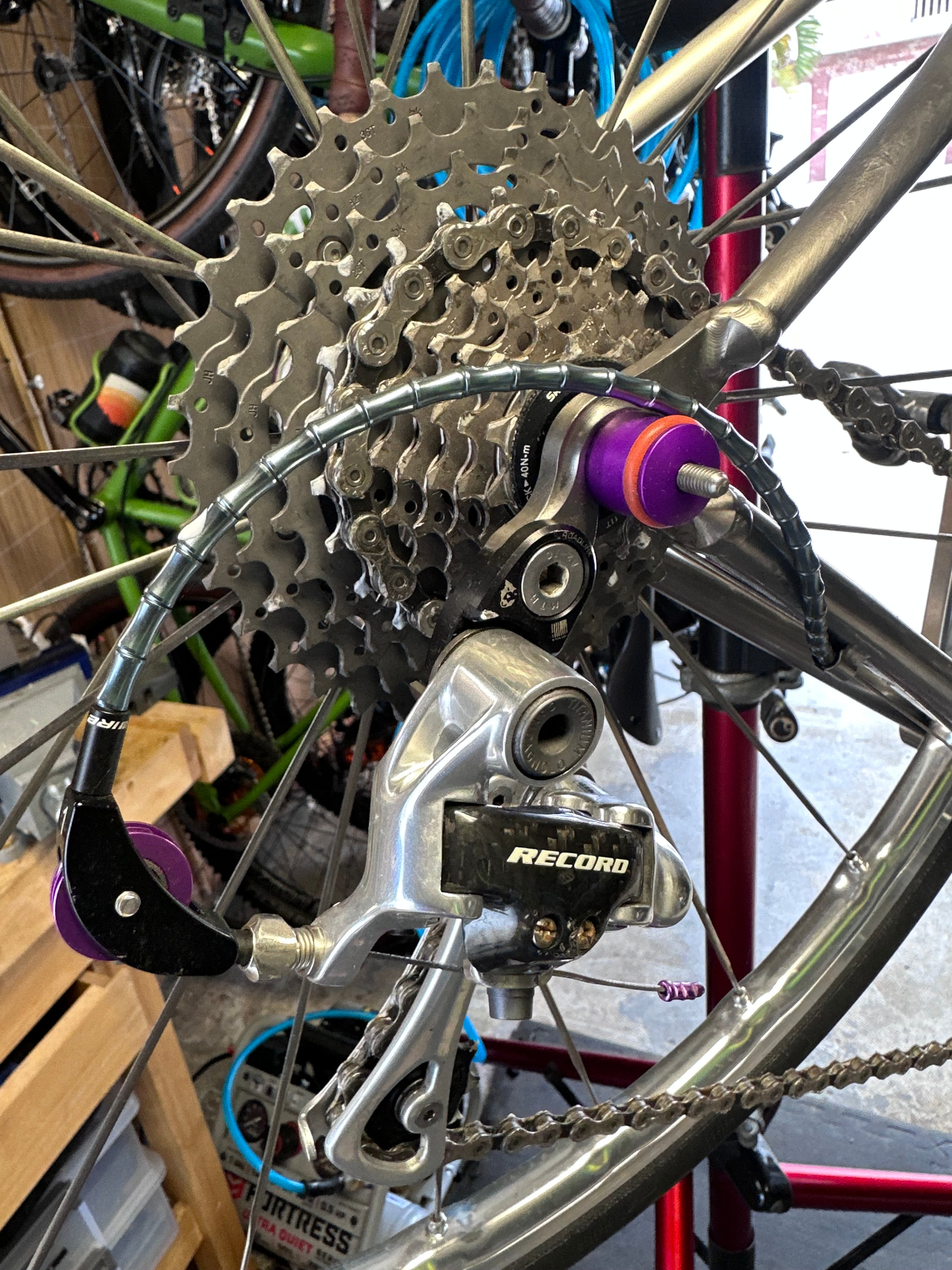

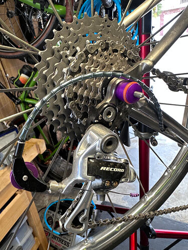

I bought the frameset n 2000, and built it with Campy 10 speed and Mavic Ksyrium wheels (frame and wheels red). Fifteen years later, I transfered the parts to a carbo Merckx and made the bike a 2x2: Eno White Industries rear hub and double 70’s Campagnolo cranks. This is when I stripped the frameset. I decided to make her a lightweight tourer: more tire clearance, bigger cassette, and silver instead of black for the running gear and cockpit, and using the aforementioned stem and spacer stack (instead of a quill stem) for more options in terms of reach and stack.
