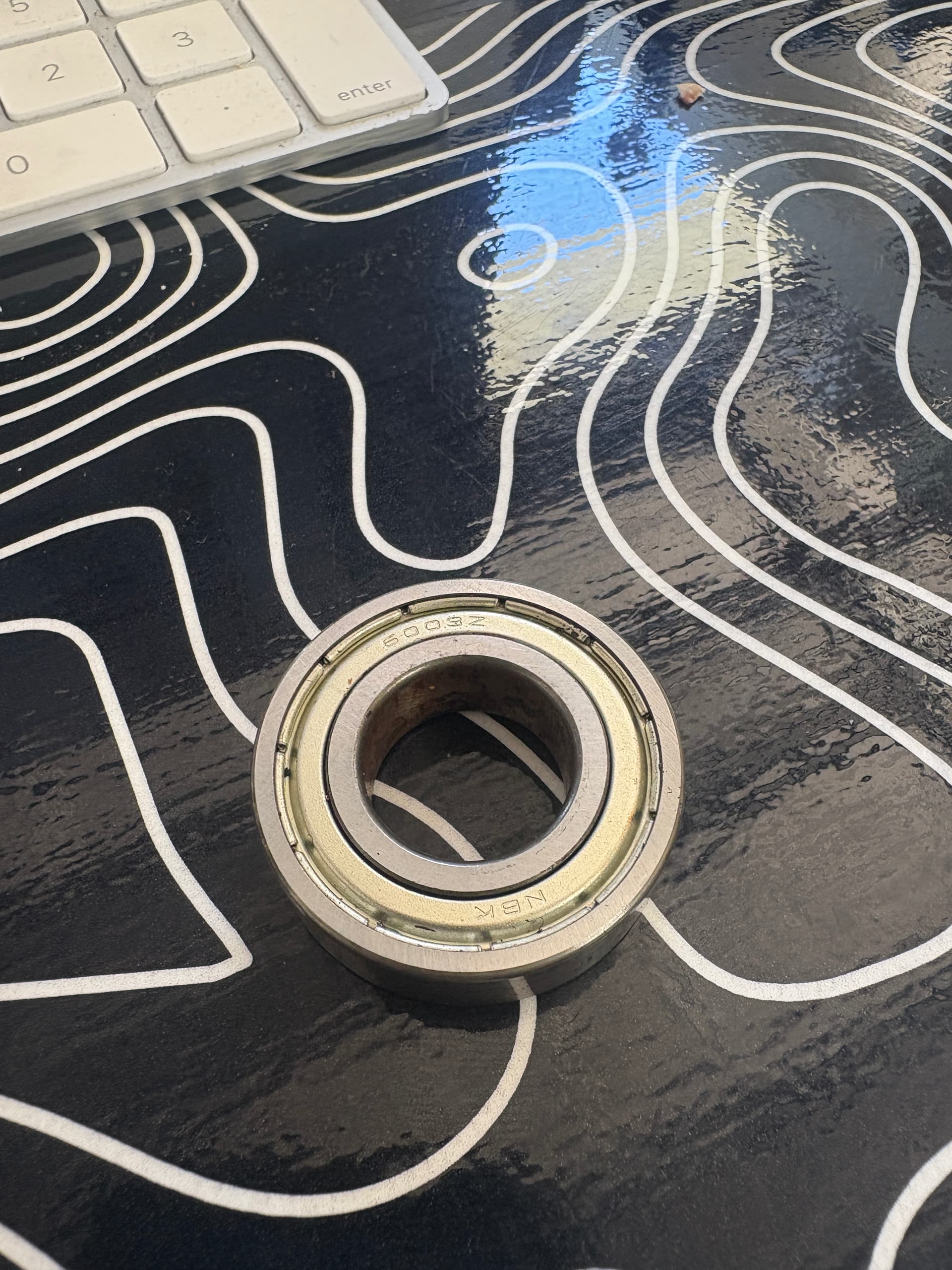

It could be that the flywheel bearings are going. This can happen. When you turn the flywheel by hand, do you get the sensation of rough bearings?
If it is the bearings, then in principle they can be replaced. There’s vids on YouTube about how to disassemble the trainer enough to access the bearings. I don’t know if every store has the right tooling to extract the bearings, however.
It’s actually pretty easy to do, and the bearings are pretty big & robust so a Heath Robinson approach to getting them off and putting them back on is unlikely to harm them. There’s 4 in total, but you might get away with only replacing 2 of them.
If I recall, this is the bearing - 6003Z:
