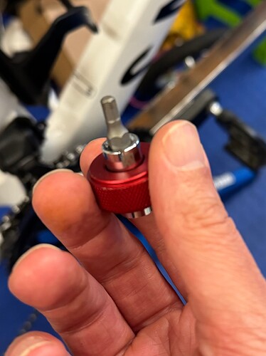

Here’s a thread all about those workshop tools that are just the best ever at one specific thing. I used to hate bottle cage bolts in some bottle cages. Just no way to reliably get something in there to run the threads of the bolts and I was always fiddling with hex keys that didn’t quite fit. THat was until I came across this little beaut:
What a splendid little device for getting the bolts in/out of your frame.
Lets hear what your champion tools are.
(Oh, and if someone can tell me what that tool is called I’d be grateful)
Ratchet spinner.
Finger grip driver.

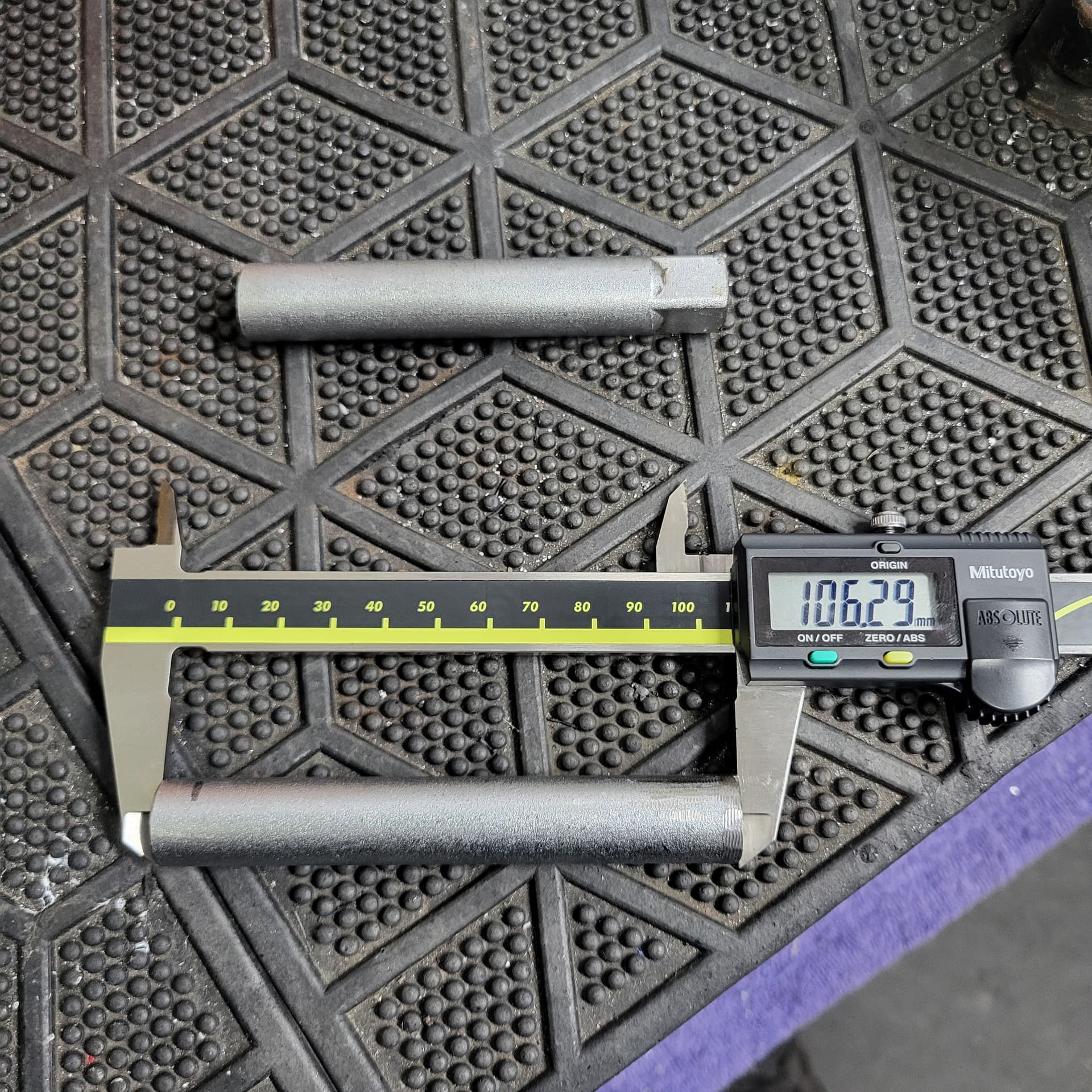

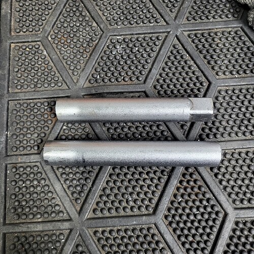

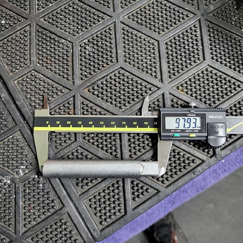

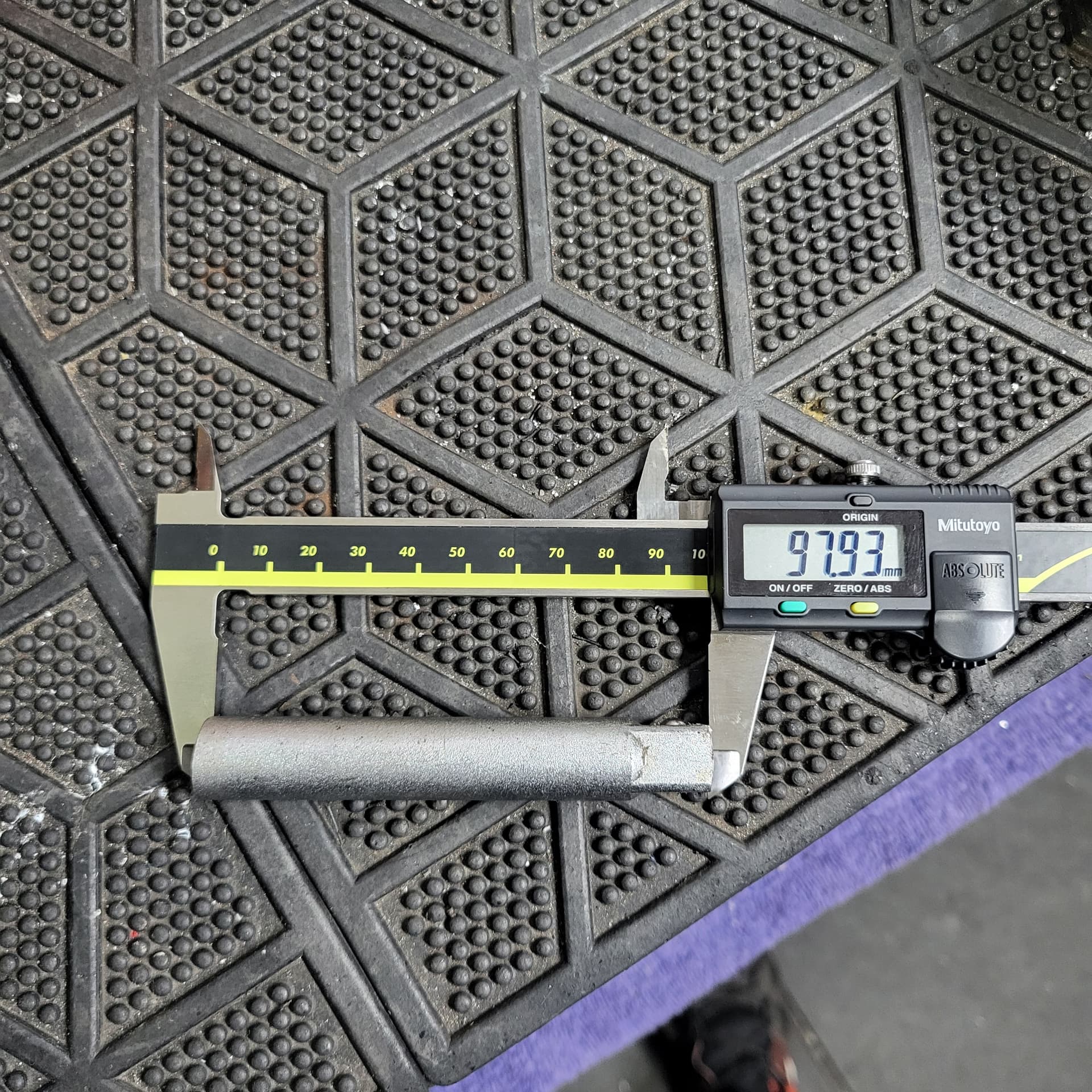

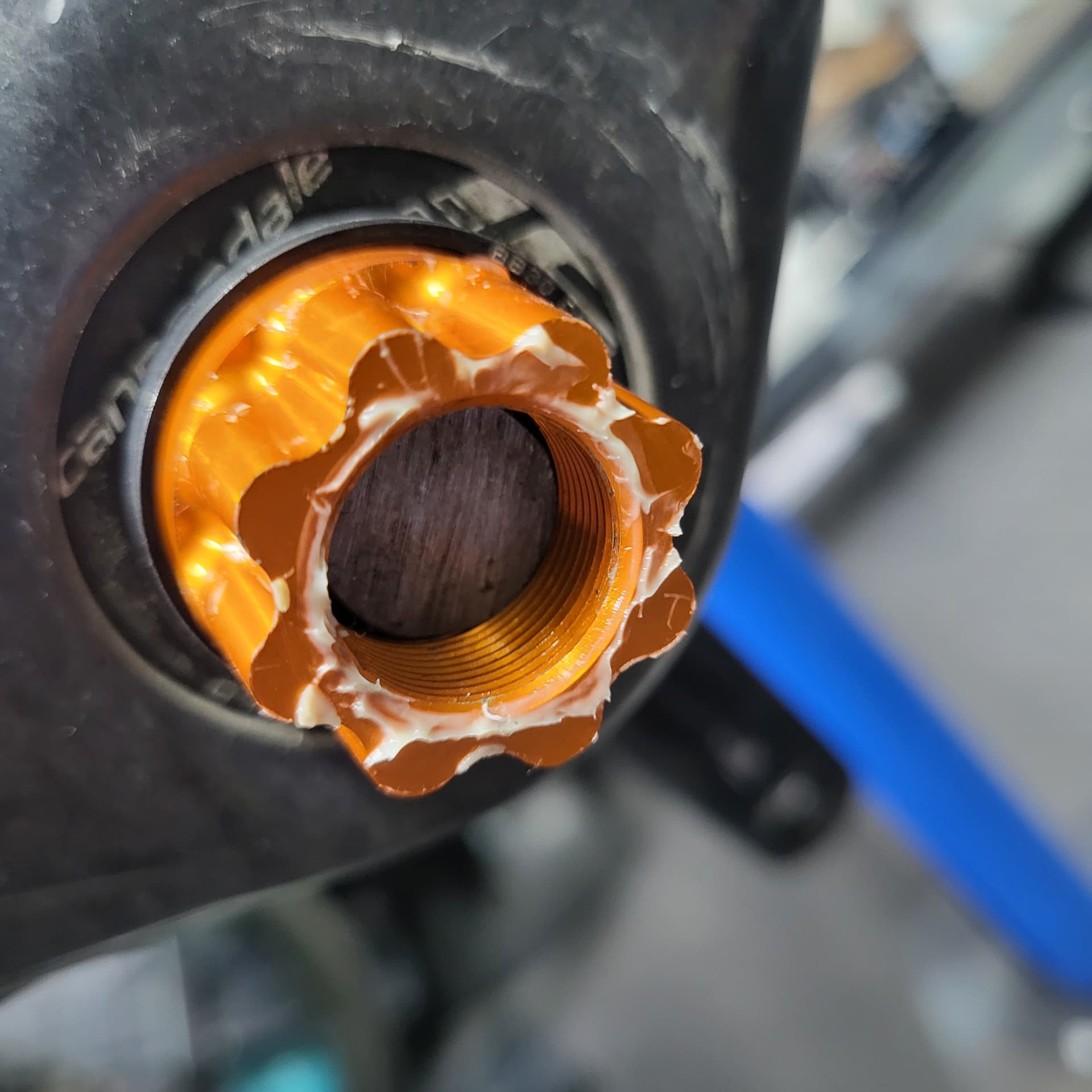

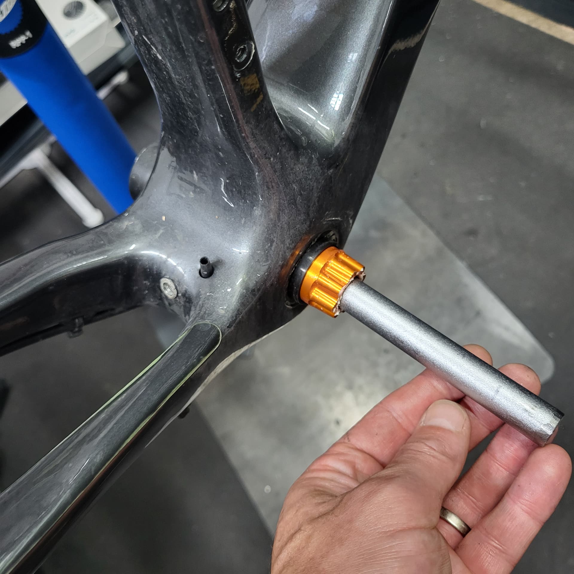

A 1/2” socket extension, cut into pieces roughly 106mm and 98mm long. Insert into a Cannondale hollowtech crank axle (after removing the retaining crank bolt) so you can use any standard crank puller, like the Park Tool CWP-7, to remove Cannondale cranks.
The two lengths are needed for the difference width axles.
